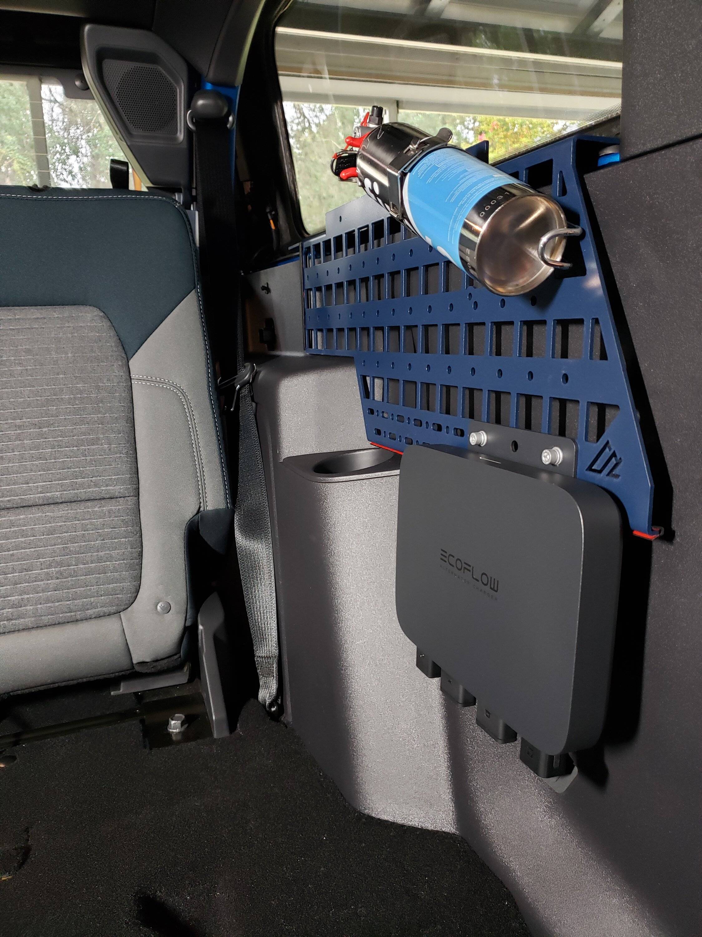

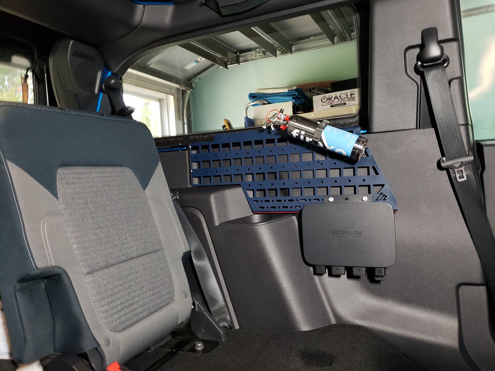

Wanted to provide feedback and tips on AAL's 2-Door Side MOLLE Panels. I purchased these for the main purpose of mounting my EcoFlow 800w alternator charger. The design allowed for the charger to mount low and out of sight from a passerby.
Ford Bronco American Adventure Lab 2-Door Side MOLLE Panels 20240909_090611
I ordered the aluminum panels unfinished for a quicker delivery. They do offer the industry standard textured black powder coat. And you can also get any color offered from the Prismatic Powders catalog. For the size of the of the panels, I didn't feel the up-charge was worth it. So instead I opted for a simple rattle-can treatment. The color is much darker than the photos as I had to provide supplemental lighting to illuminate the dark rear seat area. I chose Rust-Oleum 2X Satin Midnight Blue as it was the closest that matched the Luna interior option on the OBX. $6 vs. $25 for the textured black powder coat.
In the above photo, you'll notice a red line seam. It is the tape covering the adhesive of the rubber u-channel trim. I added this to prevent any rubbing against the interior plastic trim. Because I opted to spray paint the panels, they may require touch-up in the future. I didn't want the hassle of removing adhesive. The u-channel fits snug without removing the tape so it will easily be removed/added if repainting is necessary.
Ford Bronco American Adventure Lab 2-Door Side MOLLE Panels 1726101476699-r3
American Adventure Lab does offer a veteran's discount so if you qualify be sure to go through their verification for a unique discount code. The discount will offset their inflated shipping cost. NOTE: The panels also come with a "cap" panel that fits in the windowsill. I chose to not install them, but they are pictured on their website.

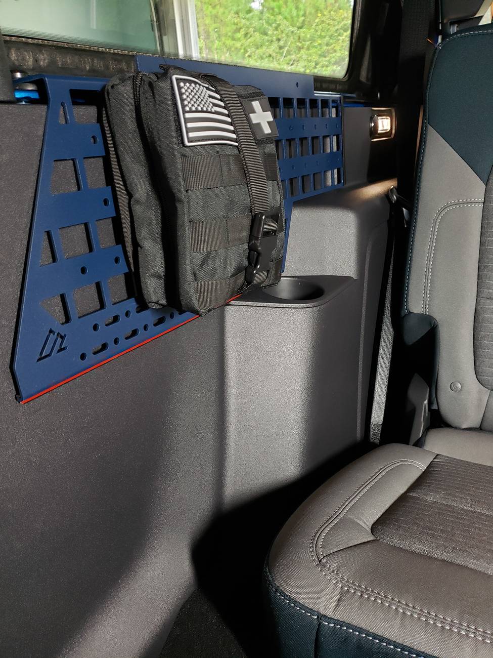

More pictures:
Ford Bronco American Adventure Lab 2-Door Side MOLLE Panels 20240909_090509
Ford Bronco American Adventure Lab 2-Door Side MOLLE Panels 20240909_090800
Ford Bronco American Adventure Lab 2-Door Side MOLLE Panels 20240909_090835

Man, those are some marketing-grade pictures. Paint job looks great too
They did set the bar pretty low with the photos they took and have on their website.
It wasn't my intention of promoting the panels for the benefit of AAL. But rather to let other 2-dr owners of an option that isn't often mentioned. I did post in the monolithic mega-What Did You Do To Your Bronco Today- thread. But figured it was best to have a separate post/thread in the Interior Modifications sub-forum where more information was made available.

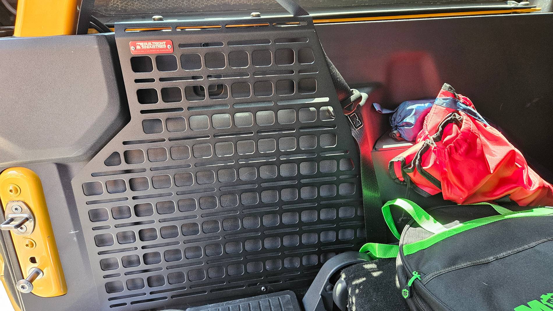

Those look nice! I have these in my 2 door. They sit further back, closer to the tail gate.

I'd like to see if the two will work together. Fitment against the side interior plastic panel doesn't look to be a problem as the AAL side panel fits snug and conforms to the molding. But the windowsill fitment might be tight.
Edit: Also are the Built Right Industries panel steel or aluminum?
