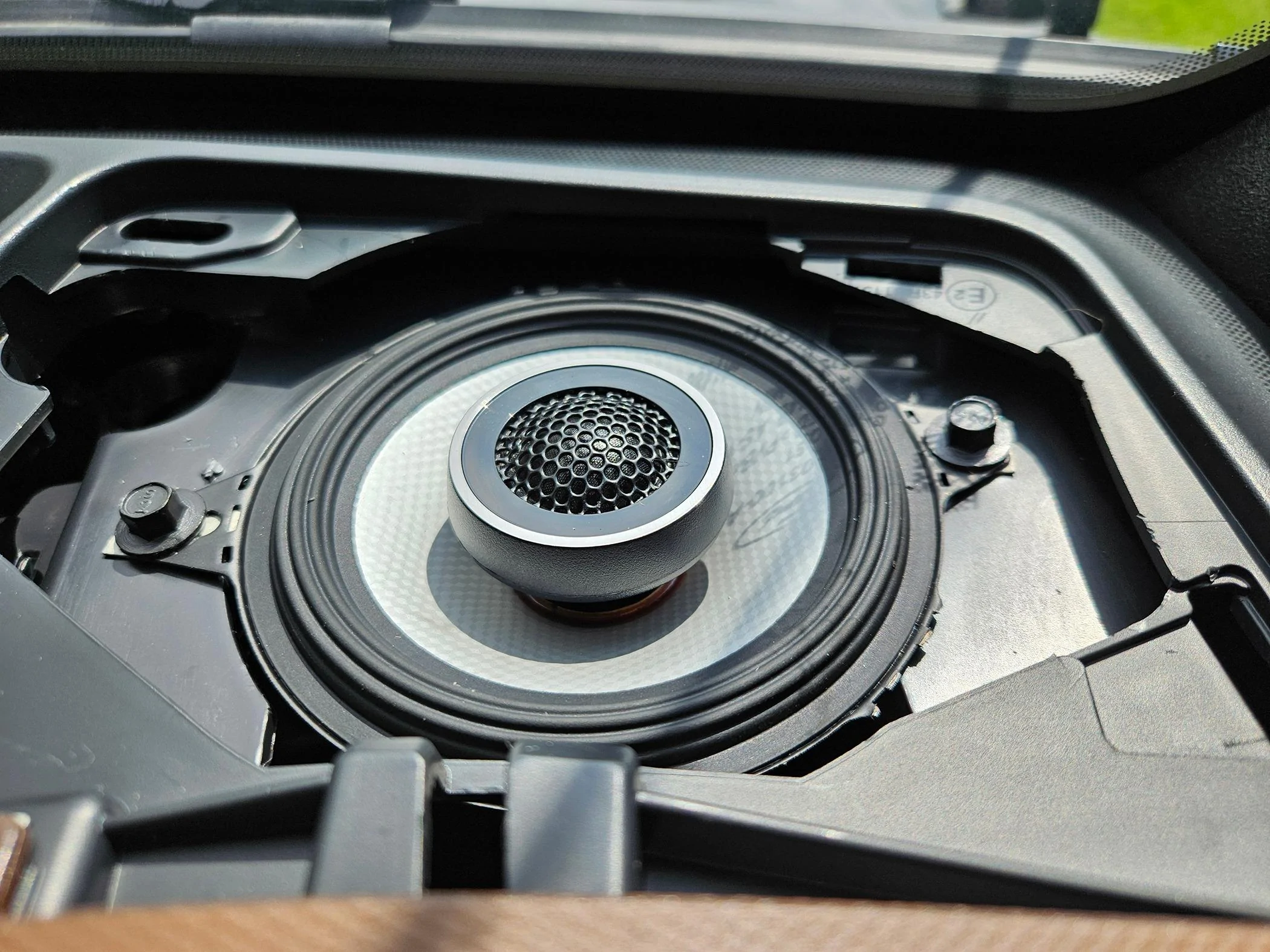

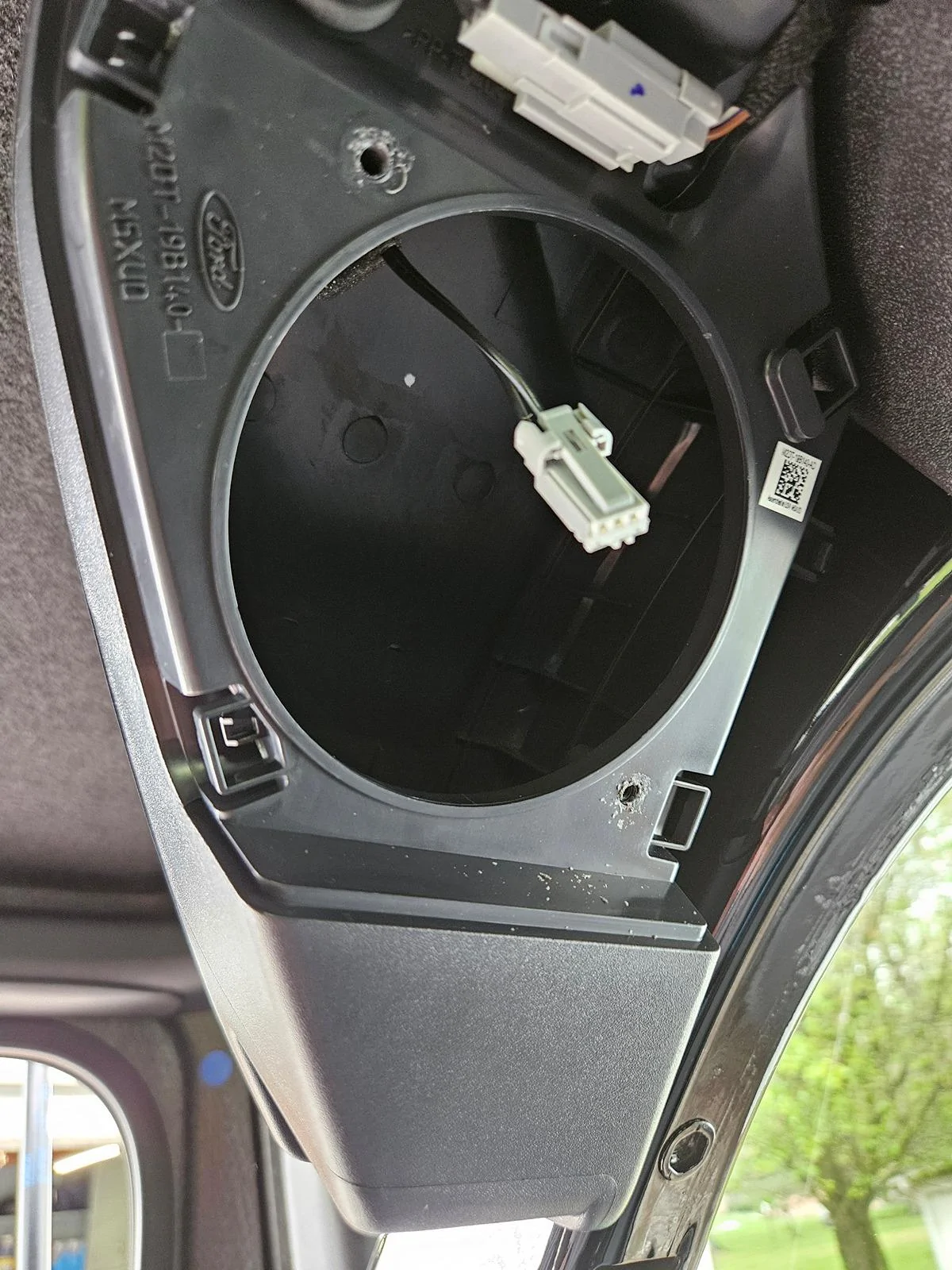

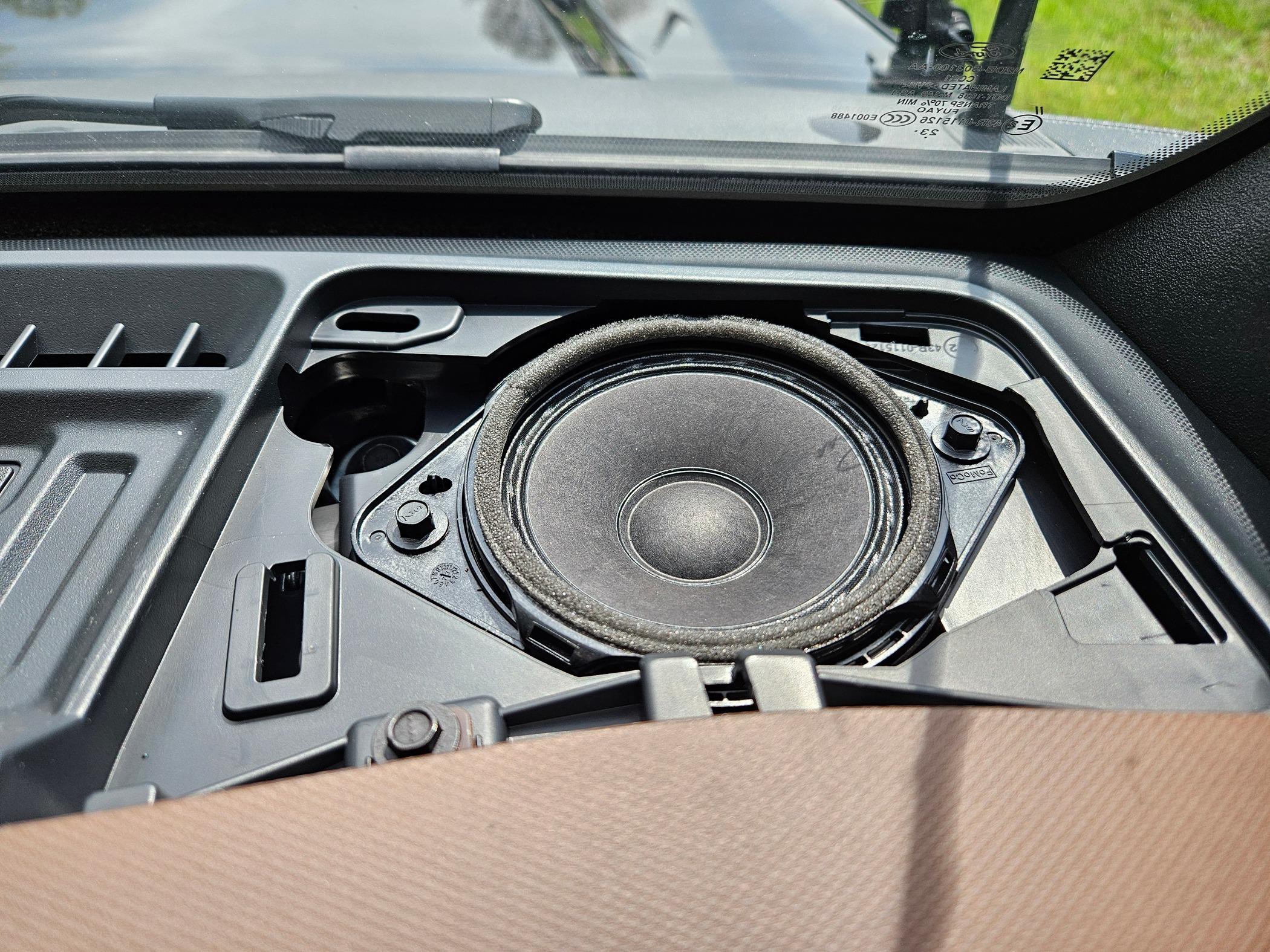

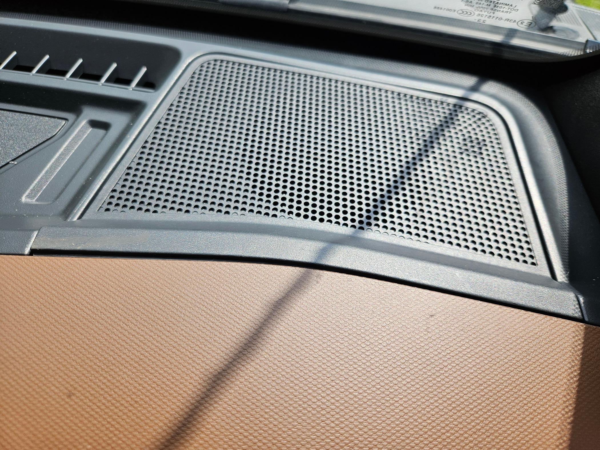

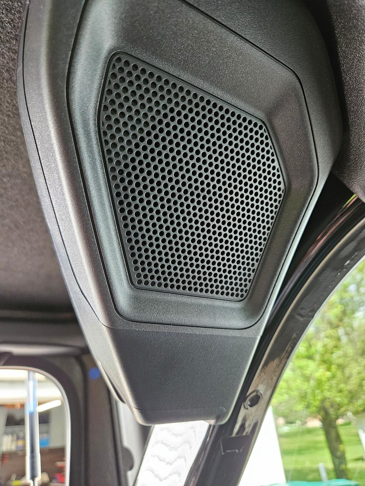

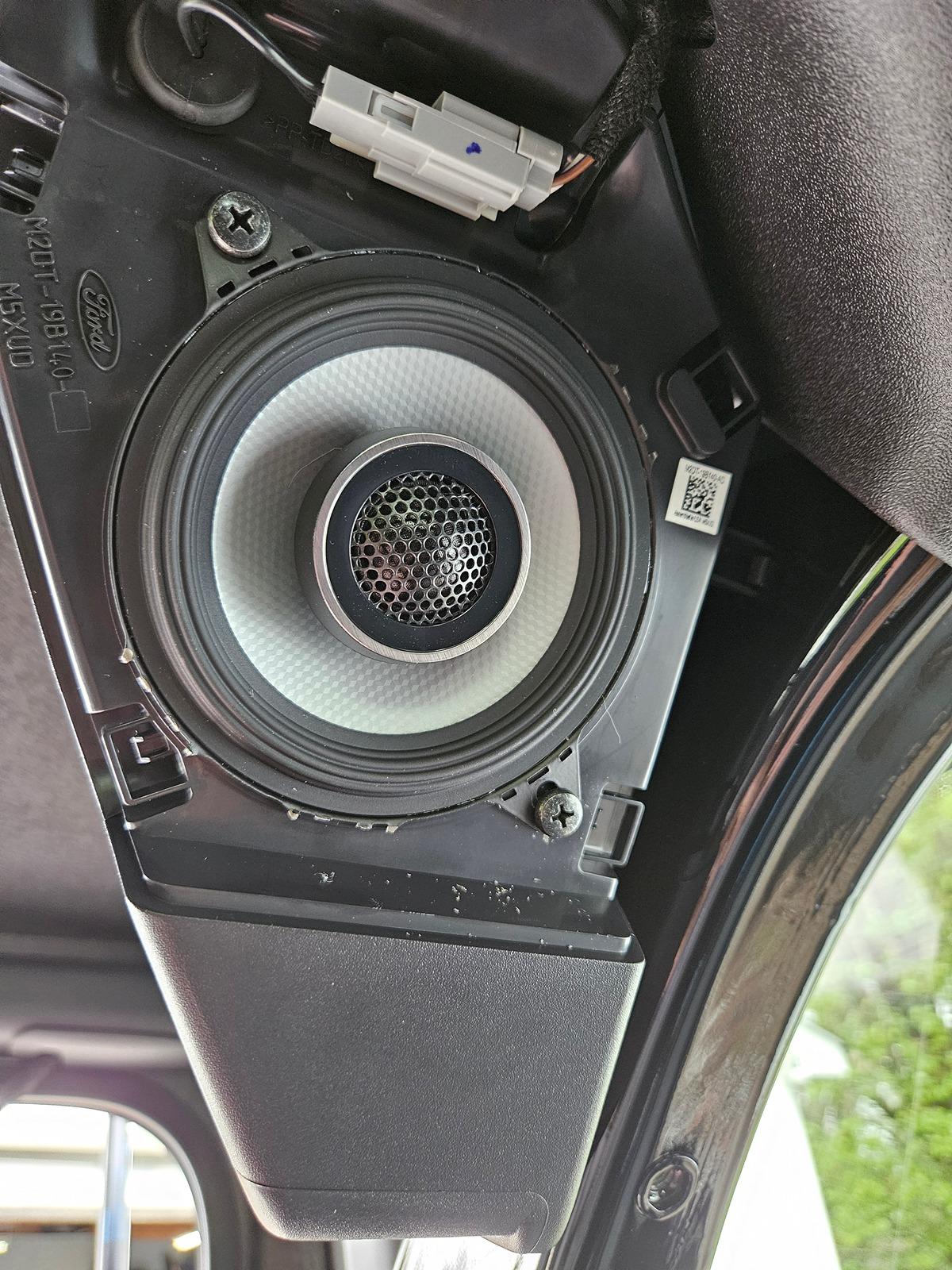

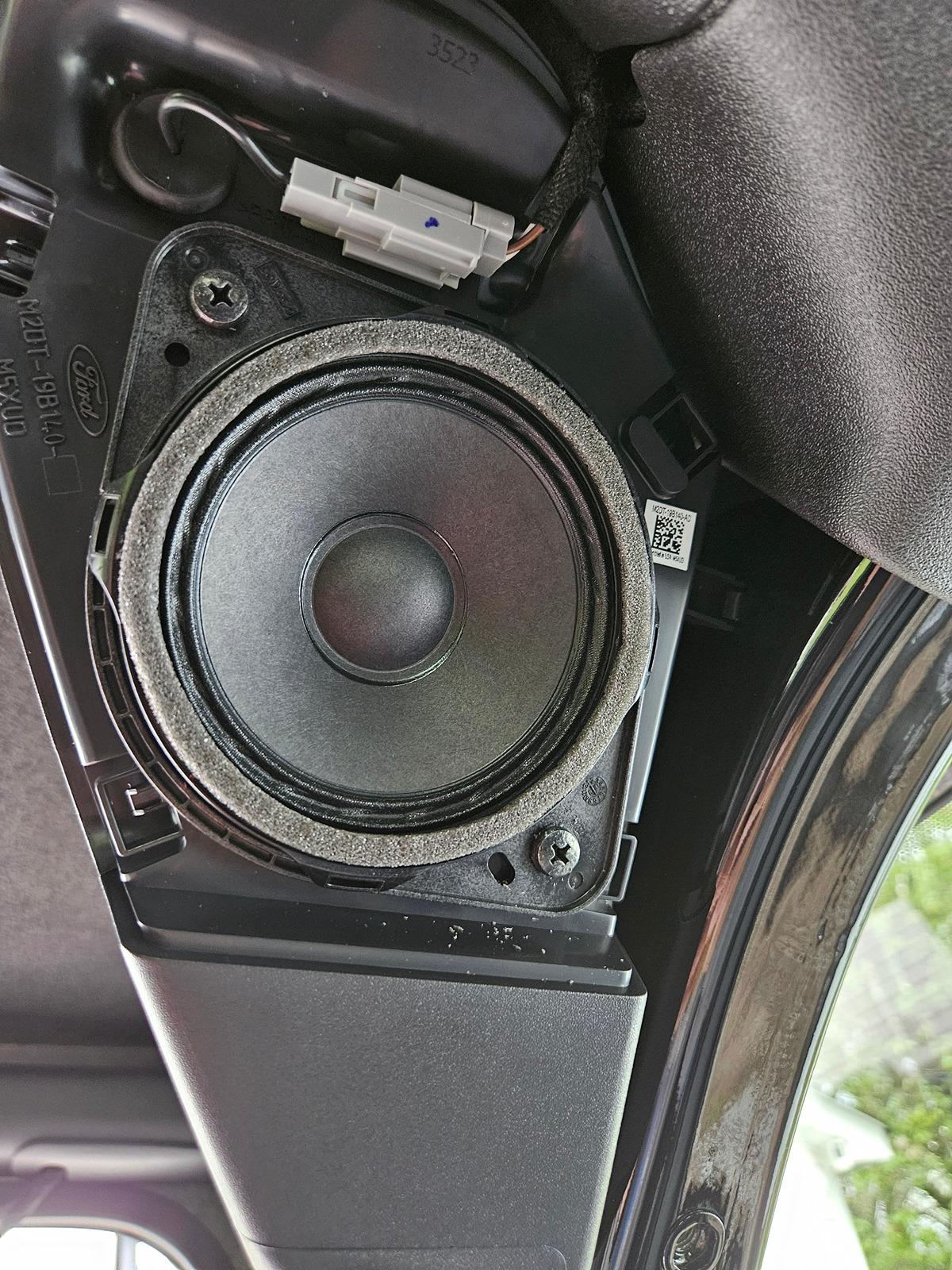

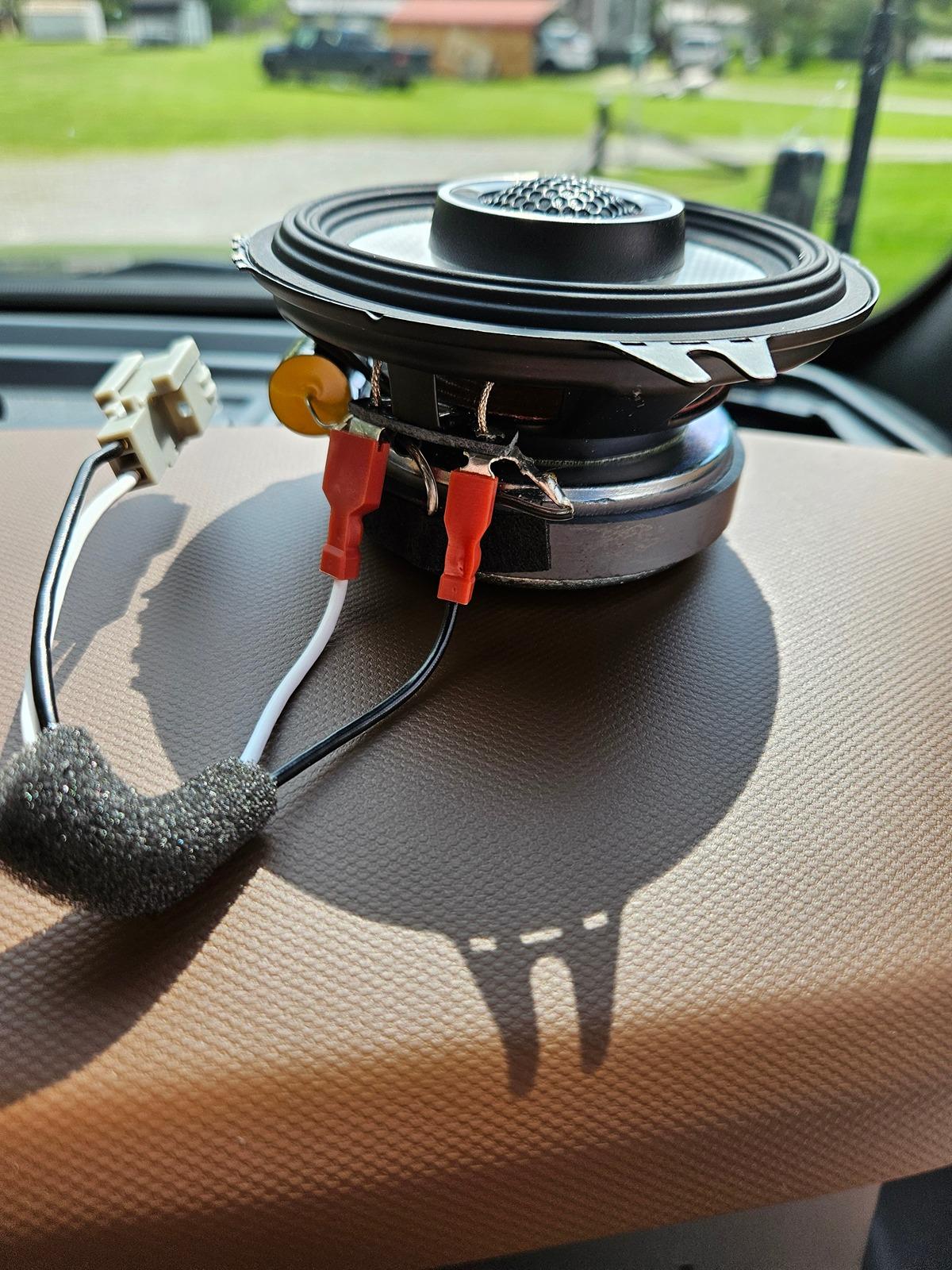

Installed some new speakers and what a difference it makes. I don't have the B&O system but do have the 7 speaker factory setup. I installed S2-S40's in the dash and rear pods. It's probably the easiest install I've done to upgrade speakers. Less than 30 minutes total time.
