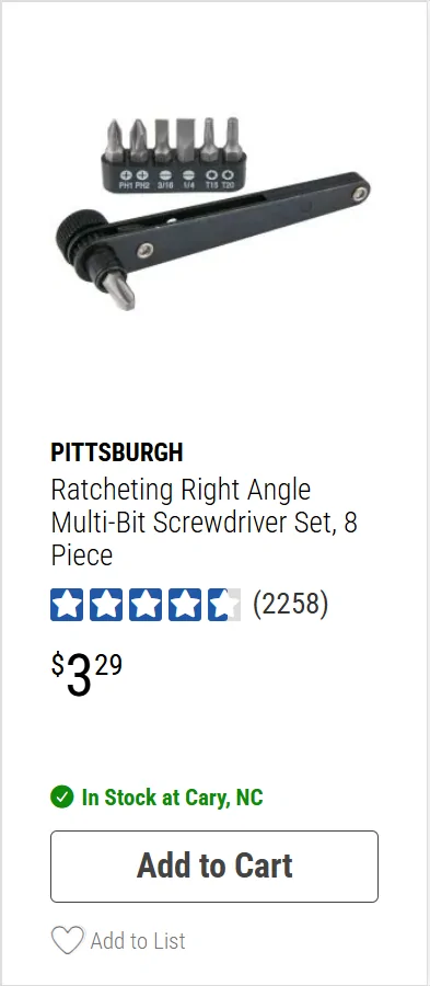

You can use one of these or take the hardtop off, much easier and a time saver
Ford Bronco Installed 6.5 kicker pods ratchet driver
