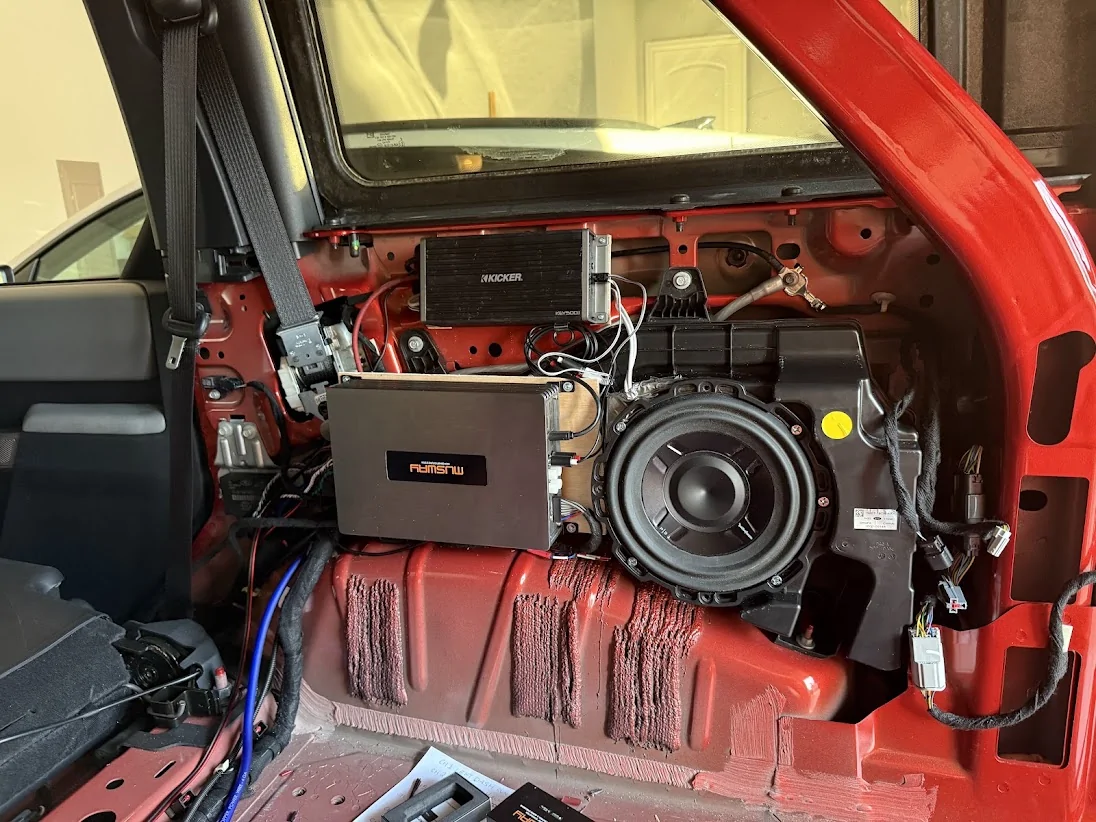

I have had everything installed for about a week now, and I'm very happy with the sound overall. I replaced all of the factory speakers with the Hertz Cento line (CX100 in the dash, C165L in the kick panel and CX165 in SSV pods for the back) and placed a Rockford 8" sub that I had laying around in the factory sub box. As I mentioned, the install was very tight behind the trim panel, and ultimately I had to do a little trimming of the panel to get everything to fit the way that I wanted it. I ended up running new speaker wire from the amp to the dash and used the existing speaker wire for the kicks and pods. Here's a photo of everything before I secured all of the wiring with zip ties to show where I placed everything.

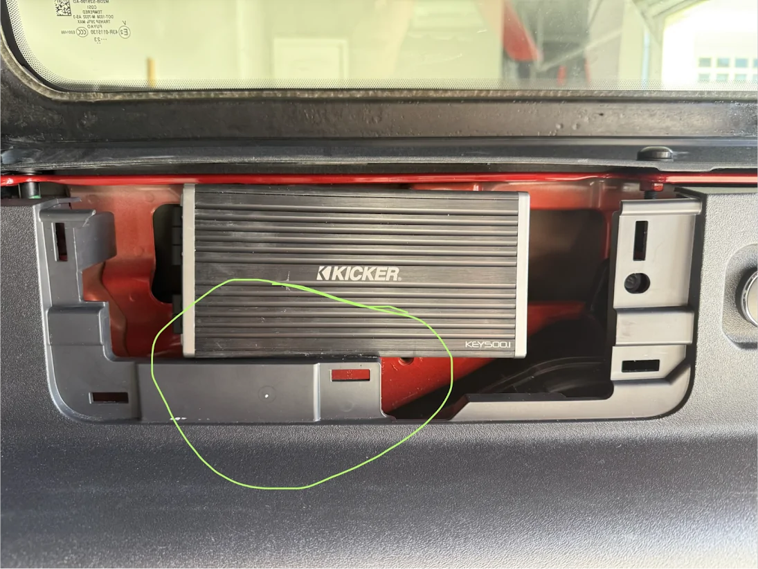

I ended up moving the Key 500.1 a little further down, but there's only so much that you can move it due to the fasteners which have to go just above the Musway amp. In order to move the Key, I had to remove a little of the factory trim, but it is covered by another piece of trim, so you don't see it. Circled area below to show the area I had to remove (and one fastener from the piece of trim). A Dremel with a cutting wheel worked wonders there, and in hindsight, I wish that I would have used that on the sub enclosure instead of the jig saw.

Tuning the Musway was pretty straightforward, but I a still can't get the BTA2 to connect to the iPhone app so that I can switch configurations. That will be a task for another day.

That is a tight fit I guess I won't toss the oe enclosure afterall
