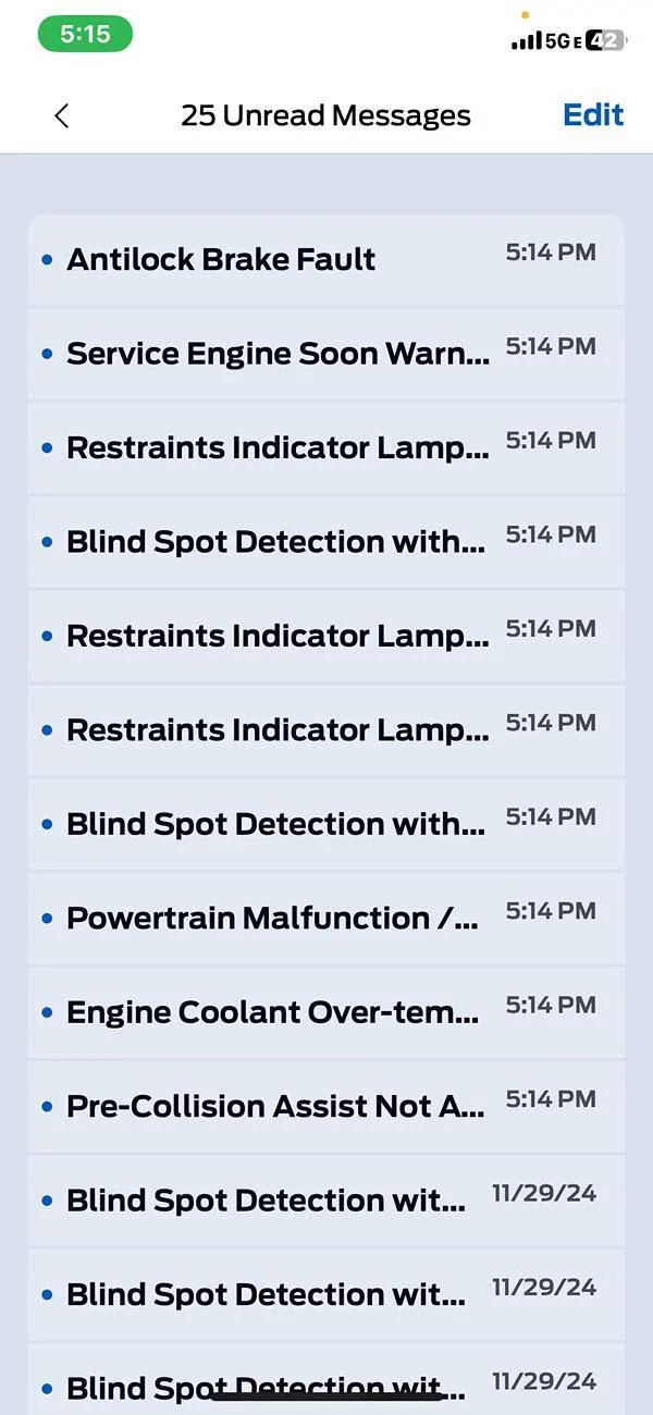

I have a 2022 bronco badlands w/sasquatch package. 63,000 miles. Wet snow sloppy conditions the day I went out for groceries only to come out , after shopping , to every warning light flashing on the dash and wouldn’t start. Tried everything from checking battery posts, unhooked posts for reset, jumped it, tried remote start etc. and nothing worked. Left it over night with below zero temperature. Came back in the morning it started right up! However all alerts still flashing from fix 4wheel drive, braking issues high temp. and many others!! Very scary! That was driving to the ford dealership. They rest everything which took several hrs. Called us to pick up, only to call back and tell us all symptoms came back. That was 8days ago and they still haven’t figured out what is wrong. Anyone else going through this? 😱😩

I'd say dead battery - I know you tried jumping it, and it started fine the next day but AGM batteries are weird sometimes, especially in cold weather. Battery likely has enough juice to actually start the engine, but the voltage it dropping enough that the computers are going haywire.
With the number of computers and everything on cars today, I'm really surprised they haven't moved to a dual battery setup - one just for starting the engine and other large mechanical loads, and a secondary, filtered and protected one just for running the onboard computers and electronics.

It’s just crazy that over night temperatures below zero it started like nothing. And they’ve had it over a week and wouldn’t have checked battery. And why all the technology they have now you would think it would be a no brainer to figure out.?

But the most likely culprit is the battery itself. A lot of places will just check voltage and see 12.xx volts and call it good, but as soon as the engine starts to crank it will dive to around 7-8V, which is probably enough to still crank the engine but the ECMs and other computers start dropping out and flaking. Even on a load tester sometimes it doesn't really identify the issue of a battery just on the edge. And most people aren't going to want to throw $200-$400 at a new battery just to see if that's the issue or not, although you'd think the dealership could just throw one on there to test and not actually have to sell it to you.

I contacted the service department they keep trying things and resets then drive it to see what else shows up. I asked if they tried a new battery and they haven’t yet!? 😅 I’m hoping that’s something they will try next. 🤞🏼

If you are a 2.7 V-6, you may need to check or maybe replace the MAP Sensor.
Manifold-Air flow-Pressure Sensor.
There was a TSB on our 2018 Explorer Sport & it was crazy malfunctioning when it went out on a road trip!!
You will definitely know it is the MAP Sensor if the vehicle is also running ROUGH!!

was running great otherwise, I tried sending a video of what we saw while driving but didn’t send I guess

My money's on a battery or ground. As mentioned above AGM's are weird sometimes. Also you can check some common ground issue locations like the bolts inside the fuse box grounding it to the vehicle. Folks have had those be loose.
