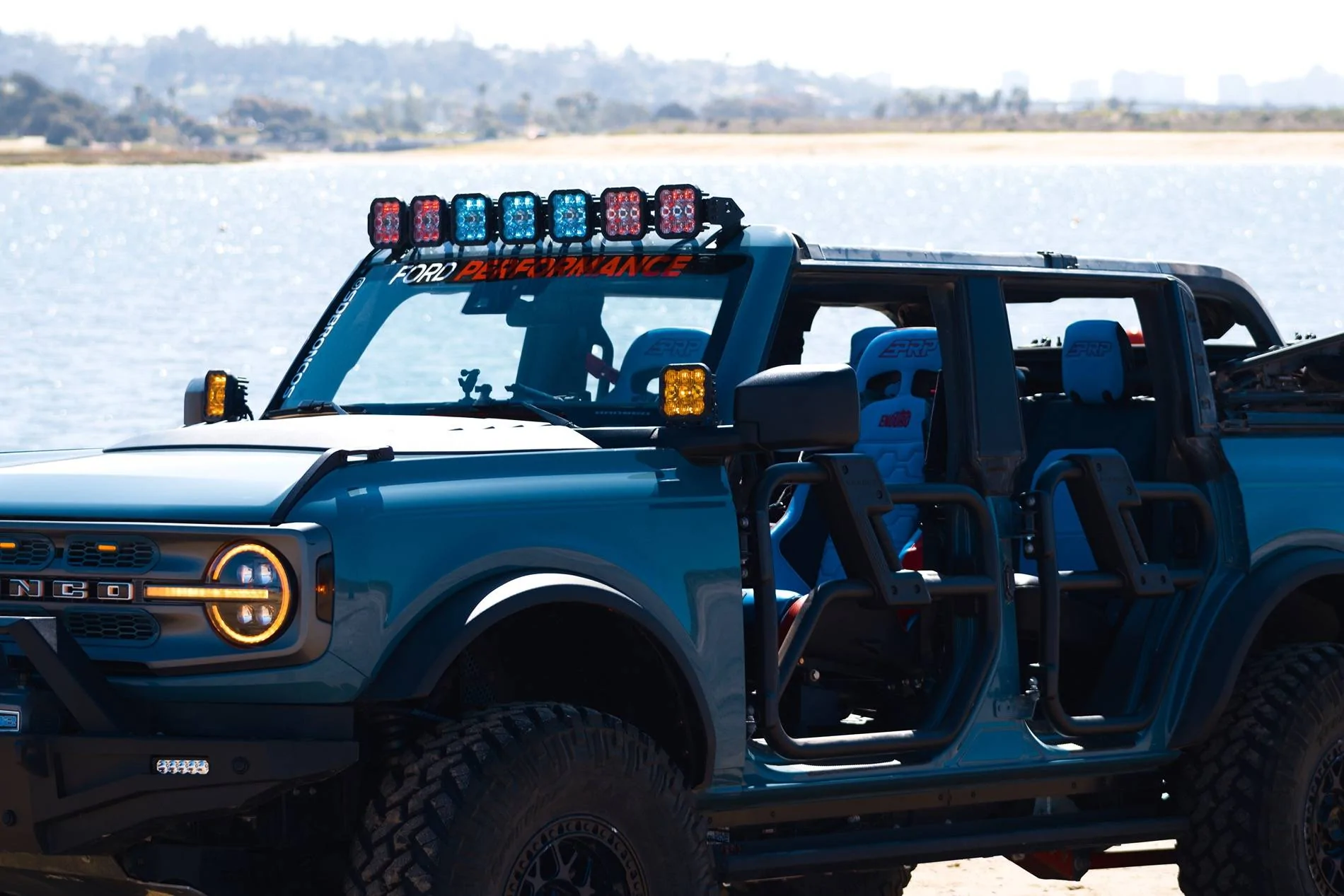

PRP makes the best off-road seats out there. There are no mounting brackets for the bronco out yet, you’ll have to have some fabbed up. We’re big dealers for PRP Seats. Let me know if I can help
Oscar at ACFab makes the brackets that use the stock seat rails! Custom Enduro Crawls here.

Can you share more information on the install? Also how did you work around the seat air bags?
The install is very straightforward, I just took the rails, wiring harness and occupant detection bladder off of the stock seats. The ACFab brackets have a top side with holes/bolts for the PRP base and the bottom holes/bolts go on the frame rails. The bracket also has a hole in the rear to mount a harness bar if desired.
I just live with the airbag light on and that harness is simply unplugged. From the research I have done, it seems more trouble/risk than it’s worth to use a resistor to turn off the warning light.
