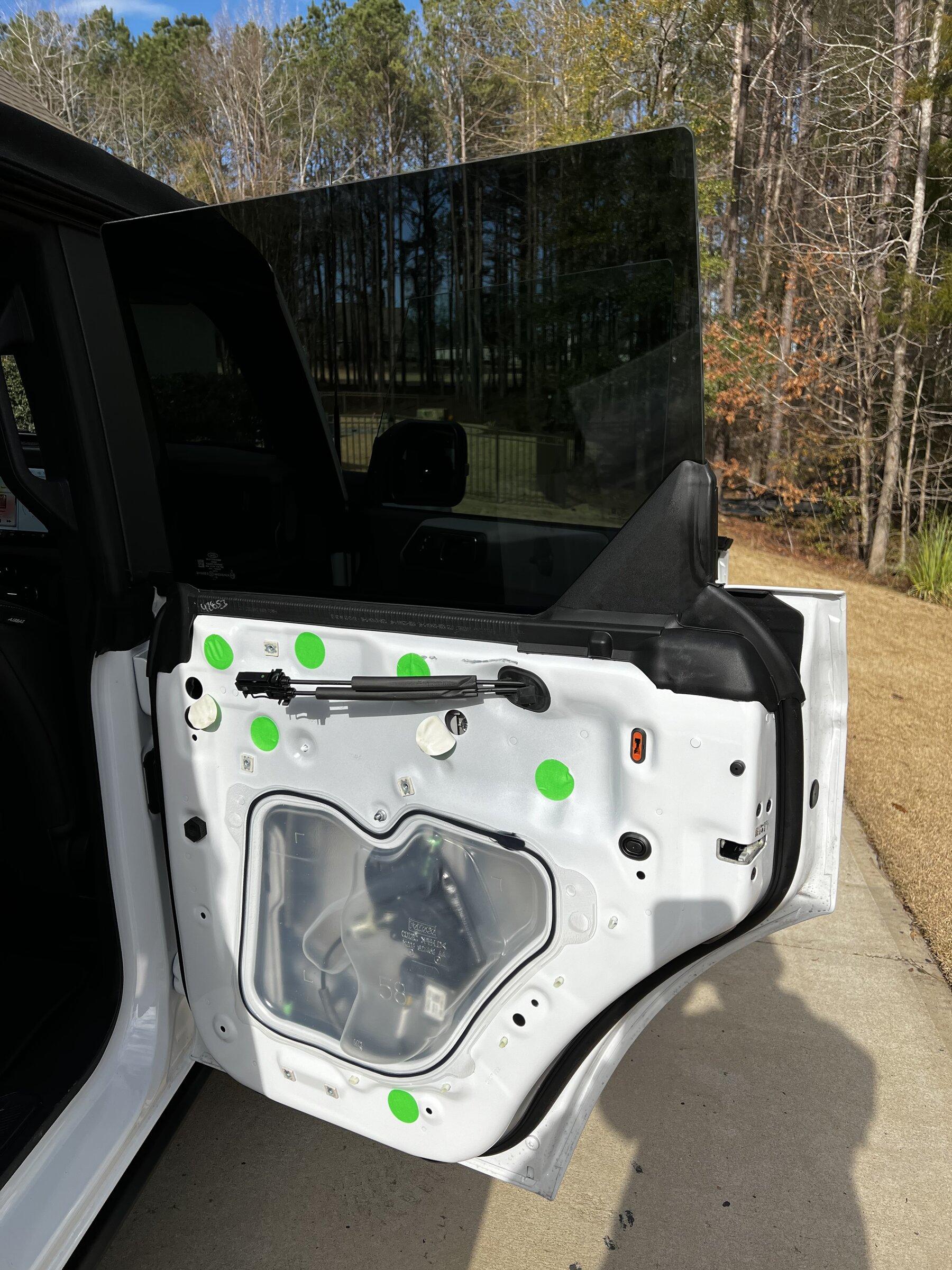

There is another long thread on this someone posted a link to above. Long story short I took mine into the dealer before I attempted to adjust myself. Rear passenger window was main issue. The dealership got it adjusted much better, it didn't feel like it would shatter anymore. I still wasn't happy with it or my other windows. I went at it myself and got them all adjusted to 90% satisfaction. This took several hours and I was very diligent, this issue drives me nuts. I am 100% confident I have them as perfect as possible with the hardware I have. They still get caught a bit and make a noise, slight shake sometimes. The design is flawed, and it seems way too many of these leave the factory out of spec.
I think whoever works the rear passenger window station at the factory needs some retraining though. Or whatever jig they use needs adjustment. Mine was 4mm higher on the left side than the right. I would bet most of these rear passenger issues are the same, the window is installed crooked. It doesn't take much to give you the shake.
Here is the shop manual on how to adjust the windows. It looks daunting but really isnt that bad once you jump in. My dealership fixed the one window and said the others were within spec. They used their two mannequins to show me what spec was. I need to take mine back and show them how much better it can be.

I did it this morning and soo happy. It works soo much better.
Ford Bronco Adjust window drop for door opening? 30CB3BBB-C3E4-44FE-AD43-866E37632D2D
