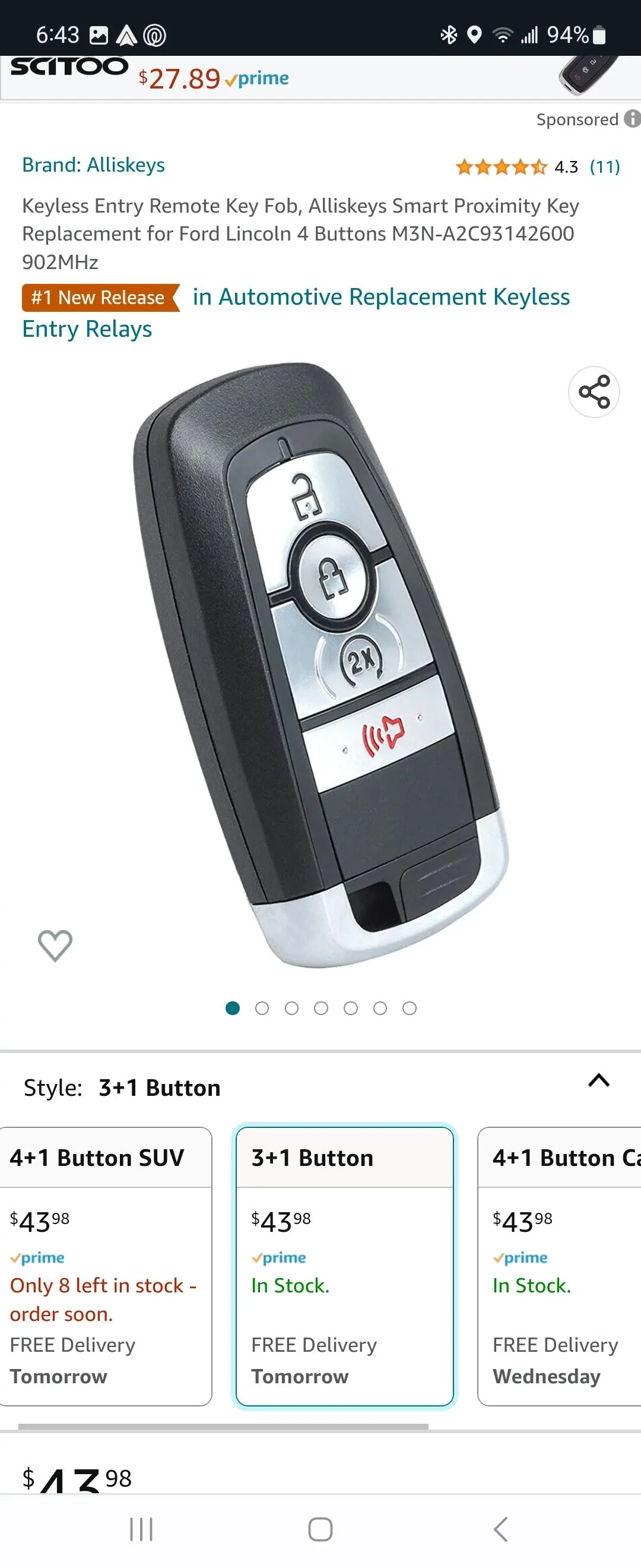

Found this on Amazon.
Do not know if compatible tho ?

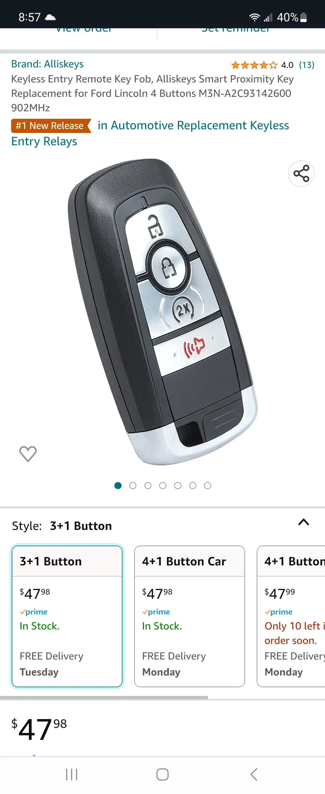

Just programed the 3rd key. Got from Amazon this week. Will get key blade cut by local locksmith in a couple weeks.

Link... I want a third fob but don't care about even having the key made. Just want it in case I lose one.

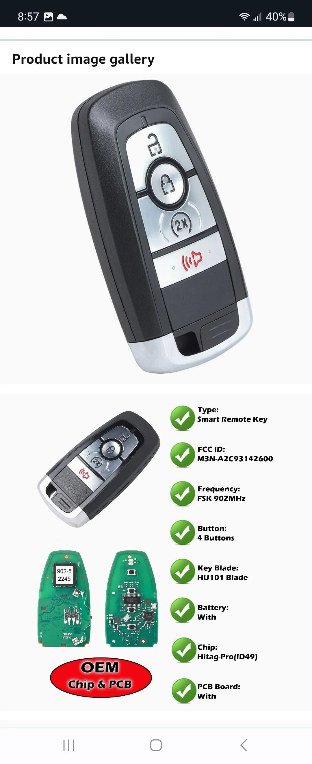

So, Amazon. Type
So, Amazon. Alliskeys is the brand. Just type in Ford Bronco Key Fob. There are other brands and I can't vouch for them. But I added my new fob to my Bronco in under a minute.
Ford Bronco Additional Key Fob Screenshot_20230429_205735_Chrom
Ford Bronco Additional Key Fob Screenshot_20230429_205706_Chrom
Make sure you get correct one depending on if you have factory remote or not.
