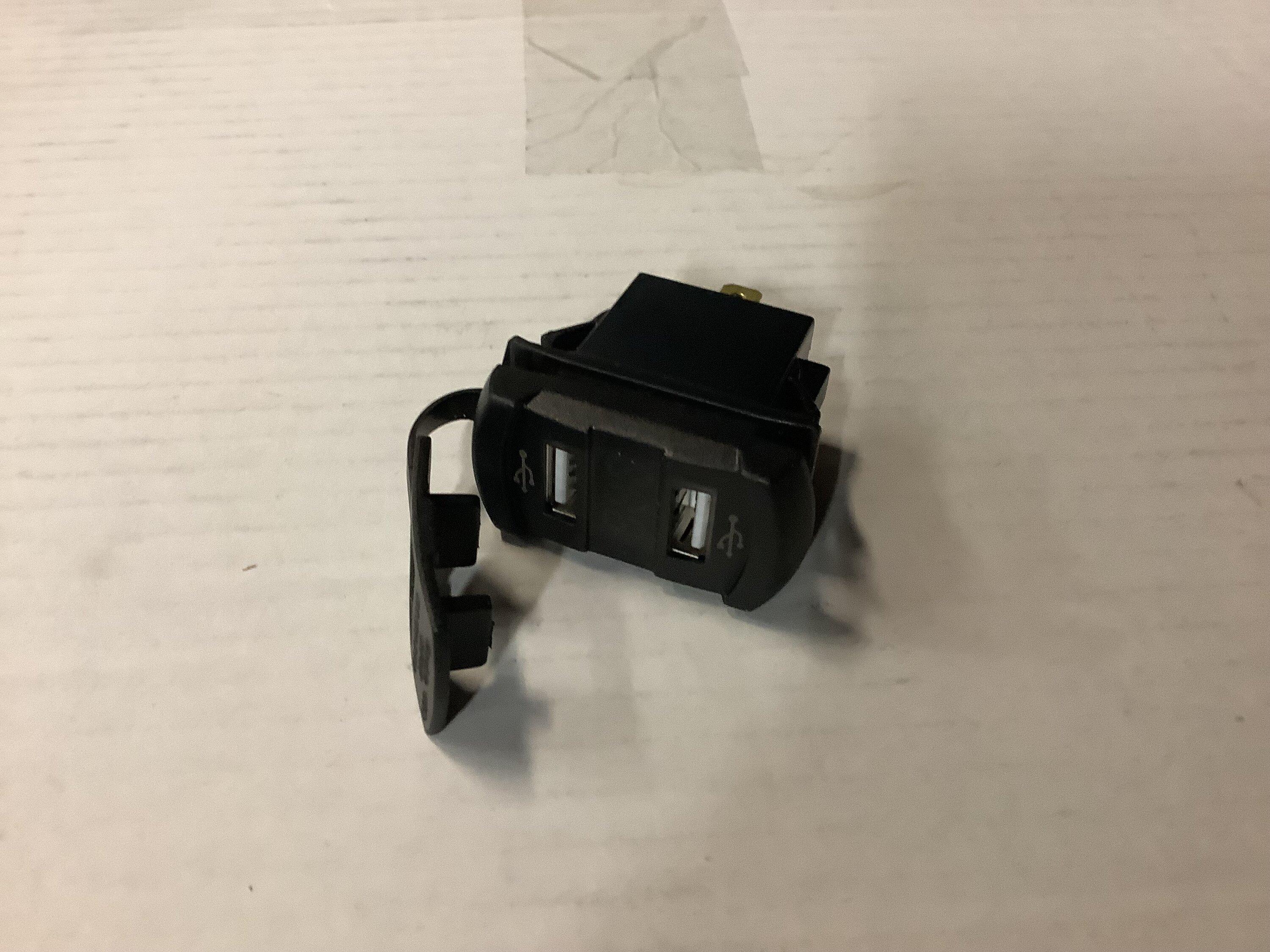

I have a dual usb plug I want to mount on top of dashboard in the center tray on the panel nearest the windshield. I have found lots of videos on removing the closer top dash panel but not the front one. Anyone done it? Or know how to do it…I am a chicken playing with all these panel clips…

Thanks but again it gets the rear part of the dash top off but not the front part… I guess I’ll just take the rear dash top off and see if I can figure it out…already got the sides and above windshield off for my Mickey Mouse light switch box…does not have aux switches…
