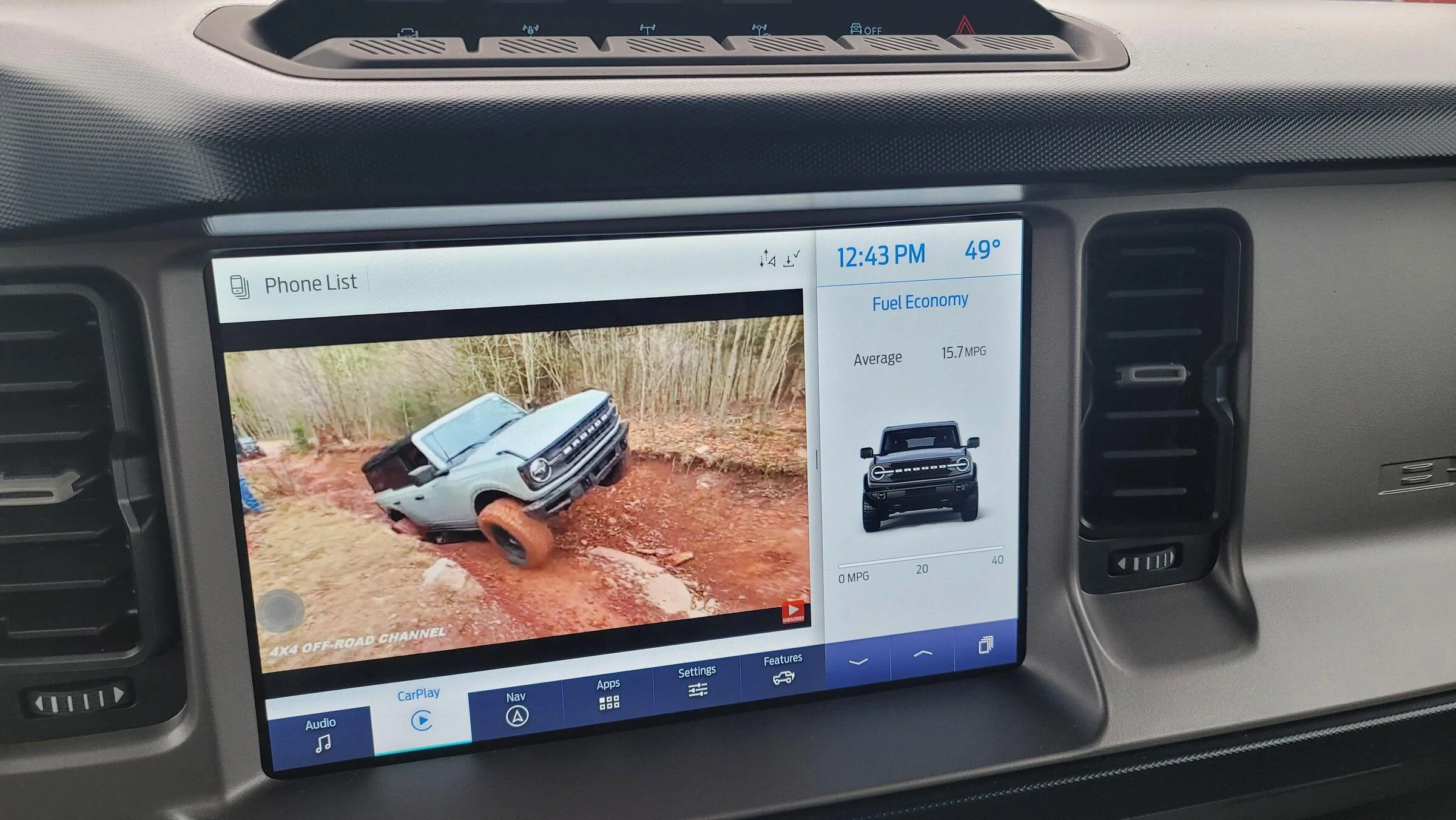

I got mine to work after turning the Bronco on and off a few times. Then I was able to get into the MMB setting menu and turn on wifi. Works well so far.
Ford Bronco Adding USB Multiport / Splitter / MMB Multimedia Input Box and Simple Dash Mount 20211222_124336

I received mine today and got it working. Ordered the android 11 version. I’ve been able to watch a quick 5 minutes on Netflix, download a couple of apps/games and play sonic and a short angry birds tutorial.
It didn’t go smooth at first. Tried to do it really quick and hoping it was just plug & play. Plus I wasn’t 100% sure what cord to use: usb-c/usb-c or usb-a/usb-c.
After I focused on what I was doing, along with watching a quick YouTube video and looking at the crappy instructions.
I used the usb-a/usb-c cord and once the interface came up or better yet, I located it. I went to the settings app, WiFi settings and connected by hotspot. The the same with Bluetooth and GPS. once all that connected, I was good to go.
One note. I also got confused on what sync source to use. Meaning AM, FM, SiriusXM, etc. I used “William’s - iPhone” as my source.
I did have a crackling sound issue so I unplugged everything, plugged it all back in, started it back up. Issue fixed.
Another note: I do not get a start up image, however I do get the start up sound, which sounds pretty cool on the B&O system. Sort of like THX at the end. I wish the image would render.
I also have to manually go to the WiFi setting for it to start searching for my hotspot. Maybe it’s automatic given more time, but I got tried of waiting.
