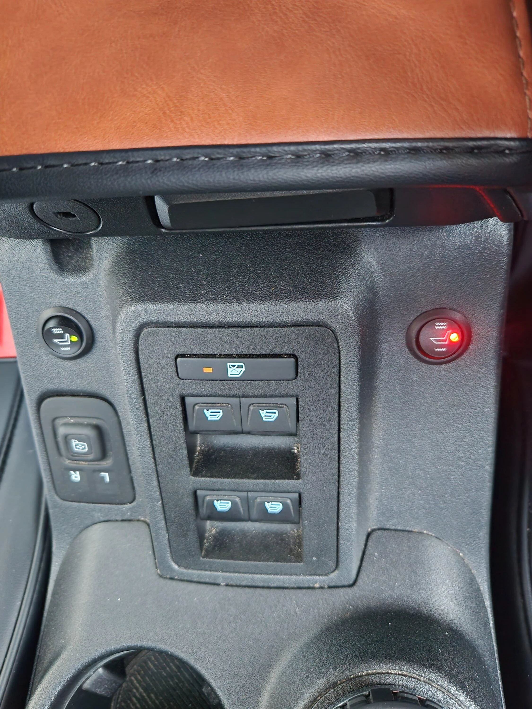

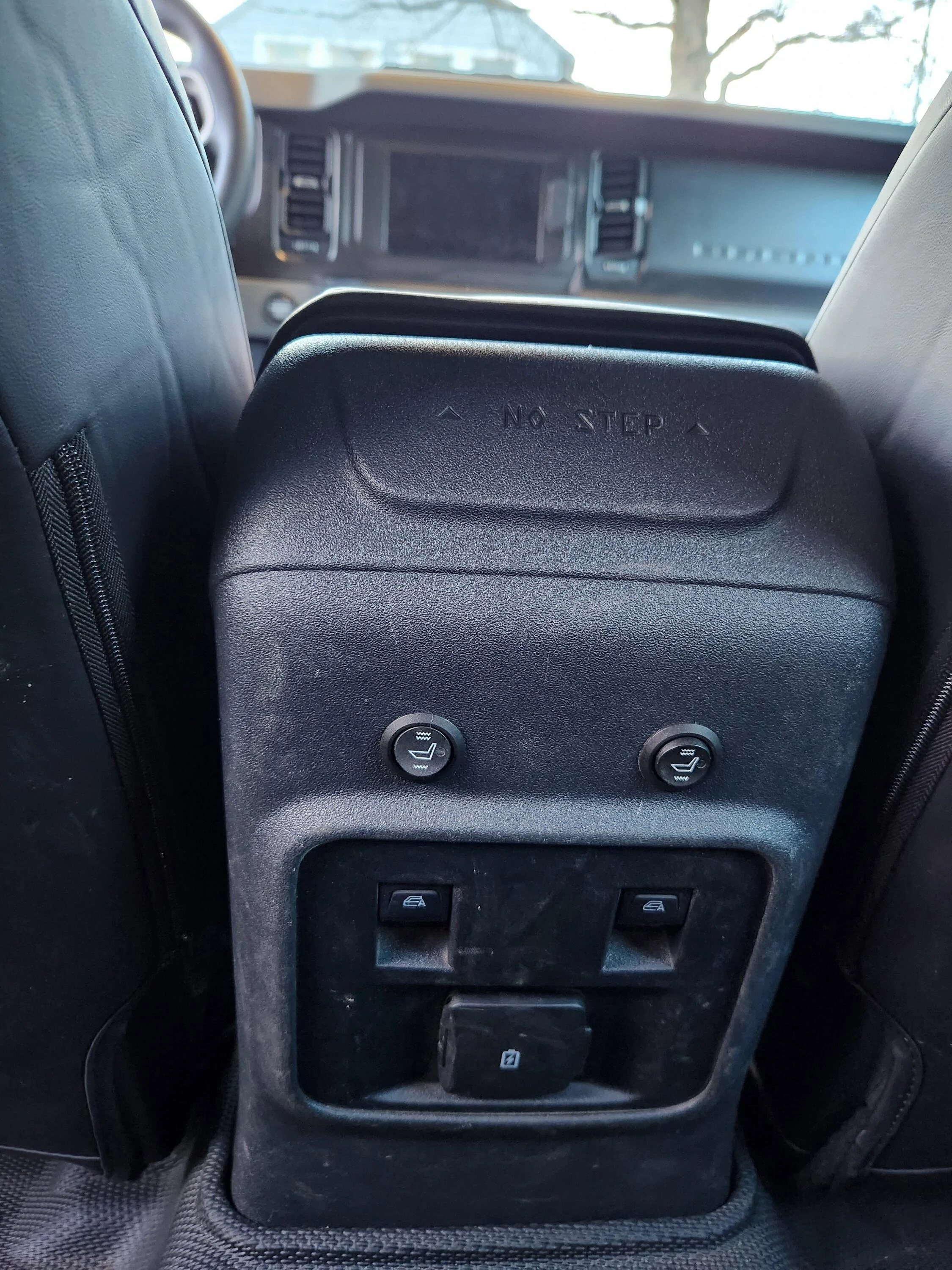

Sorry for the dirty pictures, you can definitely tell that my kids kick all over the back of my seats and rear console!
Here is the link to the heating elements (out of stock):
Seat Cushion Heated seat Kit High/Low Switch Settings Faster Warm Up (2 seat) https://a.co/d/iF5OroM
I ended up purchasing 2 sets. They were under $50/ea set.
Ford Bronco Adding heat elements to rear seats 20230302_173117
Ford Bronco Adding heat elements to rear seats 20230302_173228
