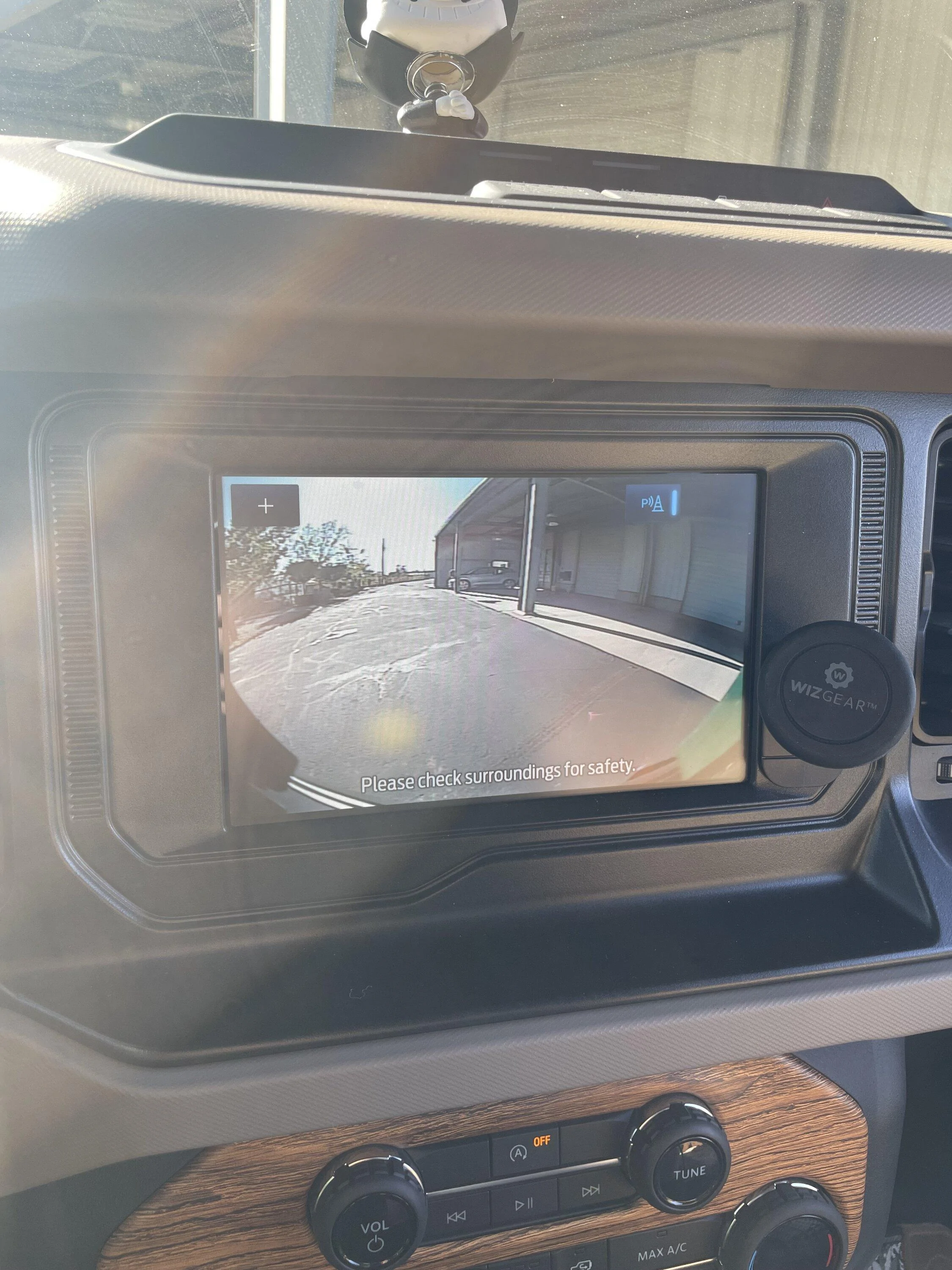

Based on the recommendations in this thread, I installed this Naviks interface after confirming with their customer service it was all I would need to install a front camera with my 8" screen: https://naviks.com/i-24077342-2021-...ass-video-interface.html?ref=category:1137501
I wired up this Natika camera on my Heritage grill between the "O" and "R"
https://a.co/d/2FUrVxQ
Camera works like it came stock. Turns on for 8 seconds when I put the car in drive and I can press the menu button on the steering wheel for 5 seconds anytime to bring it up.

Do you have a link to the camera? That link is just back to this page. How do you like the setup? Any pics of the display as well? Thanks..
Ha, sorry, that was a bonehead move! I fixed the camera link in my first post. I’ll upload a photo of the display when I drive home. So far I really like the set up. It’s so hard to see over the giant hood, especially if you are vertically challenged like me, I’ve already found it very useful.
