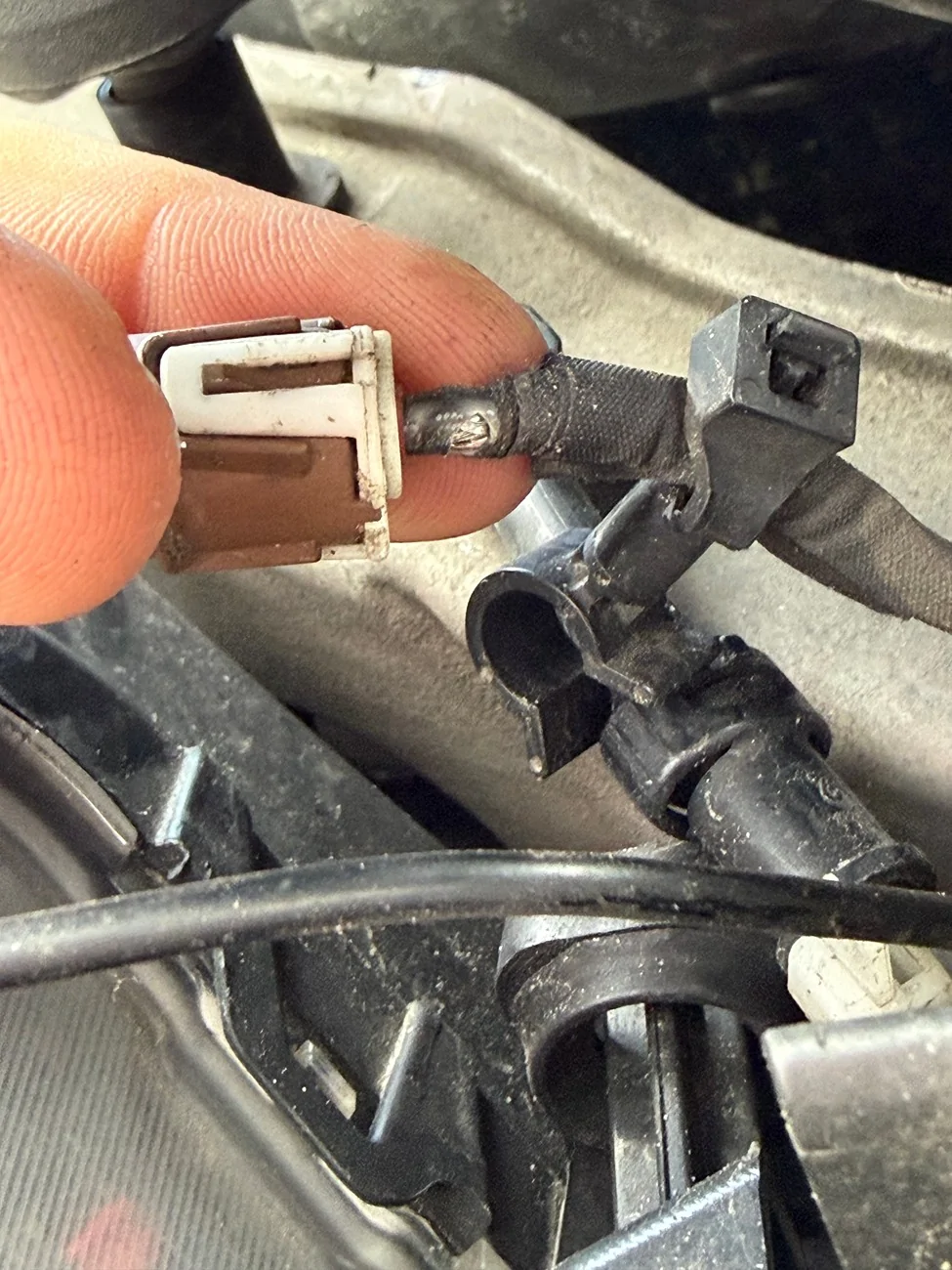

Do you have any part number by chance? I have a raptor and i pinched my front camera wire this week. (the car side of course) i assume i can run a new wire from the grill to the module under the dash ( if i can find that lol)
