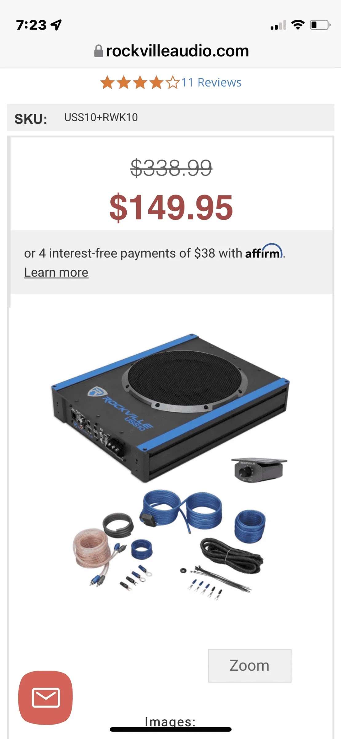

I popped one of these in. Got the harness kit #1 from plug n play kits.com
I was leery on it because of the low price but it sounds great and takes up very little room.
