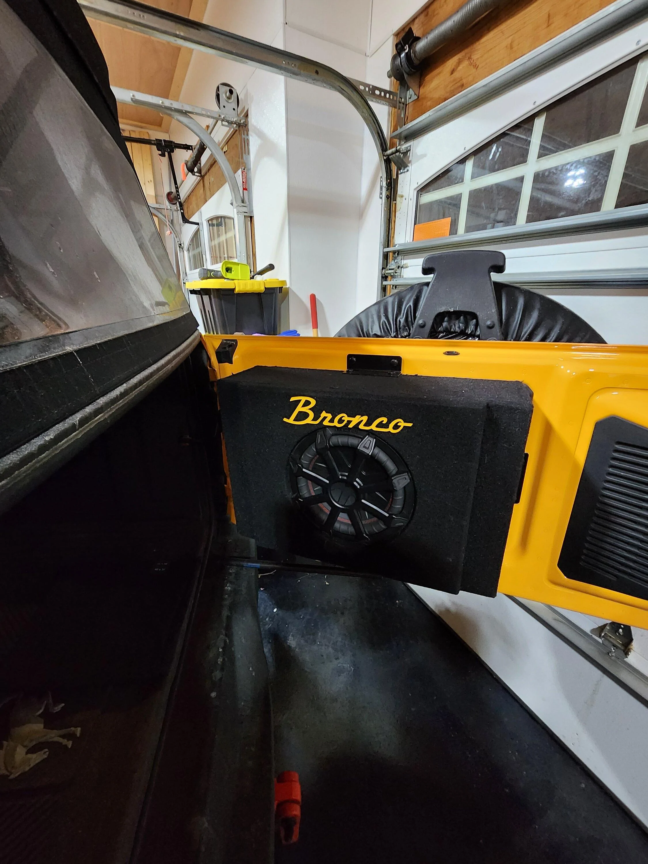

I would figure out how to hang it on the tailgate. I like having the floor space vs the few inches I loose by hanging it on the door. I removed the OEM rattle box and sub and placed the Kicker 500.1 there.
Ford Bronco Powered Subwoofer: So many questions! 20221117_195657
