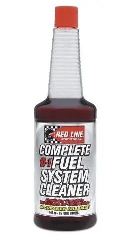

I have been trying to stay away from DI because of all the issues with maintenance and added problems. I bought my 2016 5.0 coyote because it was NOT DI. Can you tell me what maintenance should be done to keep the 2.7 problem free ? I have only ever ran Red Line in my trucks at each oil change and never had any issues with dirty injectors, codes thrown of even poor performance. I understand from Dealer, that should not be expected on 2.7.
Red Line is that a fuel additive/cleaner?
