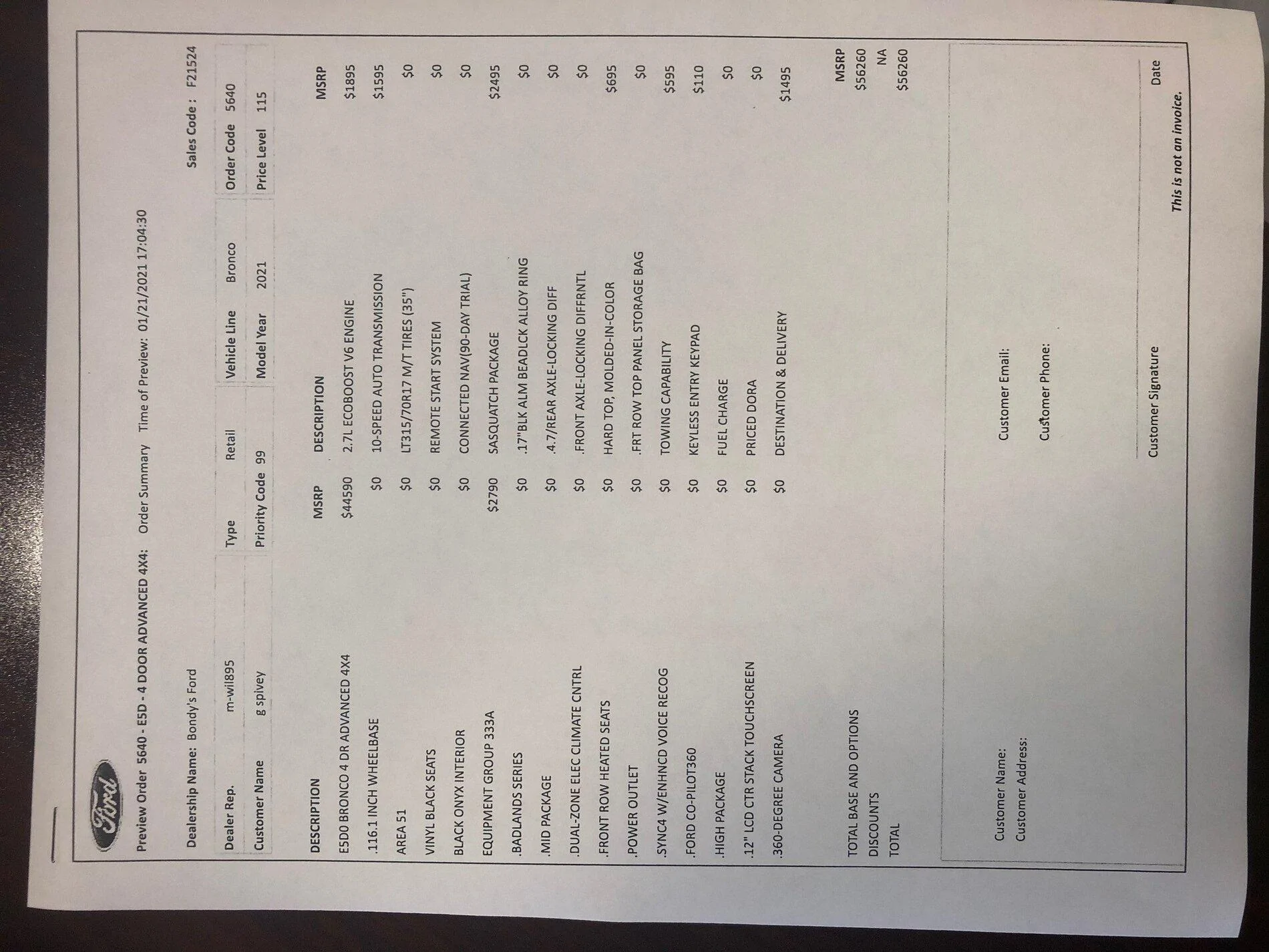

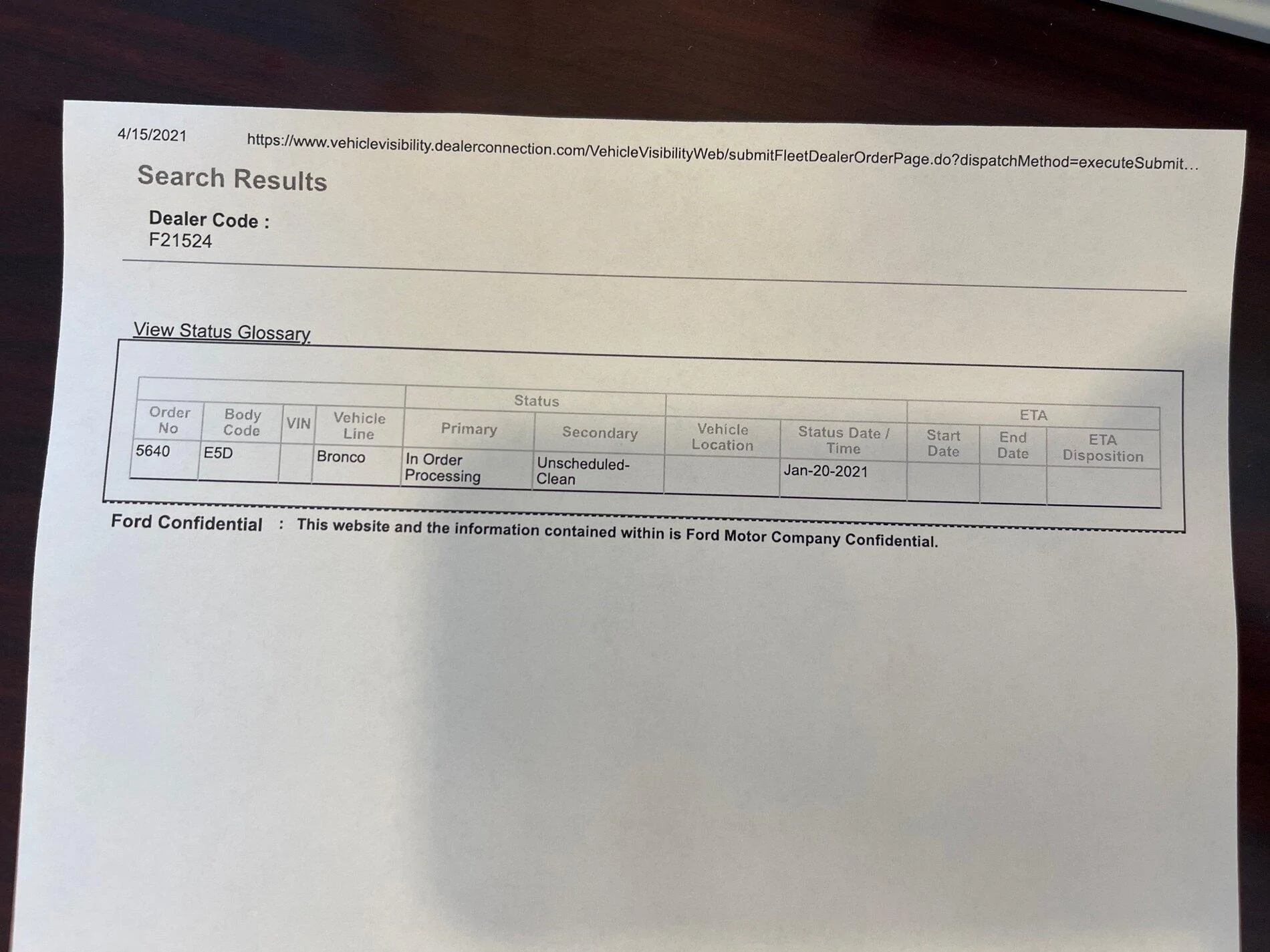

I have a Wildtrack SAS reservation converted to order. The order was placed 1/21 and shows code 99. I have discussed the code 99 with my salesman and they act clueless about the code 99. No amount of discussion will convince them that it means "do not build". They say my order has been "picked up" by Ford but that it will be next month before they know anything officially. None of this seems to match the discussions on the forum. When I told him that his info did not match what I am reading he sent another print out that shows my order In Processing and Unscheduled Clean. Does this mean anything? Does this mean the code 99 has been changed? Any suggestions from the experts?
Thanks in advance.

I'd ask them for an updated order summary preview. If it still says 99 then it's not going to get scheduled or a Dealer Order receipt (DORA) and if that has priority 99 then that confirms they need to edit the priority code.

The Bronco was converted Code 99 (used for 2022 builds) but not built and accepted so they need to do that and then it will be a 19 for a chance at a 2021...

Your dealer is either lying or doesn't know what they are talking about. Either way, it is you that suffers. I personally would not put up with this situation, but I'm an aggressive prick when I need to be. You now have confirmation from earlier posts that your vehicle will not be built for MY21 with a code of 99. You would have already know this if you were active on this forum. Go to the dealer and do NOT leave until you have a new DORA with a code between 10-19. Don't be passive.

Don't know if my eyes are fooling me, but there seems to be a huge mistake on your order summary. You say you ordered the Wildtrak, but the order summary says it's a Badlands. You may want to get that sorted out as well. Hopefully you meant Badlands SAS and not Wildtrak.
