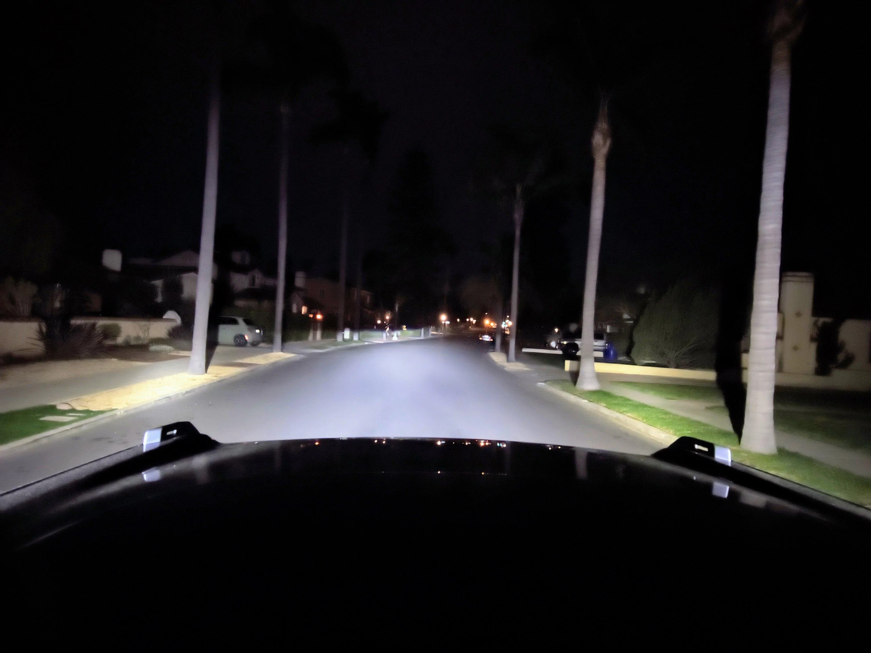

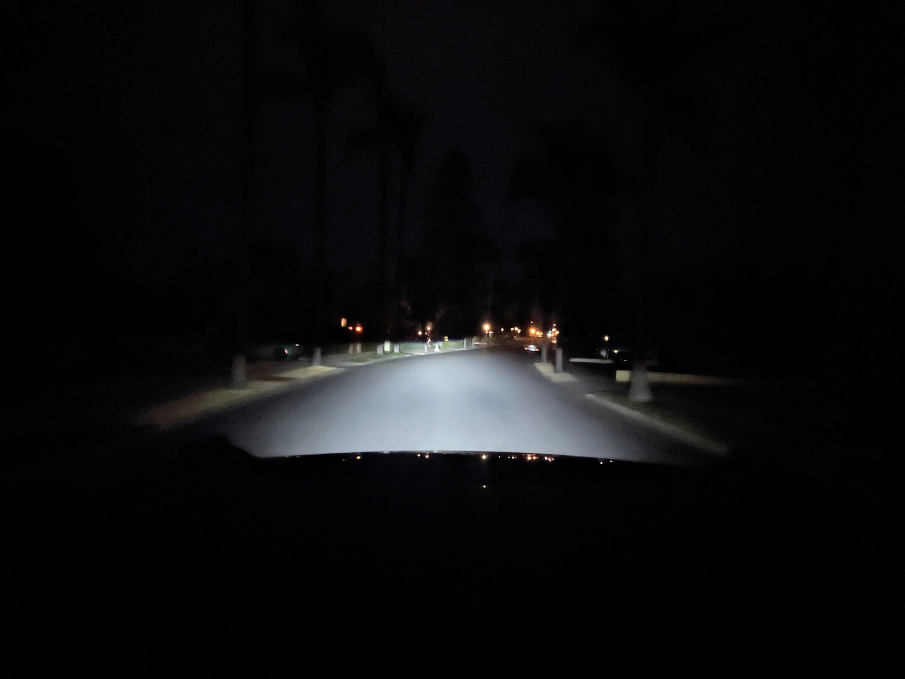

You should point them out farther, I see a ton of reflection from the hood, which at night I find incredibly distracting as it messes with my night vision.
One of the problems with the accessory points on the Bronco A pillar is that the side mirrors interfere with the proper direction of the ditch lights. They just reflect a ton of light back into the cabin the moment the angle is the ditch light exceeds 20 degrees or so (if you are using combo or flood lights)
The DV8 bracket is very useful to address this design issue, as it places the light low and on the side of the fender, where any glare does not make it back into the cabin.
https://dv8offroad.com/products/6th-gen-bronco-a-pillar-dual-light-mounts
DV8 kind of pissed on their good work by not proving any mounting hardware with these, as the heads of the OEM accessory bolts are too small for the mounting cutouts.
Below are a "without" and "with" pair with the DV8 brackets and the $80 Harbor Freight ditch lights.
https://www.harborfreight.com/light...3-in-led-spot-with-side-light-pair-57538.html
Notice the nearly complete absence of hood or A pillar reflection. The lights are pointed about 30 degrees out
