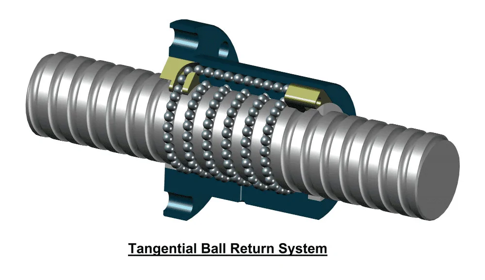

That pulley/bearing is called a ball-nut. very clever piece engineering (not new by any means). Great way to make an exceptionally low friction lead screw, which is essentially what the steering rack is on these.
The tube with the balls in it is a return path for the balls. You can think of the ball-nut as a ball bearing where the balls travel in a spiral path instead of a circular path. The rack has a matching spiral for the balls/ball-nut to follow or drive.
As the ball-nut rotates, the balls are transferred from one end, up over (through the tube) back to the start again, and vise versa. If you hold the ball-nut laterally in position in the housing, and rotate it, it will thrust the rack in and out depending on direction, and does so with minimal (relatively speaking) friction since it operates like a ball bearing.

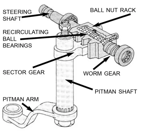

RCB steering gears also use this method, but in reverse. RCB=recirculating ball. Think pitman arm steering. In those cases the input shaft from the steering wheel drives the ball-nut in and out, which drives the pitman arm left and right.
RCB steering gears also use this method, but in reverse. RCB=recirculating ball. Think pitman arm steering. In those cases the input shaft from the steering drives the wheel ball-nut in and out, which drives the pitman arm in and out.
