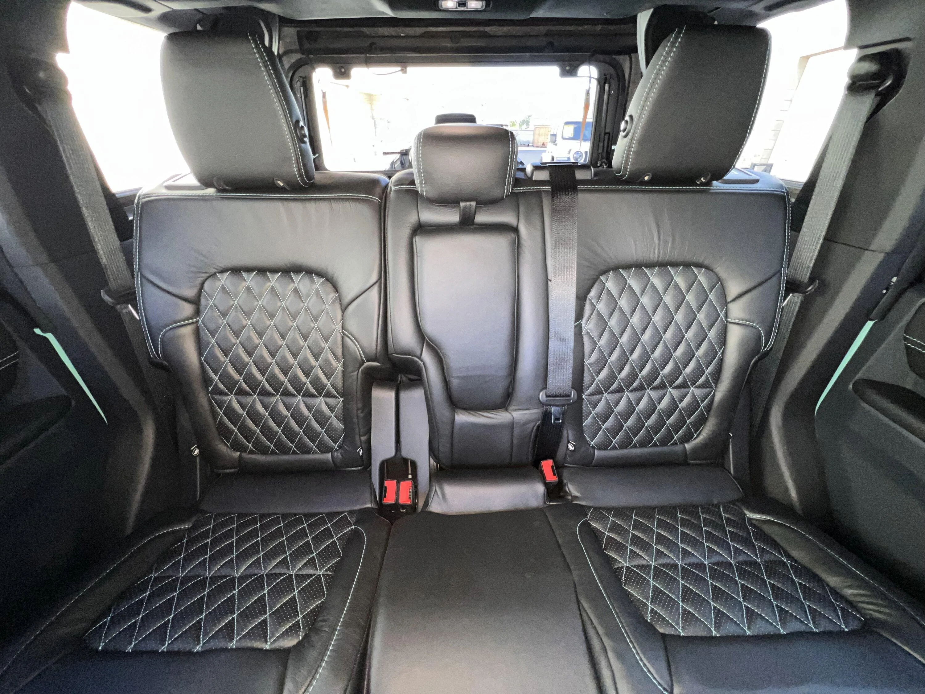

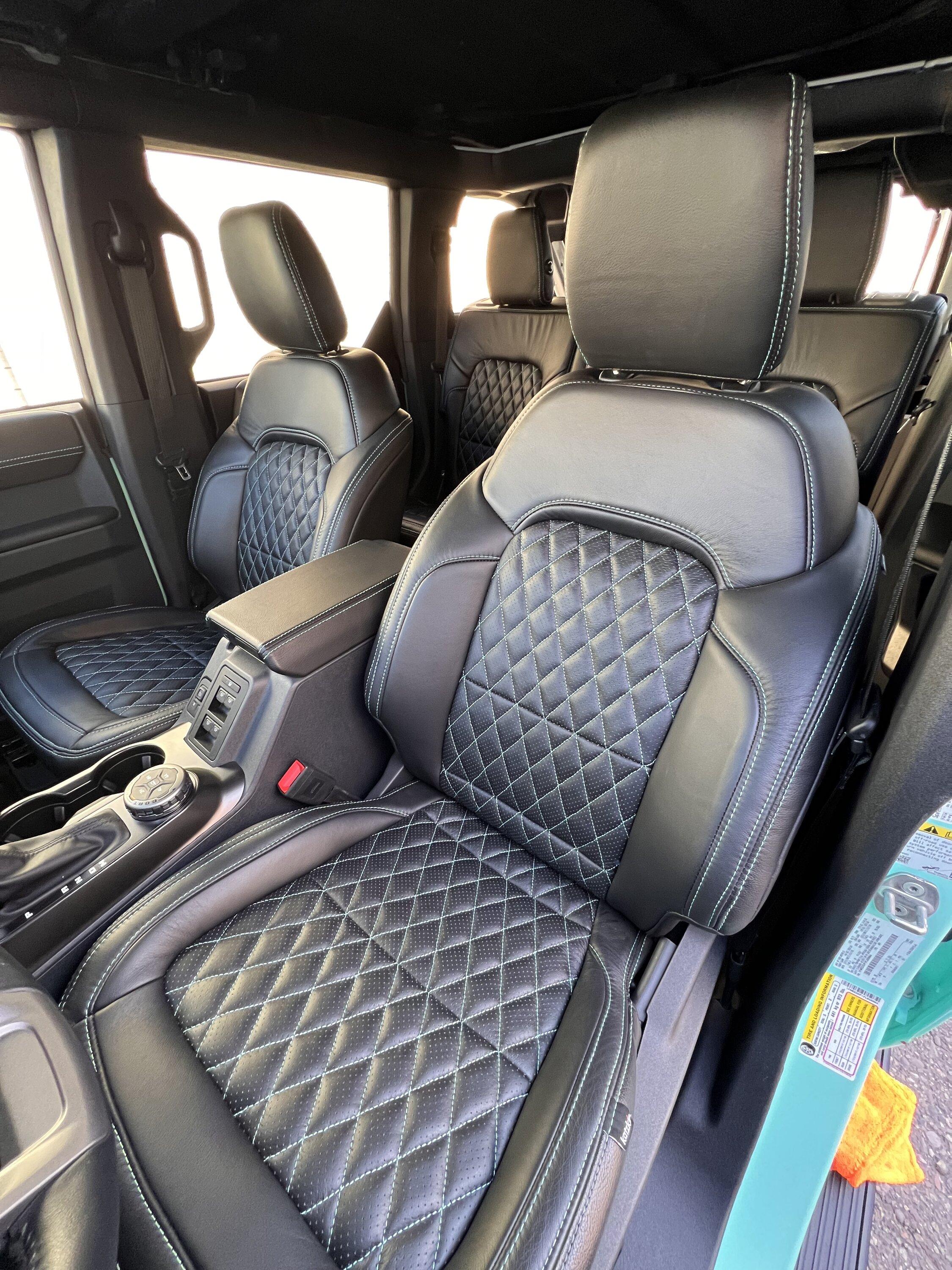

Inside, we designed a full custom Katzkin Leather seat package featuring Black leather with Tiffany Blue cross-stitch on the inserts (along with perforated centers) and double stitch along all the edges. Additional material was used to wrap the center console lid, door panels and the entire upper dash in matching leather & stitch. We also added Katzin’s Degreez heating and cooling module, bringing ventilated seats to the Bronco which are not available from the factory.
