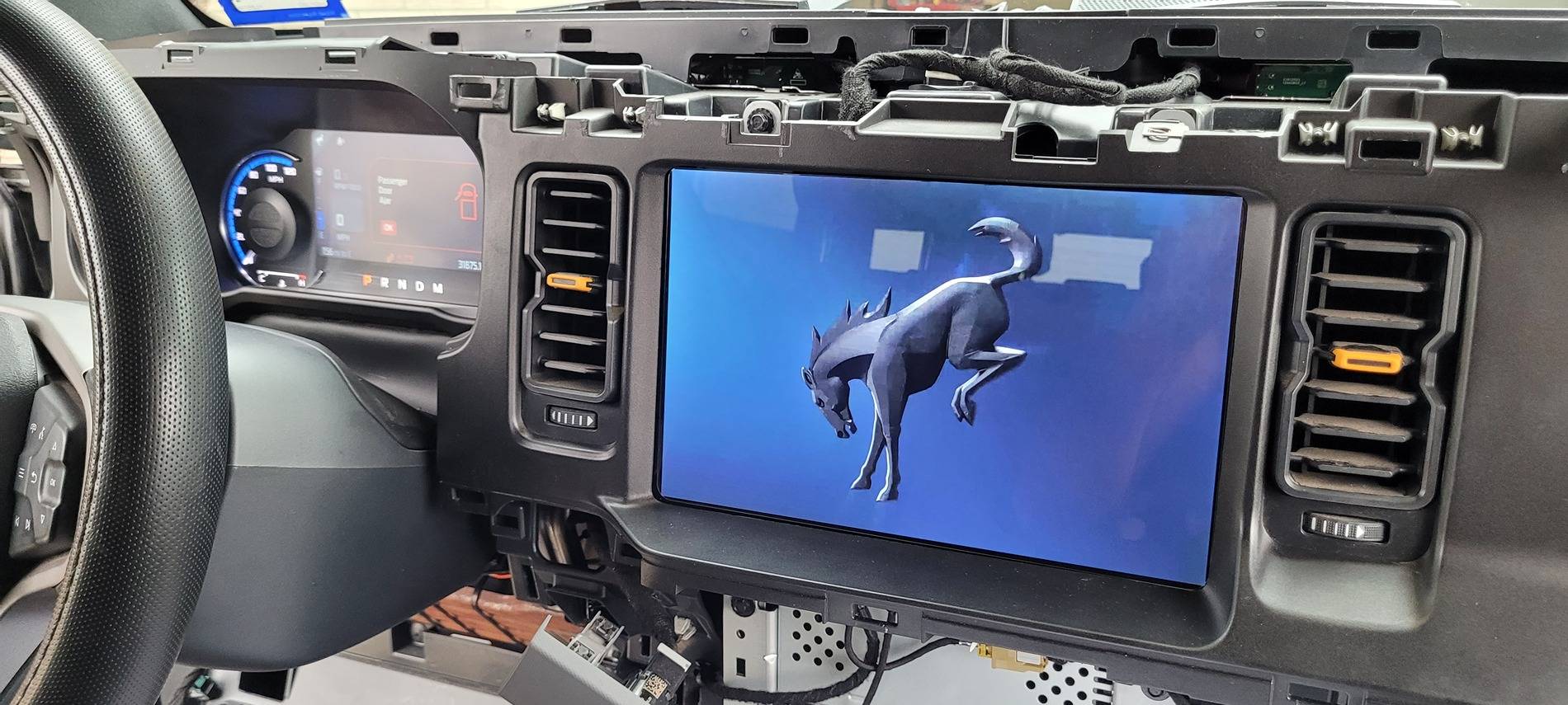

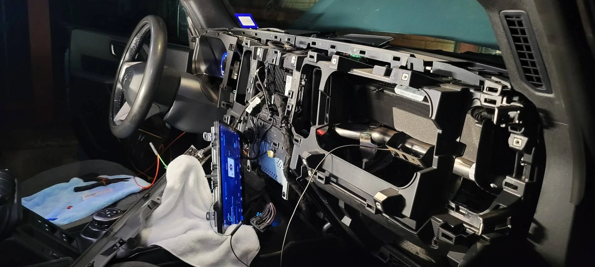

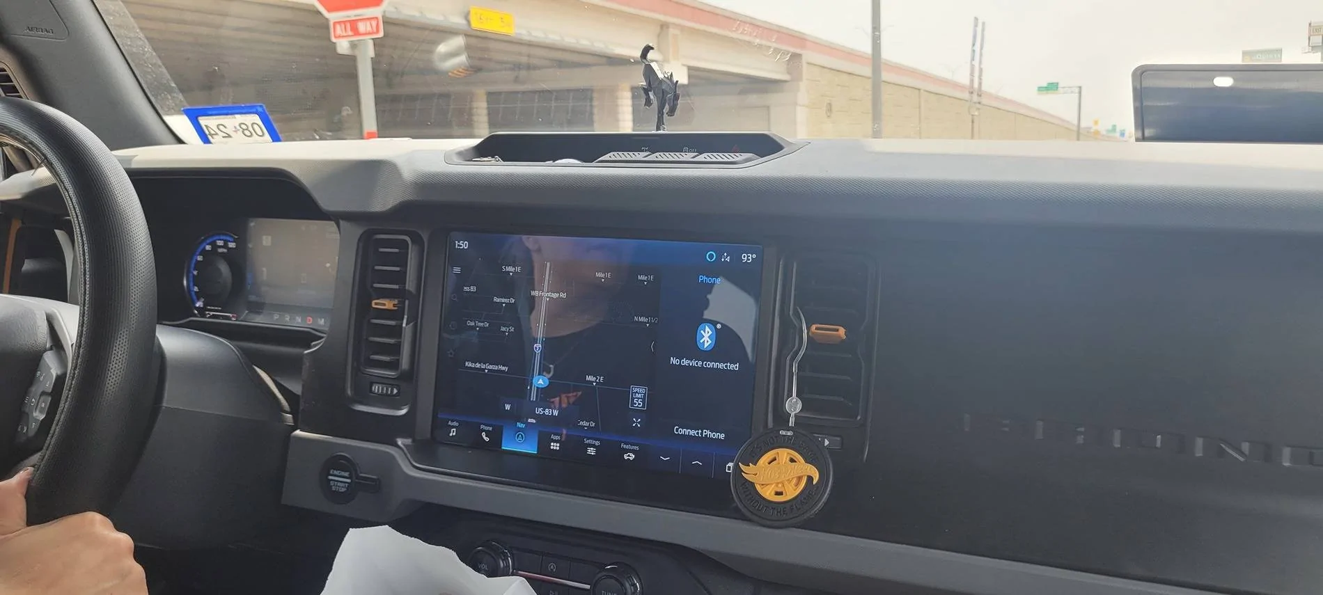

Hello, so a few months ago I came across a thread on if it were possible to swap from an 8" to 12" display on a 6g Ford Bronco. All credit to Schwaggle whom motivated me to try it. I have to say it was a success on my 2022 big bend bronco

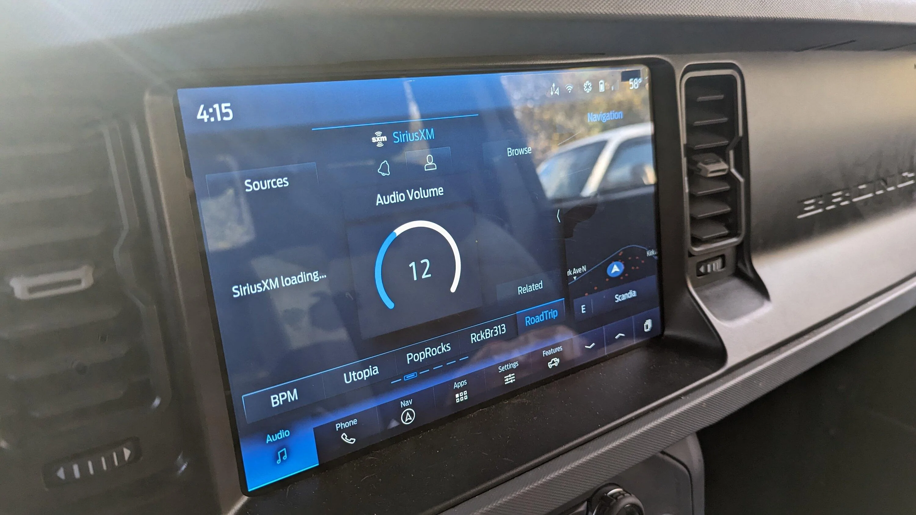

However one thing I have not been able to fix is my on screen volume control. It always reads 0 when turning with knob. Wondering if anyone has a forscan setting that would resolve this? I'd greatly appreciate any and all help with this.
I think @Schwaggle was able to fix that in his swap. Linked post below referencing Forscan.
***** 7D0-01-01 = 0101 0303 06E7 *****
Nabbed it from an ecosport forum or something, but volume numbers do stuff now lol

Volume works fine. But it will not register the digits. Just zero see pic.
Yes, there is a FORSCAN setting that will likely fix it, I caused the same error when installing my MoBridge amp and was trying to get all the B&O error messages to resolve, only problem is that I don't remember what setting it was.
I would look at 727-01-01 and 7D0-01-01.
In my case, I ended up doing this:
7D0-01-01 Axxx-xxxx-xx becomes 2xxx-xxxx-xx
727-01-01 xx3F-3FxD-xx becomes xx3F-3Fx9-xx
The decodes are available online if you look, but I am drawing a blank on the website at the moment. I would compare it to other Bronco AsBuilts with the 12" screen without B&O.
Edit: missed the previous post with the correct answer. 7D0-01-01 is the likely culprit.

Appreciate you taking the time to share that info. When you have a chance can you confirm what you ended up under the 7d0-01-01. Because Schwaggle settings start with 0 and yours with a 2. Just want to be sure before I reset those settings.
mpeugeot
May 14, 2021
9,147
18,929
I have a very different Bronco, use Schwaggles values. Mine is a factory lux package with an aftermarket amplifier. Totally different situation. Just was providing some context.
