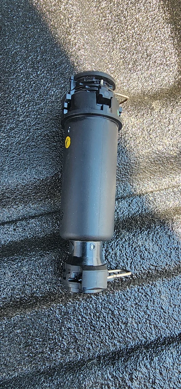

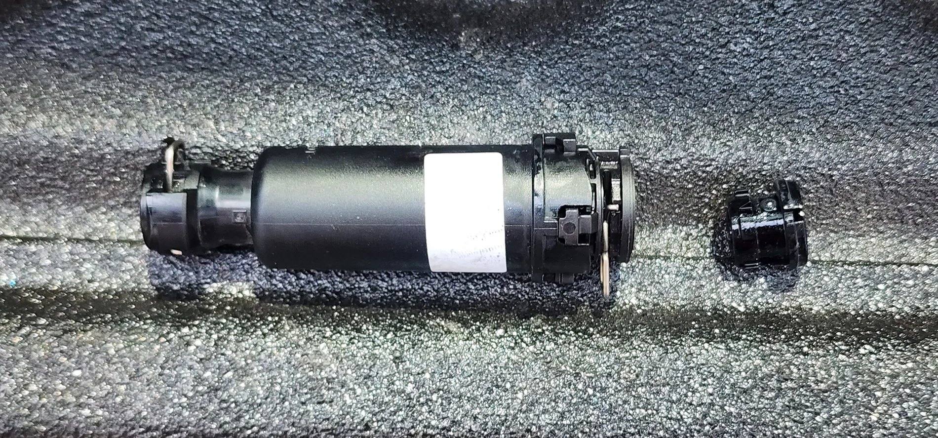

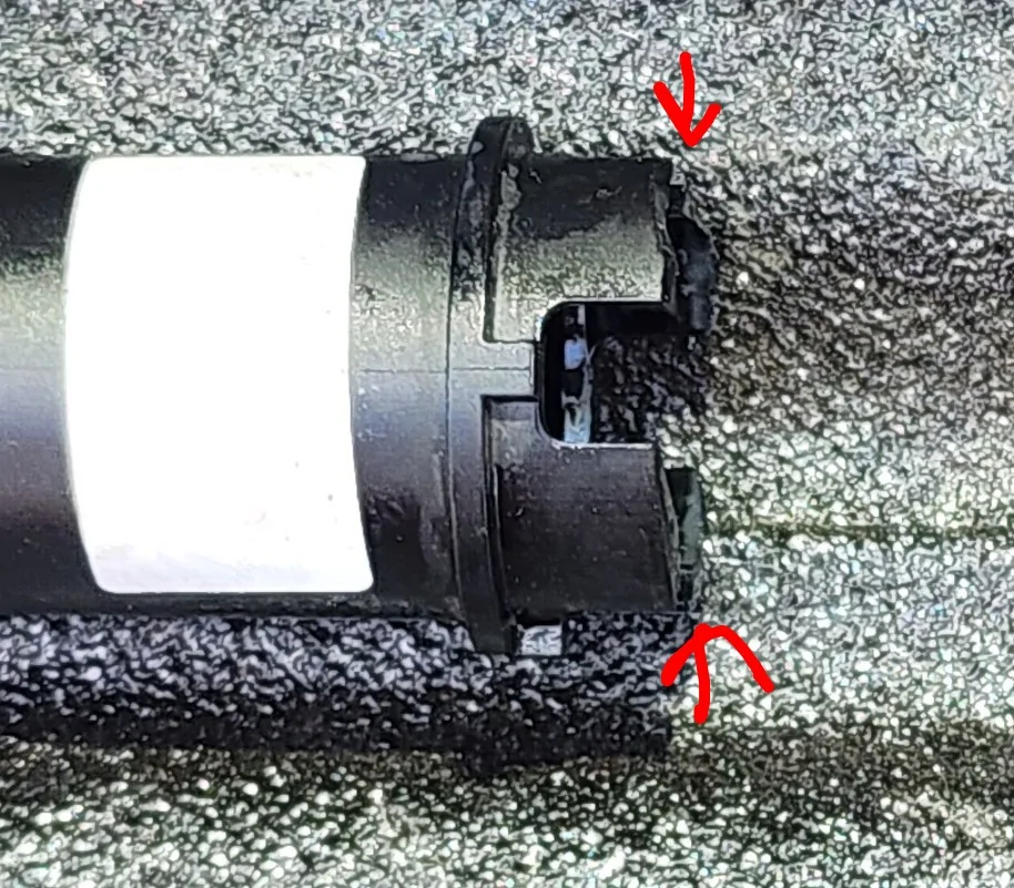

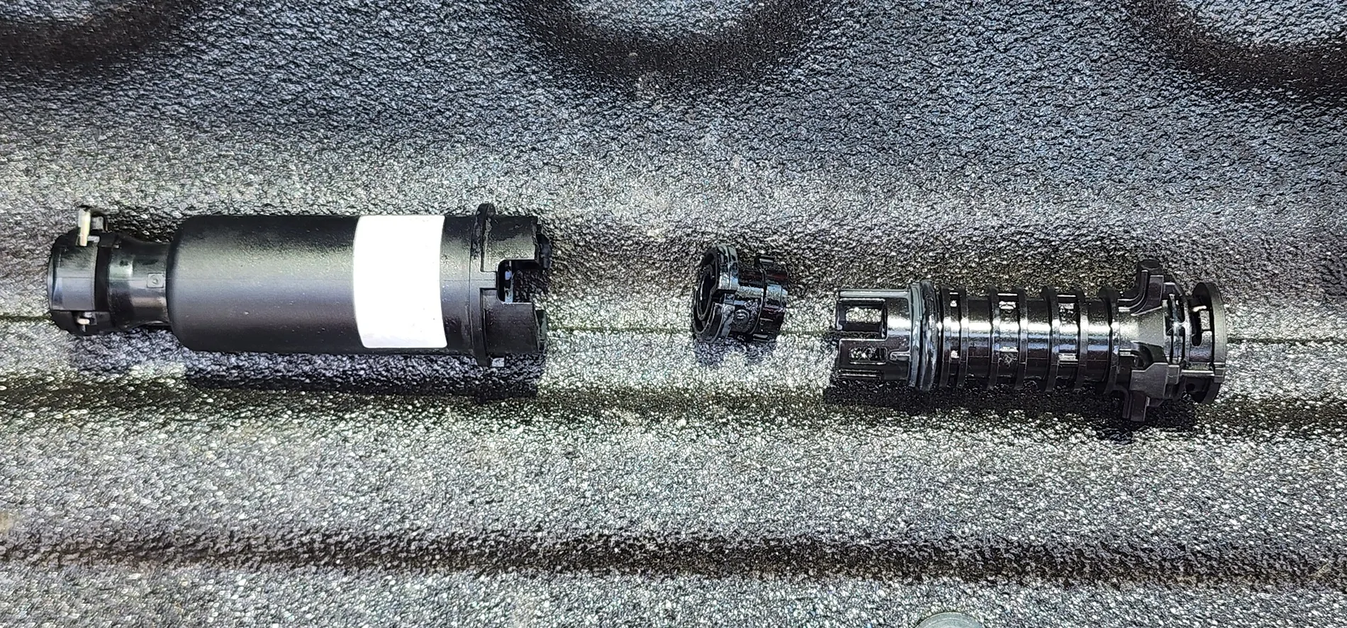

Here is a photo of the failed accumulator. There are 4 tabs that hold the body to the internal valve. All 4 tabs broke off allowing separation.
Enough failures have been observed that it could be more than isolated manufacturing defects. Open question to those more in the know...could these failures be high cycle fatigue? Possibly sourced from the vacuum assist? Are there any photos of the failure points/surfaces?
Here are a few pics of the failed part. There are 4 tabs that hold the body to the internal valve. The tabs broke off allowing full separation. I have ordered a new factory part, when I get it I will upload pics of the new complete piece.

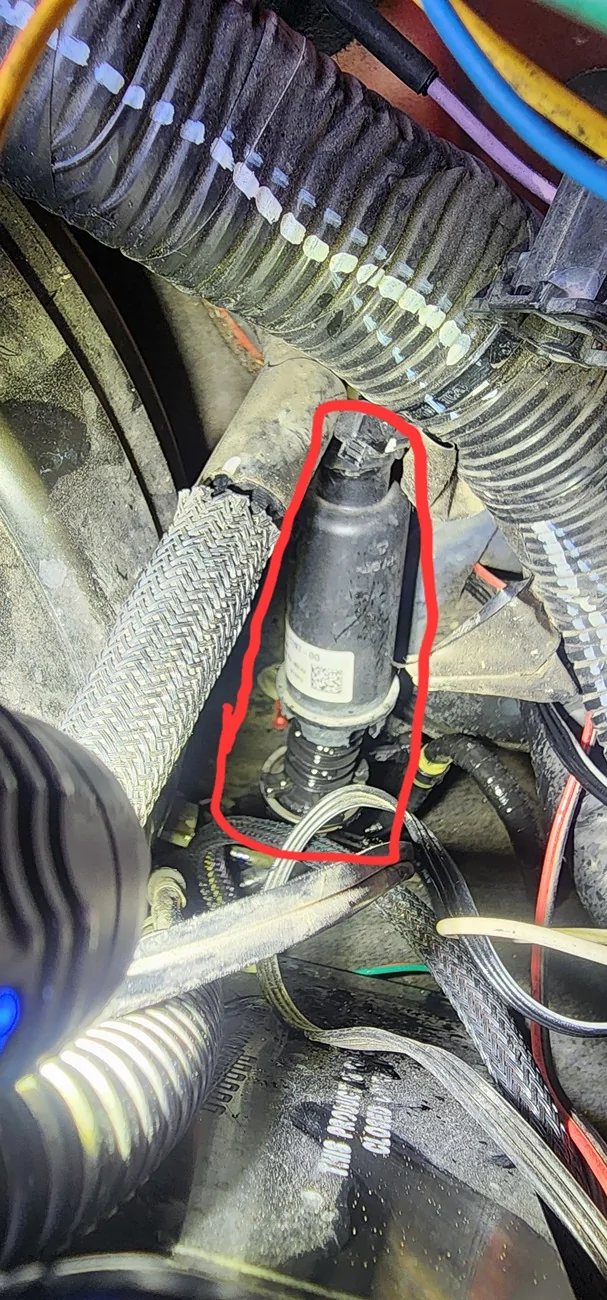

Unlikely, but any thoughts if the OEM part had some impact or stress at some point; from installing up-fitter wires closeby etc.

No, It's tucked right against the firewall, but honestly, this is a part that should be built to take abuse. Actuating the clutch, even in normal stop and go traffic puts an immense amount of stress on the hydraulic system, upwards of 350 to 500 psi. In reality, having a plastic pressure vessel that is constantly seeing 0psi-350psi-0psi-350psi over and over aging, and is exposed to extreme temperature fluctuations because of cold ambient air and under hood heat, is only a matter of time before the plastic degrades and fails, in my opinion.
