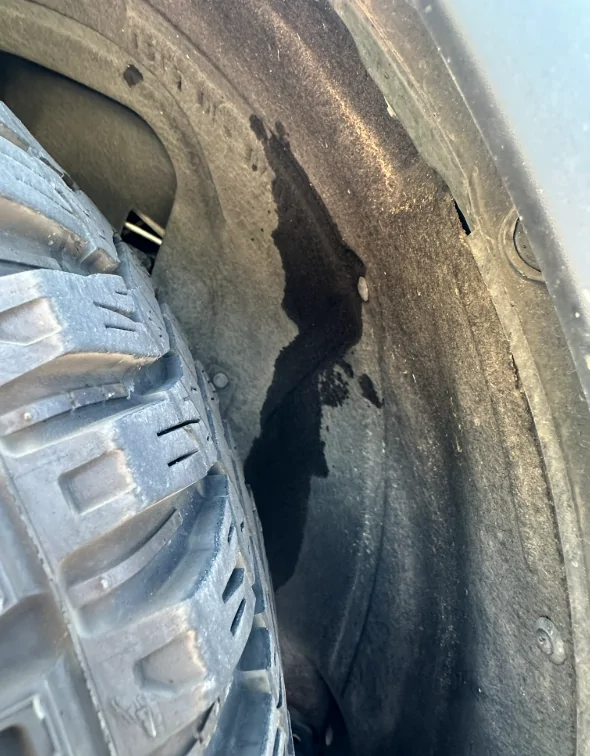

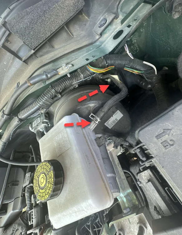

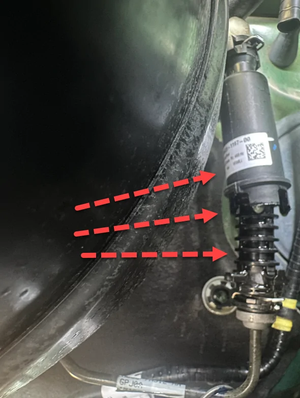

Yep, this happened to me today (09/13). Bruce has about 33k and some change on him. I got in the car and dead pedal. I popped the hood and found a popped valve from what I can muster and fluid everywhere. The valve is fed from the Brake Master Cylinder above and then down to the transmission. I gather this is not a part you want to fall apart like this while driving. I took a pic of the part (see below) and the brake master cylinder from above to show how much fluid it lost when the valve popped. It's been towed to the dealer and now I wait (without a loaner/rental) until it gets fixed in 2-3 weeks. Yep..... The dealership put me on a list for a loaner, but no dice so far. It's been an awesome experience so far.. :\
I took some photos of the faulty part. Ford needs to address this and fix. This is the first time that I have ever towed a Ford with less than 200,000 miles on it in 30 years of owning Ford's..

Yep, this happened to me today (09/13). Bruce has about 33k and some change on him. I got in the car and dead pedal. I popped the hood and found a popped clutch master cylinder and fluid everywhere. It's been towed to the dealer and now I wait until Monday to see what they say and then run up there for a loaner. Good times...
That sucks. No doubt. That said, given your past experience with Fords and the fact that my original post was more than a year old without any more alerts about this issue, I think these are super isolated incidents. This is not at all a chronic problem with the 7 MT. They fixed mine in about 2-3 weeks and gave me a rental, and I’ve been problem free with everything since this last repair.
That part looks chitzy as hell. It's not actually the master cylinder, looks to be a pedal assist or conditioner for 'feel'. the actual master cylinder is bolted to the pedal assy in the cabin. I wish there was better pictures of the inside of this piece to figure out what it is exactly. I'm scared mine will break and I'm wondering if its something that will be deleted (aftermarket repair) in the future. Thanks for sharing!
Yeah, the more I looked at the more I realized that is a horrible part and design. Also, there's a component under the dash that's connected to the pedal that is covered in bearing grease that really really should be in a sleeve of some sort. That was not pleasant to run my arm past when checking the pedal. I mean what the heck! That should be in a cover or something just because of getting dirt and crap in it..
