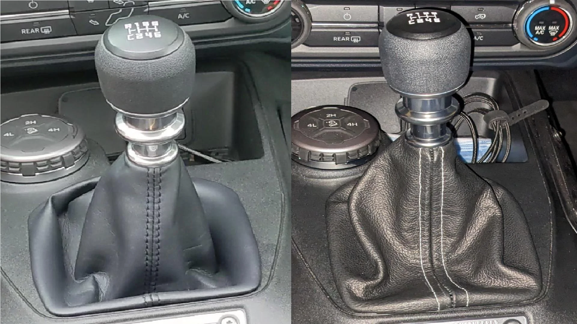

This was a difficult project. When I first started it many months ago, there weren't any vendors selling them. If I was replacing it now, I would probably just buy one from Redline. But, it was still a good experience. I just really like trying new things and pushing myself to learn and experiment.
Old on the left, new on the right:
Ford Bronco DIY custom stitched leather manual shift boot! Thum
If you want to see the entire process, linking here a full video:
If you just want to buy one from Redline or similar, the video will help you with the disassembly and reassembly process.
If you do want to give this a try, I can save you some time, check out the attached PDF file for the pattern from which you can cut the panels.
Let me know what you think!

What weight leather did you use?
Don't listen to jdc they can't see the difference between four-doors and Broncos
I actually thought it was pretty hilarious.
The Amazon listing says it is 1.2mm thick if that helps. I know you can buy thicker, but I was worried that it might not fit well between the plastic frame and the cutout in the panel where the boot assembles back in.

Nice, Tim! I love that you took on this project, along with your many others. I might tackle something down the line once I know what seat cover stitching I’m going to get for my covers. Have you looked for/found any shift knob replacements? I’d love to have a stainless steel or pool ball knob etched with a Bronco, but haven’t come across anything compatible.
Thanks! This is the best shift knob option I have seen so far. I am thinking about getting the white cue ball style.

From what I have seen there are three options for a replacement shift knob. I have the Boomba which came out first. It’s a nice round weighted knob that feels great. They also have a short shift kit.
B & M also makes a kit.
All these knobs seem to be higher than stock with B&M actually promoting this as a benefit. I’m hoping my Boomba Racing kit will lower it a bit.
