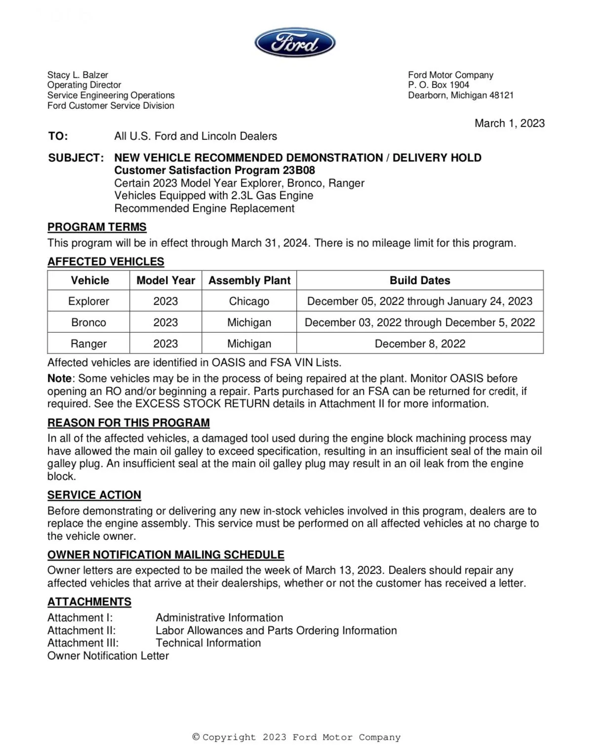

Very small build window for Bronco luckily, so I doubt very many are affected at all, but just thought I would share anyway.
For anyone looking to check to see if their 2.3 is affected, you can visit
https://www.ford.com/support/recalls
Ford Bronco Demo/Delivery Hold - Certain 2023 2.3L Broncos Recommended Engine Replacement (Build Dates Dec 3-5, 2022) ADA76F93-4302-4C86-BDE9-6021B4BCFA12

I read that first date range before I saw "Explorer" and "Chicago" and was like 😱

Well dang. Mine was started on Dec 2nd, build date Dec 3rd... Was up there a while before shipping, wonder if they fixed it or checked it.

'Full engine replacement'. What do you think was found that would warrant the entire engine to be replaced, and not just parts of the engine, even if its the entire short block assembly?

It explains what was wrong in the picture I posted. They could get away with just a short block replacement, but with how few are probably affected, it’s probably easier to just rectify the situation by replacing the whole engine for customer satisfaction.
