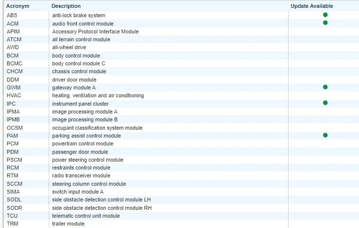

Hey @rugedraw can you see if some more updates have been pushing out?
The last one you mentioned said it was pushed to me, but I didn't get the notification of successful install in the vehicle for like 3-4 full days after you said it was pushed.

DON'T CRUSH MY HOPES!!! No seriously.. that sucks. On my commute I go by at least six spots where this would happen and it hasn't happened once in the past five trips.
Hey @rugedraw can you see if some more updates have been pushing out to VIN
This is what you show pending. Please remove your VIN from the post. Big brother is watching and I don't want them to deactivate my account again.
Thank you, VIN removed.
