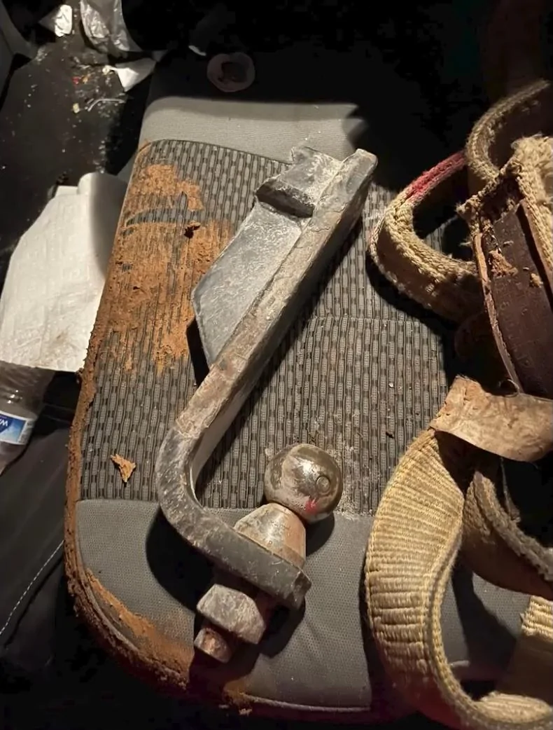

I remember seeing this when it first happened. Might have even made the news. Sad for sure this was a guy using a tow ball trying to pull out a superduty. If your going to use a hitch insert for recovery may sure it made for that purpose.

I recall seeing this on the news a couple of months ago. The tow rig DID in fact connect the strap to his tow ball. Given the weight of a superduty (7,500+ lbs) and the suction power of the mud, the ball shank never stood a chance. This was a sad, but avoidable tragedy. Tow balls are rated for trailers with wheels on hard surfaces, accelerating slowly, not for a hard shock load like that one was exposed to.
As `21OBX said, only use your hitch for recovery with a proper insert. NEVER, EVER use a tow ball as a strap point.

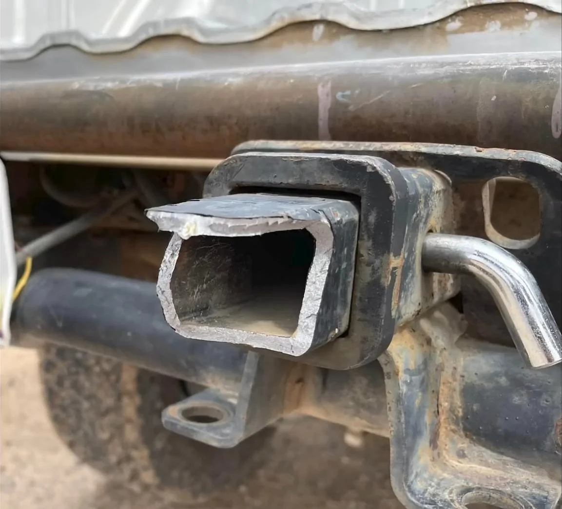

The ball shank did not fail. The drop hitch tube failed a few inches outside of the receiver due to the high torsional bending load at the end of the gusset reinforcement (see photos below).

I believe it was a massive drop hitch. Leverage is a bitch.
