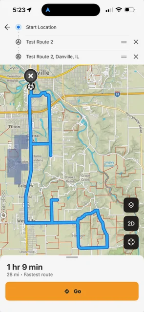

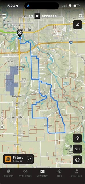

Good evening. I have a question for anyone familiar with OnX Offroad app. I have made a couple test routes using my desktop computer. When opening the routes on my iPhone via the app and choosing "Navigate" the route changes to "Fastest Route" and doesn't follow the manual path I created. Any ideas why this is happening? A setting maybe or am I just creating the route wrong lol? Any help or suggestions are much appreciated.

I am creating the routes using the "snap to" setting. I manually created a route just to check the functionality of the app and it's not following the route I created. It wants to take shortcuts "fastest route" lol.

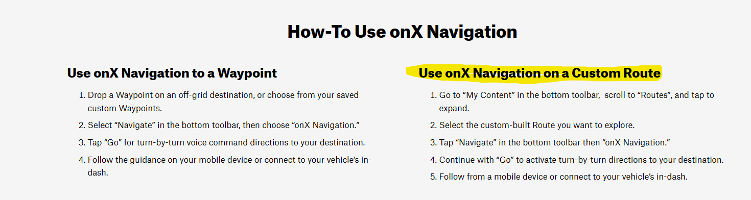

Navigation doesn’t follow custom routes. It follows its own route based upon whatever algorithm OnX is using
If you want to follow your own custom route, you will have to do it manually, without turn-by-turn guidance

Ok that makes sense. Appreciate the feedback. I'm new to the app and was wondering what it was doing. Thanks again
***Found this on their website
Ford Bronco OnX offroad Fastest Route Issue 1770082732491-f9

Here is a video showing what's happening in the app. You can see the custom route I created. When I choose to navigate the route, the directions go bonkers lol.
