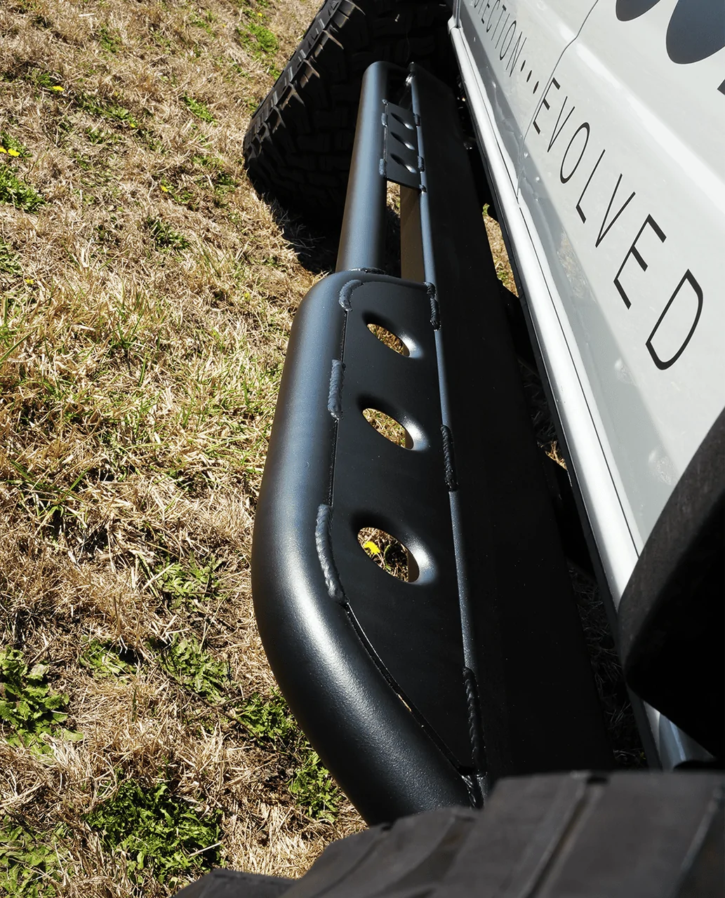

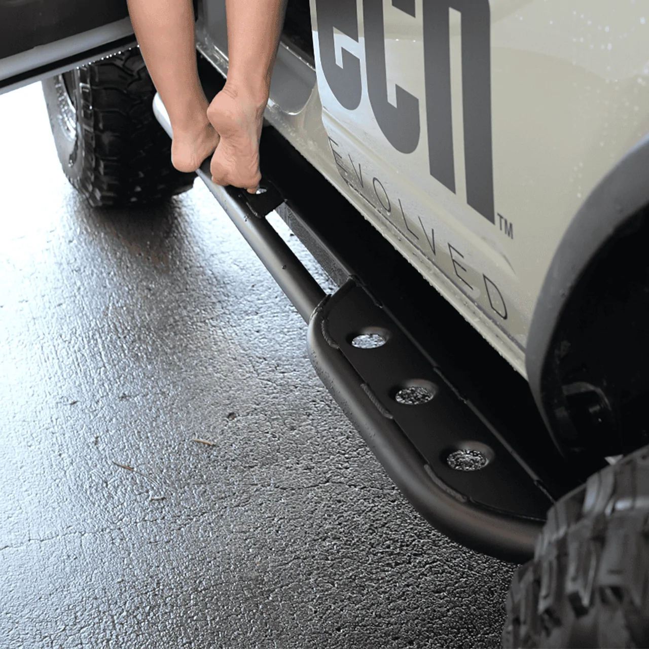

"Urban protection" just sold a bunch more units :ROFLMAO:
I know right! But when we have aluminum door panels, putting steel out first to take the hit, well it just works.
More of a by product of proper offroad sliders (that protect the radius of the doors, not just the door rockers). About every other month we get photos or a call from customers where they found a little white smudge on their sliders, then a decent round ding in the edge of the door of the car parked next to them.

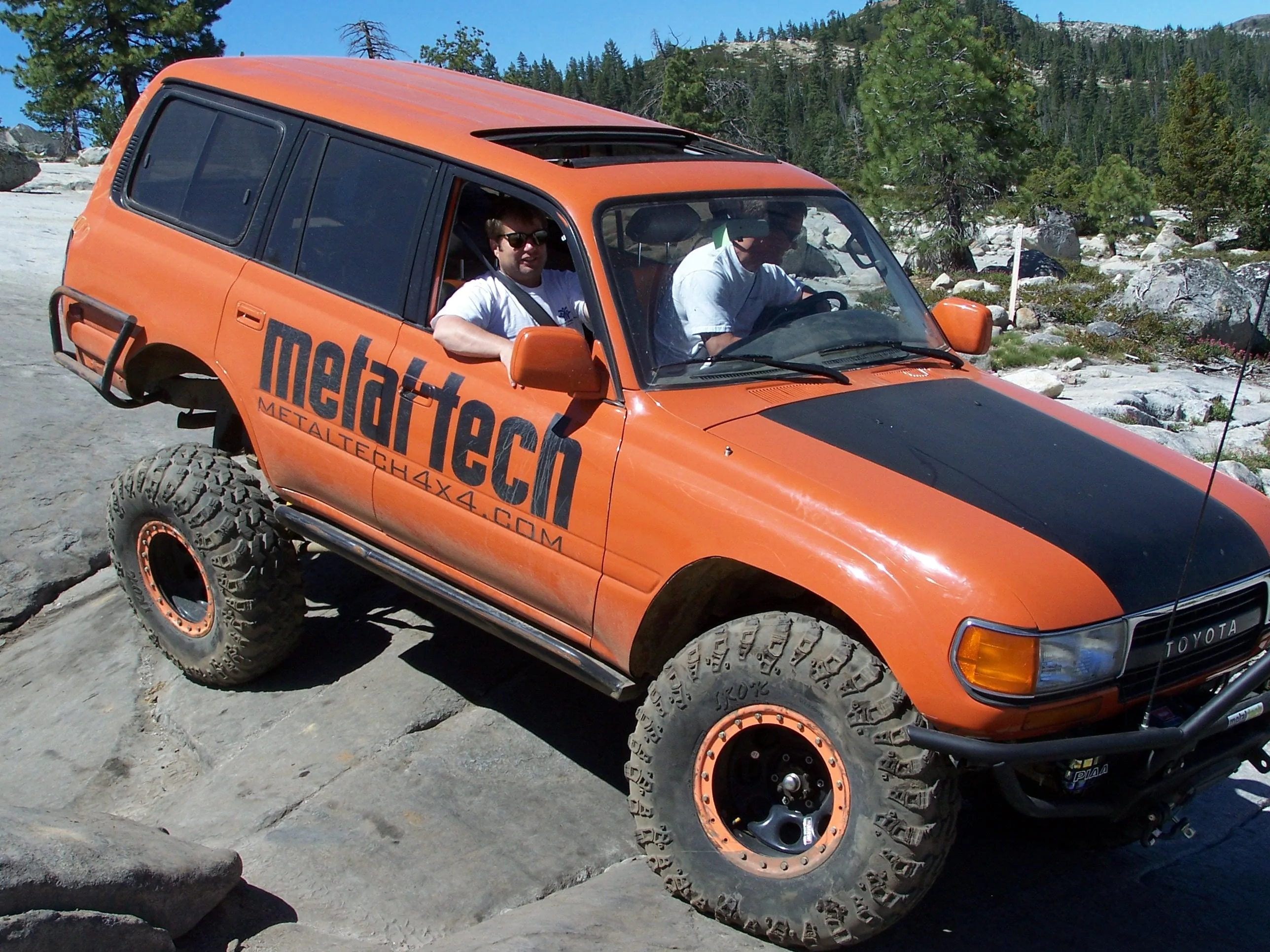

As for U-Bolts, Metal-tech 4x4 has been building sliders for over 20yrs. Back in 2003 is when we did our first U-Bolt solution for sliders on the 80 Series Landcruisers. Most of these are 7k lbs trucks running the Rubicon and such for the past 19+yrs. Hundreds of sets of sliders built and sold, never had anyone breaking a U-bolt. It took to 2010 before we ever had anyone actually bend a main body of one of our sliders! (Thanks CHAD! he is proud of it too) But never had a moutnings system issue.
We build our 6 Gen Bronco U-bolt mounts exactly the same as we do on 80 and 100 Series Landcruisers. Just like this one running the Rubicon back in 08'ish. You can almost see the U-bolt mounts in this shot.
Ford Bronco Frame Mounted Step Sliders - Now shipping from Metal-tech 4x4 101_2290

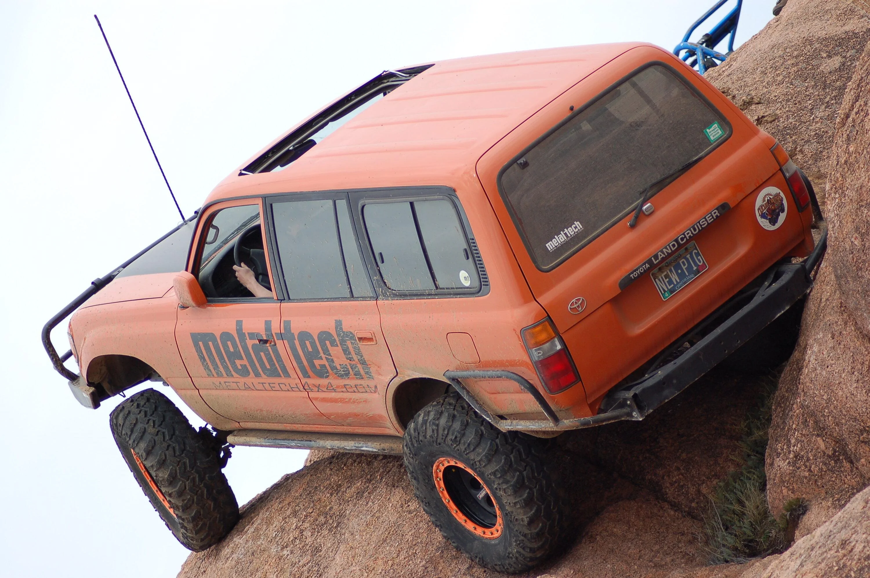

Todd K. And Petter B. guests from North Carolina and Kentucky flew out and drove the Metal-tech 4x4 Landcruiser across the Rubicon in these photos. U-bolt mounted sliders, drivers side is 100% U bolts only. This truck and a few hundred others are still running trails today with the same sliders!
Ford Bronco Frame Mounted Step Sliders - Now shipping from Metal-tech 4x4 101_2278

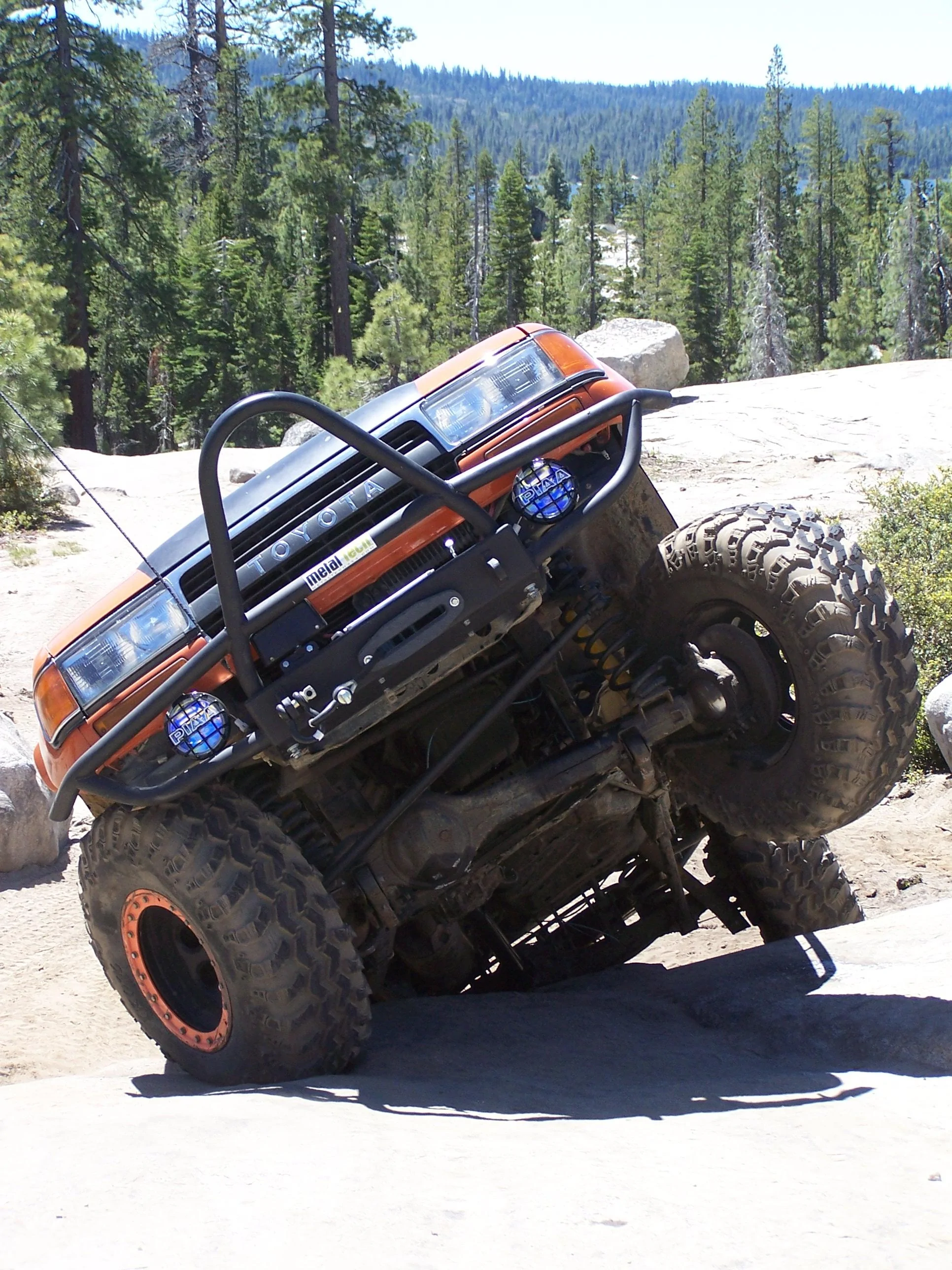

Get what your saying 100% on one thinking there is a loss of clearance-performance with this mount. Yet when we leave the internet and drive onto real trails, the performance speaks for itself.
To build cheaper? Actually that is flat plates and drilling templates. But unfortunately the Bronco frame being large in size is fairly thin, bolting in any area that is not reinforced is not a good idea. (We do a through bolt above the transmission cross support, but that is reinforced part of the frame for clear reasons) No cost savings is not the drive for a custom manufactured u bolt system. Proven actual real world performance with simulare weight, frame and size is.
Little wheeling with our friends in TX. Same U-bolt system. Proven.
Ford Bronco Frame Mounted Step Sliders - Now shipping from Metal-tech 4x4 DSC_0043
