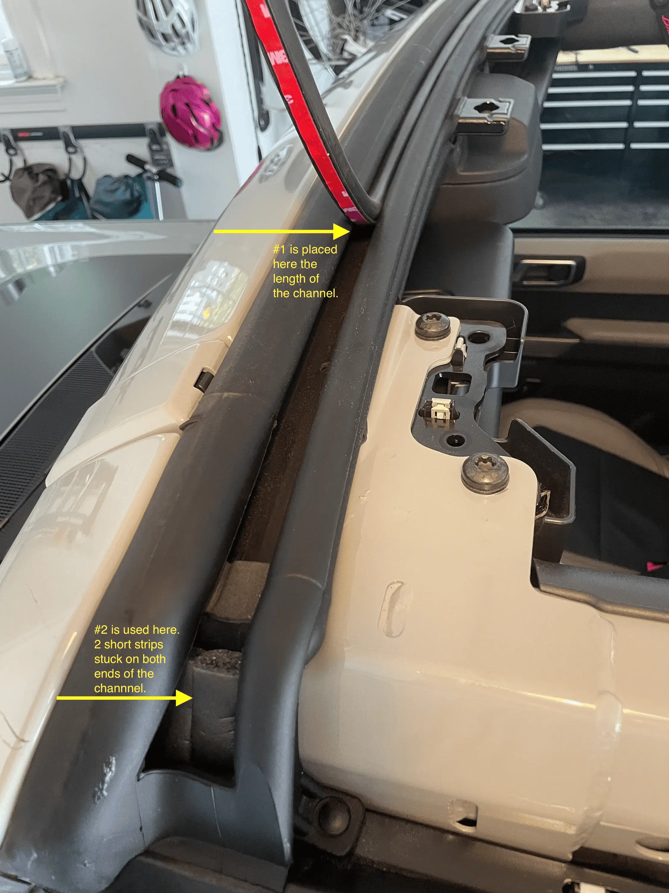

Windshield
  • In the front channel, adhere #1 in the Grocery List inside the full length of the channel.
  • Cut 4 short strips of #2 and stick them 2 each, side by side, vertically in the ends of the channel.
  • All of this is hidden with the top on. With the top off, it will either look factory installed or like a small kid used the scissors if you don't cut straight. I have both results.
Ford Bronco MIC Noise Reduction Guide - wind sound- aka more (or less) cowbell please Windshield

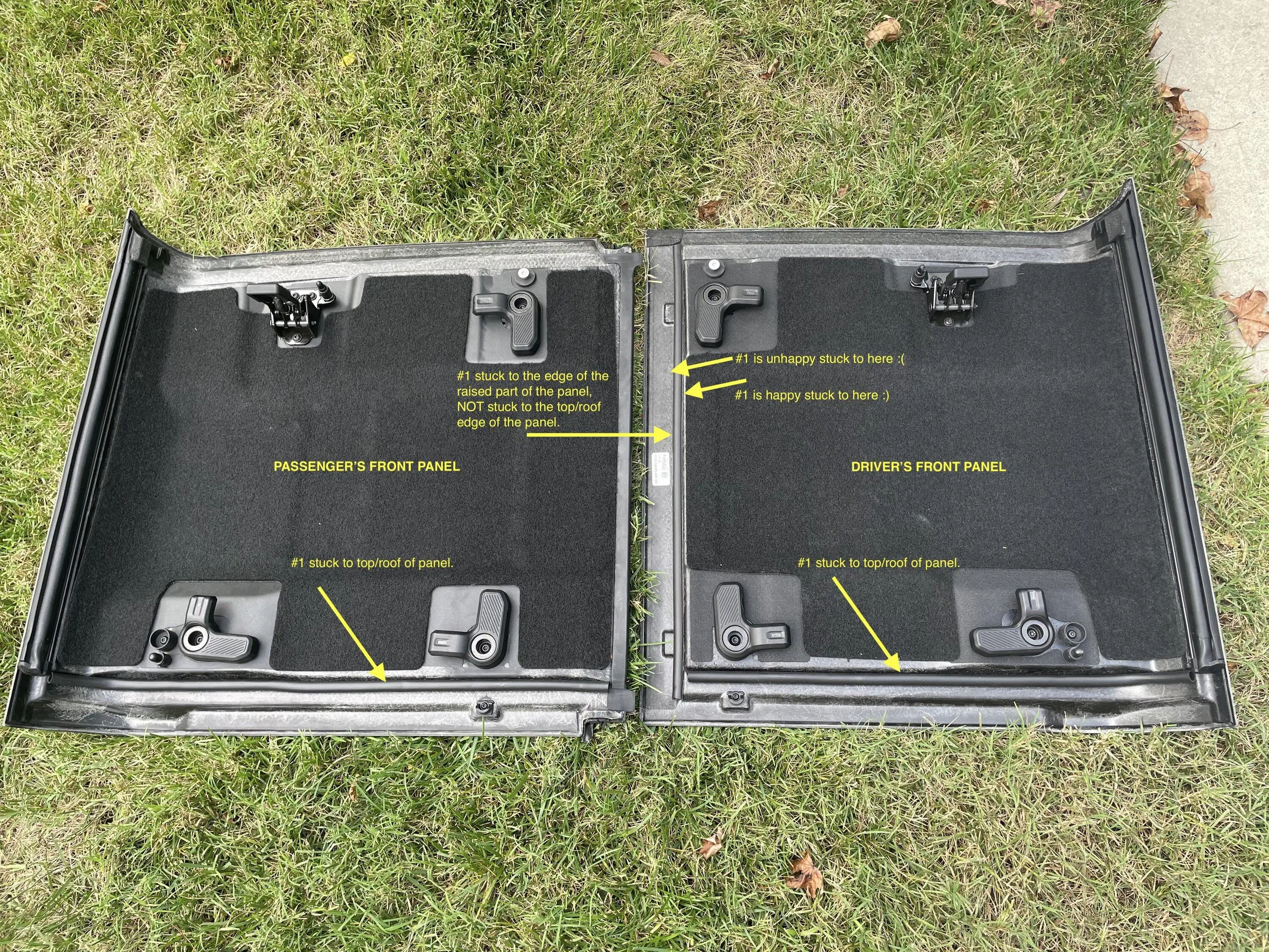

Front Panels
  • Use the #1 stripping for all of these.
  • Primary guidance is to adhere the middle strip that goes on the Driver’s Front Panel to the slightly raised portion of the roof. Don’t adhere it to the top/roof section as it won’t allow the panel to close enough. It also makes for a cleaner look if you install on the raised portion.
  • The two strips that face the windshield are not visible. The strip that runs between the two panels is minimally visible.
Ford Bronco MIC Noise Reduction Guide - wind sound- aka more (or less) cowbell please Front Panels

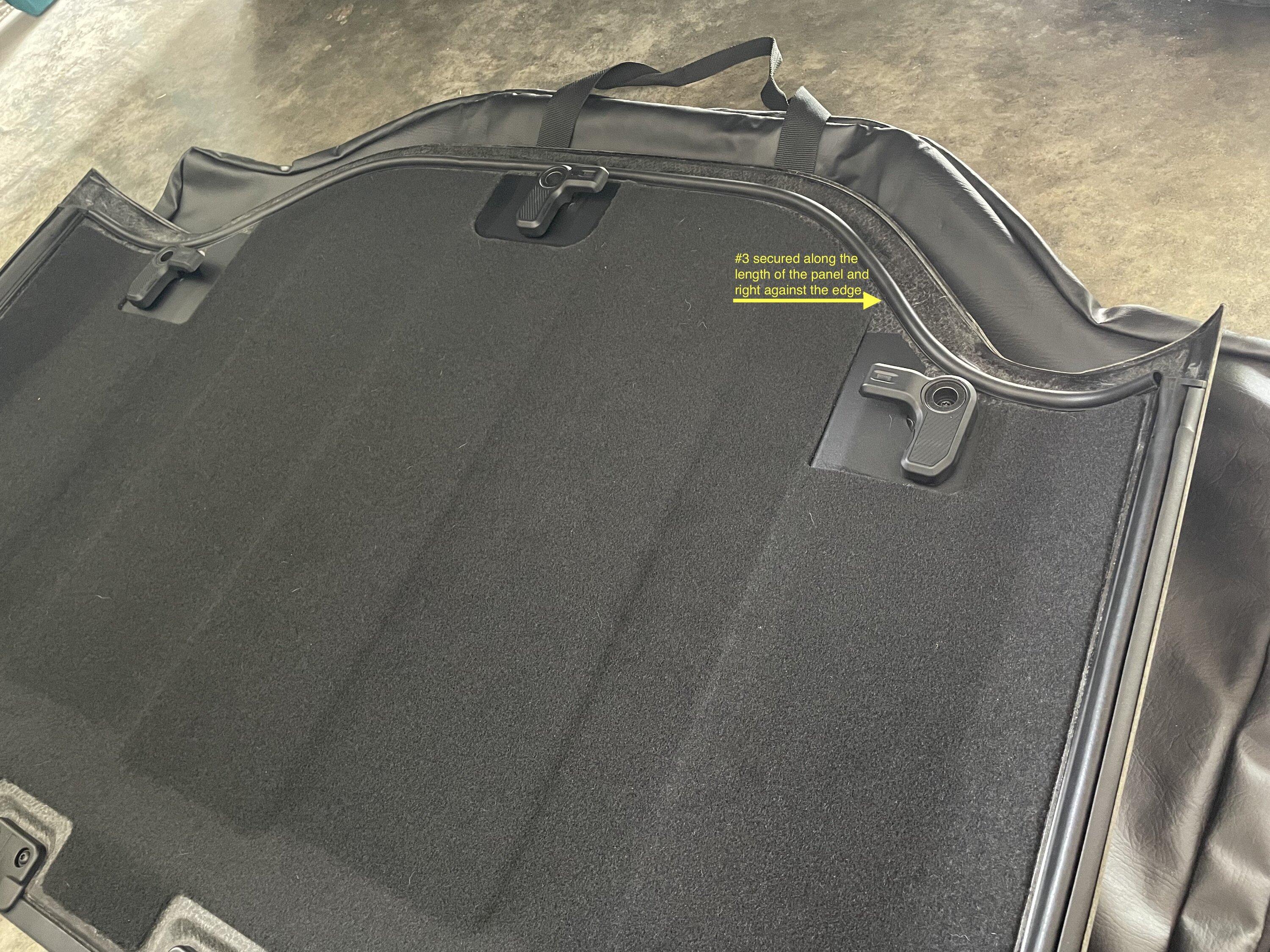

Mid Panel
  • Secure #3 along the length of the mid panel. This is the curved side of the panel that faces towards the back.
  • Snuggle the stripping right along the edge and you'll look like a pro. This is visible from the inside once installed.
  • Super easy, right?
Ford Bronco MIC Noise Reduction Guide - wind sound- aka more (or less) cowbell please Mid Panel

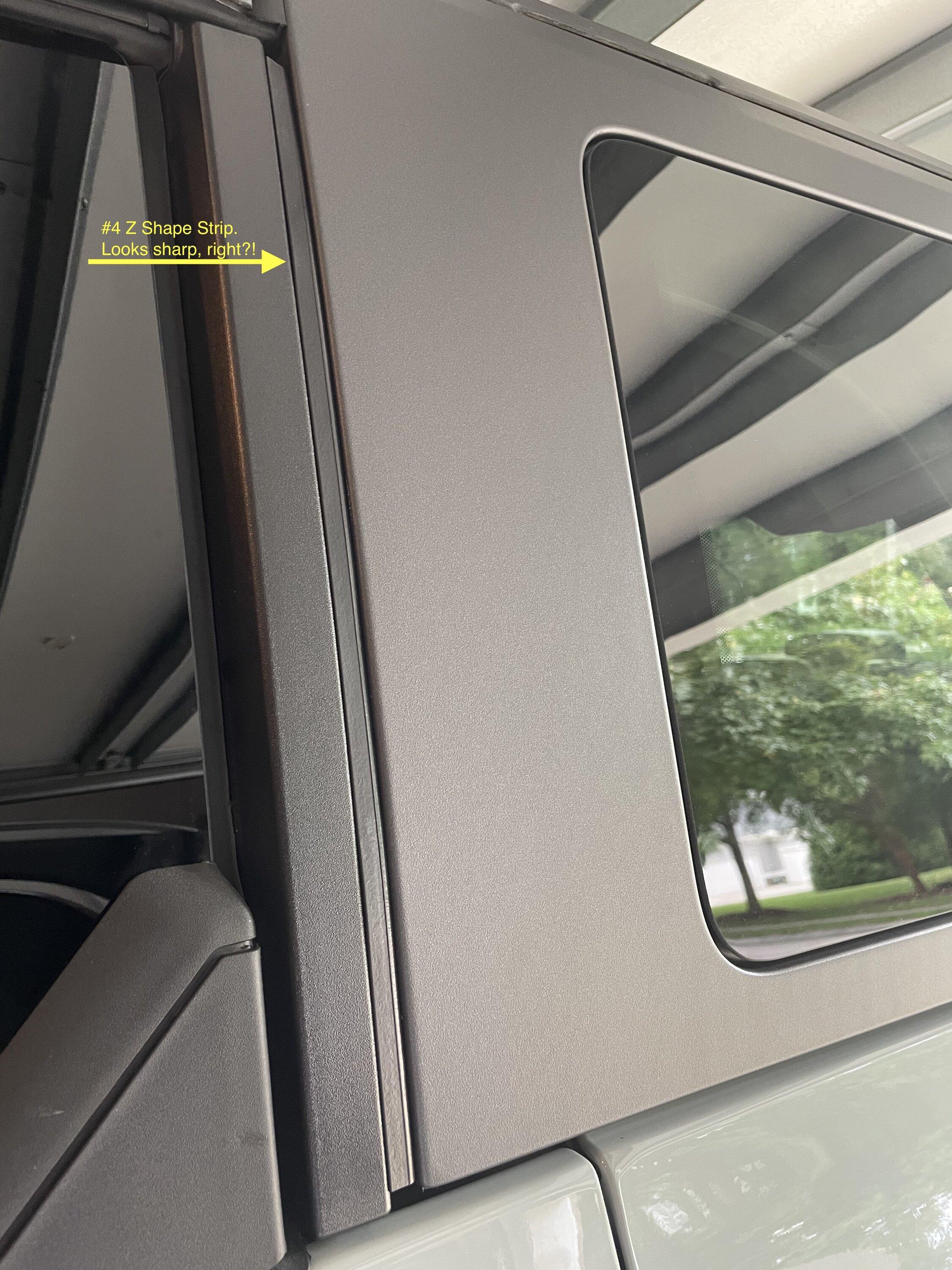

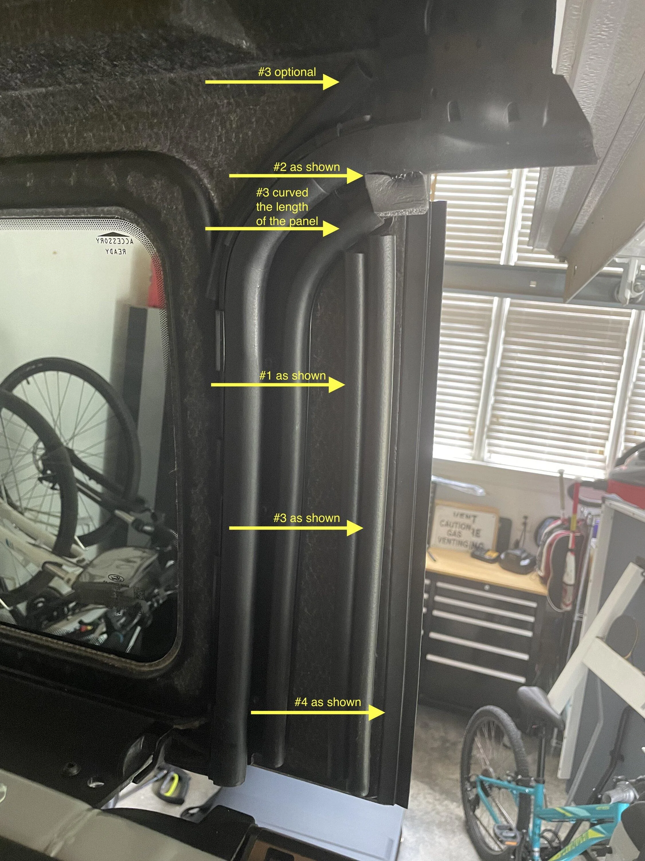

Rear Panel
  • This is the fun one and makes a big sound impact!
  • The picture is probably the best explanation of what goes where.
  • I'm not sure if the top most #3 install is needed- and I forgot to take another picture of it properly adhered. It basically curves along a small section on top. I had some extra stripping, so I used it.
  • The small square of #2 goes on top of a similar, but thinner material that Ford already has in that same place.
  • The Z Shape #4 is great stuff, and I think makes the exterior even look a little sleek (no one ever described a Bronco as sleek, right?). I'd measure this one and cut accordingly- I did 15.5". Adhere it right along the edge of the panel. This helps with wind noise by sealing the gap between the frame of the Bronco and the rear panel.
  • This is not visible except for #4 (Z Shape stripping).
Interior View:
Ford Bronco MIC Noise Reduction Guide - wind sound- aka more (or less) cowbell please Rear Panel
Exterior View:
Ford Bronco MIC Noise Reduction Guide - wind sound- aka more (or less) cowbell please Rear Panel Exterior

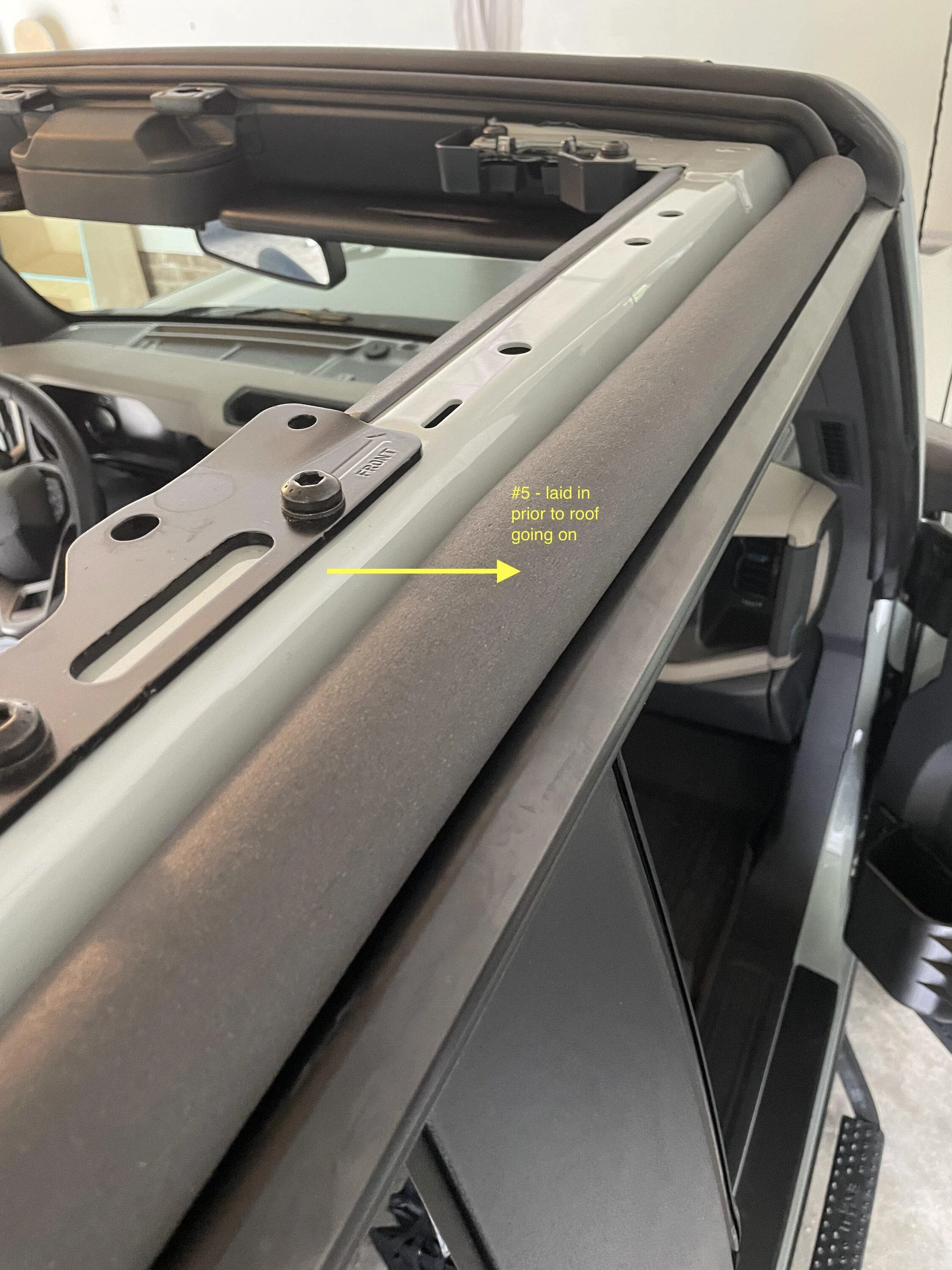

To Pool Noodle or to Wrap Your Pipe
  • I saw various opinions on which material worked best, which ones disintegrated in the elements, how to secure, etc.
  • I decided to use the rubber Armacell pipe wrap - #5 on the Grocery List. It comes in a 6’ length, and I left it as-is.
  • I peeled off the self-adhering tape and stuck it to itself.
  • Rather than figure out how to secure it with the top off and/or how to not make it look bad… I decided I’d simply lay it in the roof gutter when I put the hard top on. Otherwise, it will sit in storage in my garage if the top is off.
  • We’ll see if it lasts- easy and inexpensive to replace.
Ford Bronco MIC Noise Reduction Guide - wind sound- aka more (or less) cowbell please Armacell Rubber
