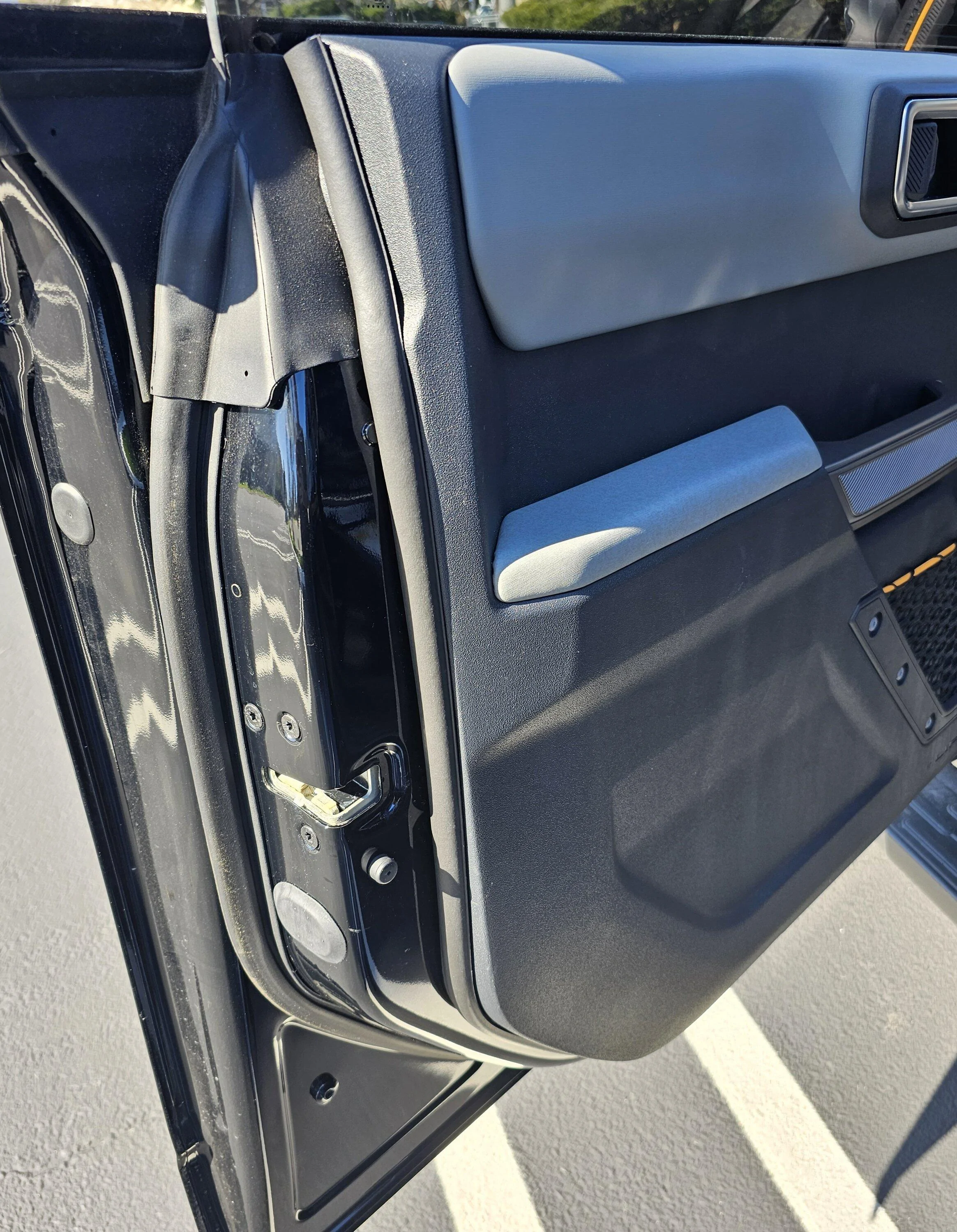

Driver door:
McMaster 93085K525 on the plastic door trim. Worked well but I'd probably put it on the body channel if I did it again

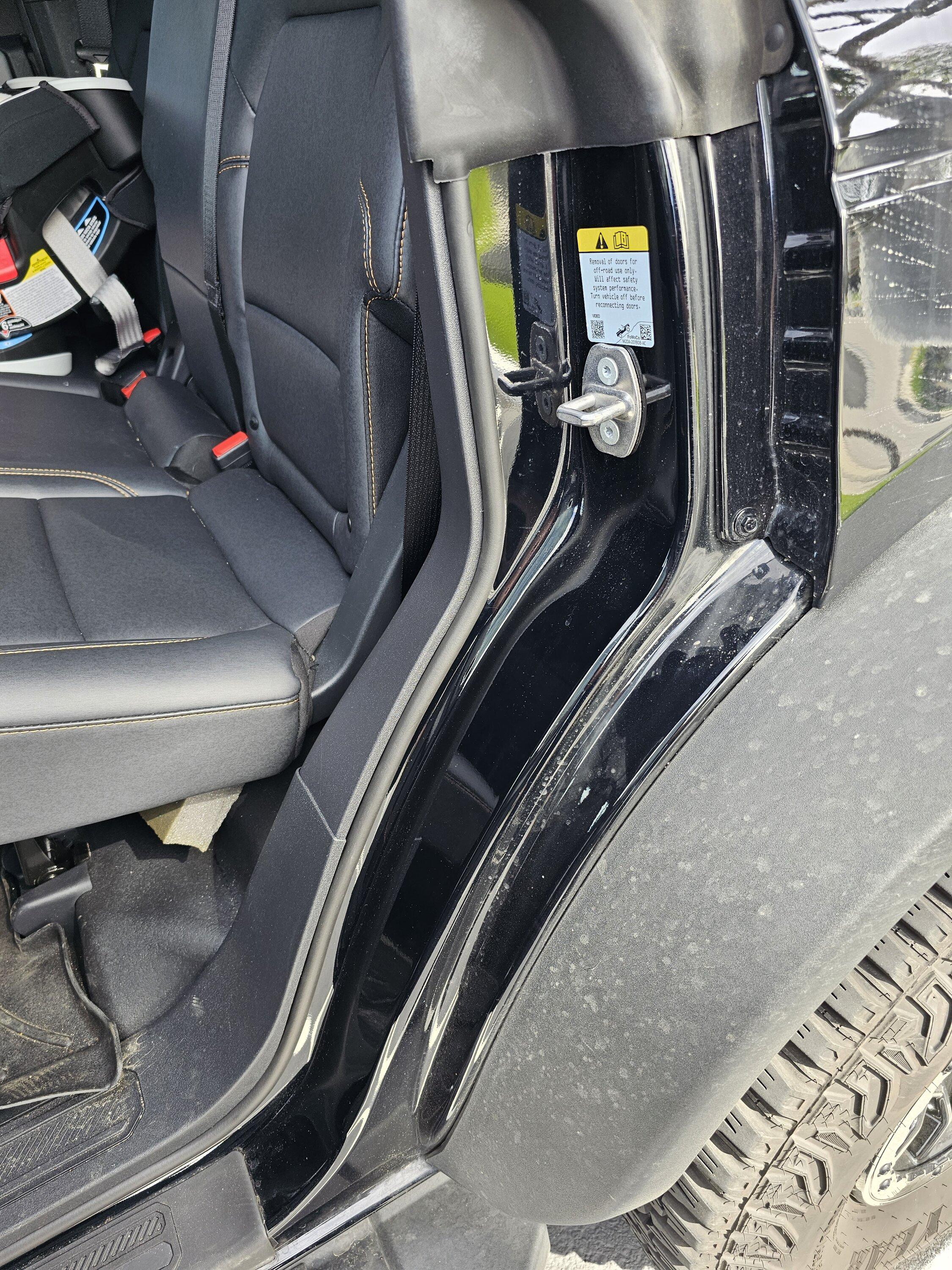

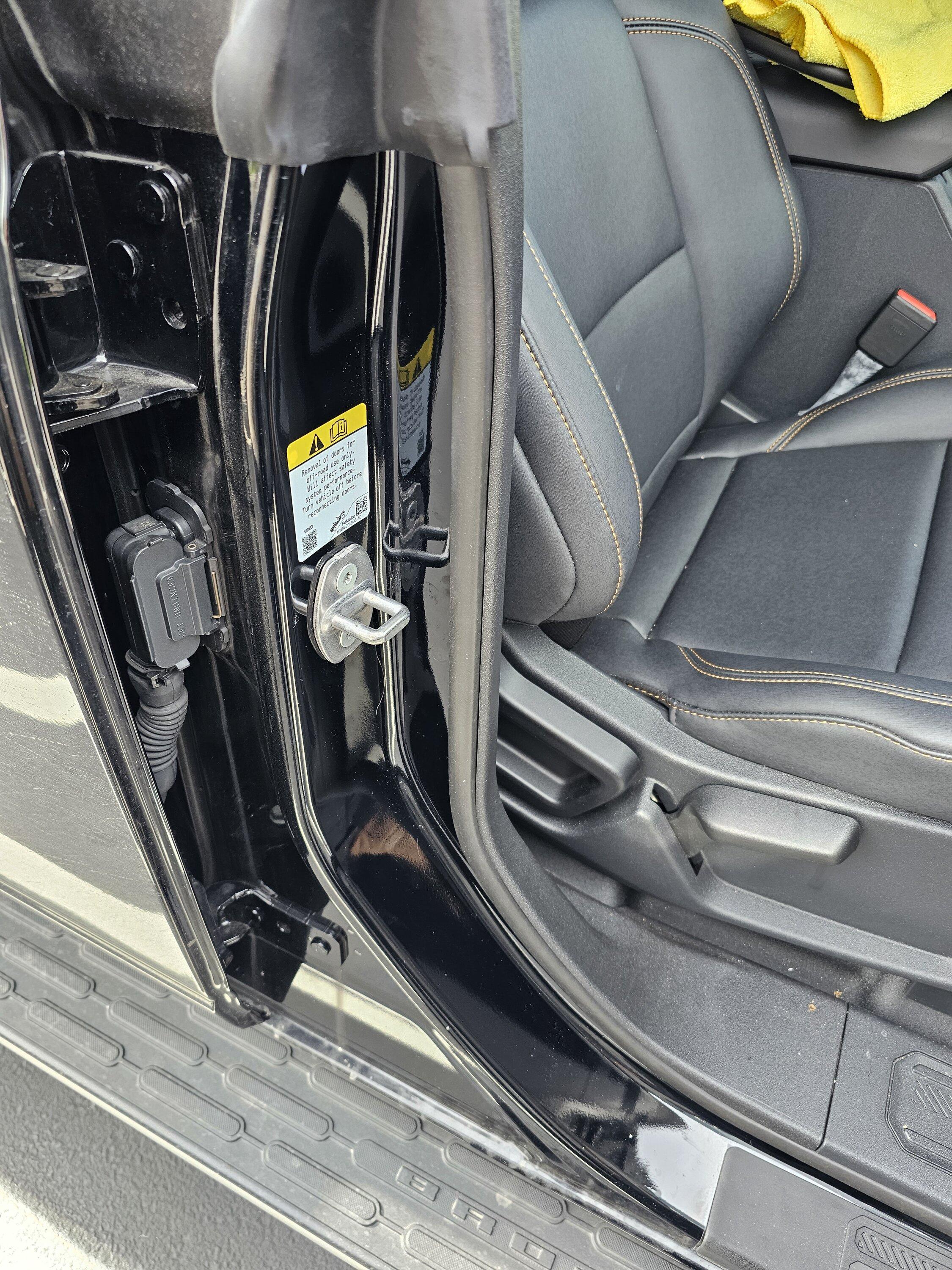

McMaster 93085K393 on the body channel. Works well and looks the best imo. Has a good seal on the door

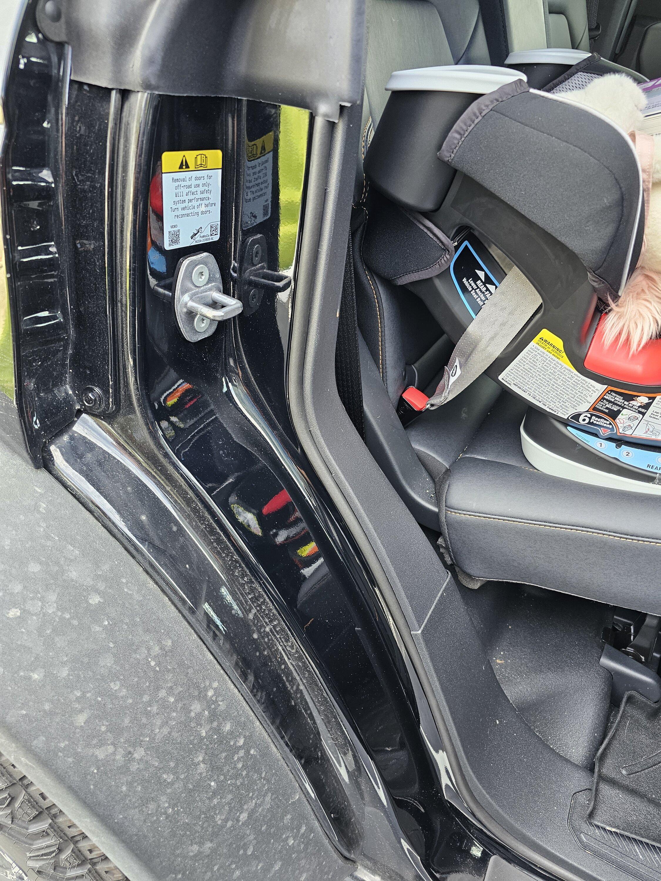

McMaster 93085K556 on the body channel. Works well and had the best seal on the door

McMaster 93085K52 on the body channel. Worked well but the seal could be better

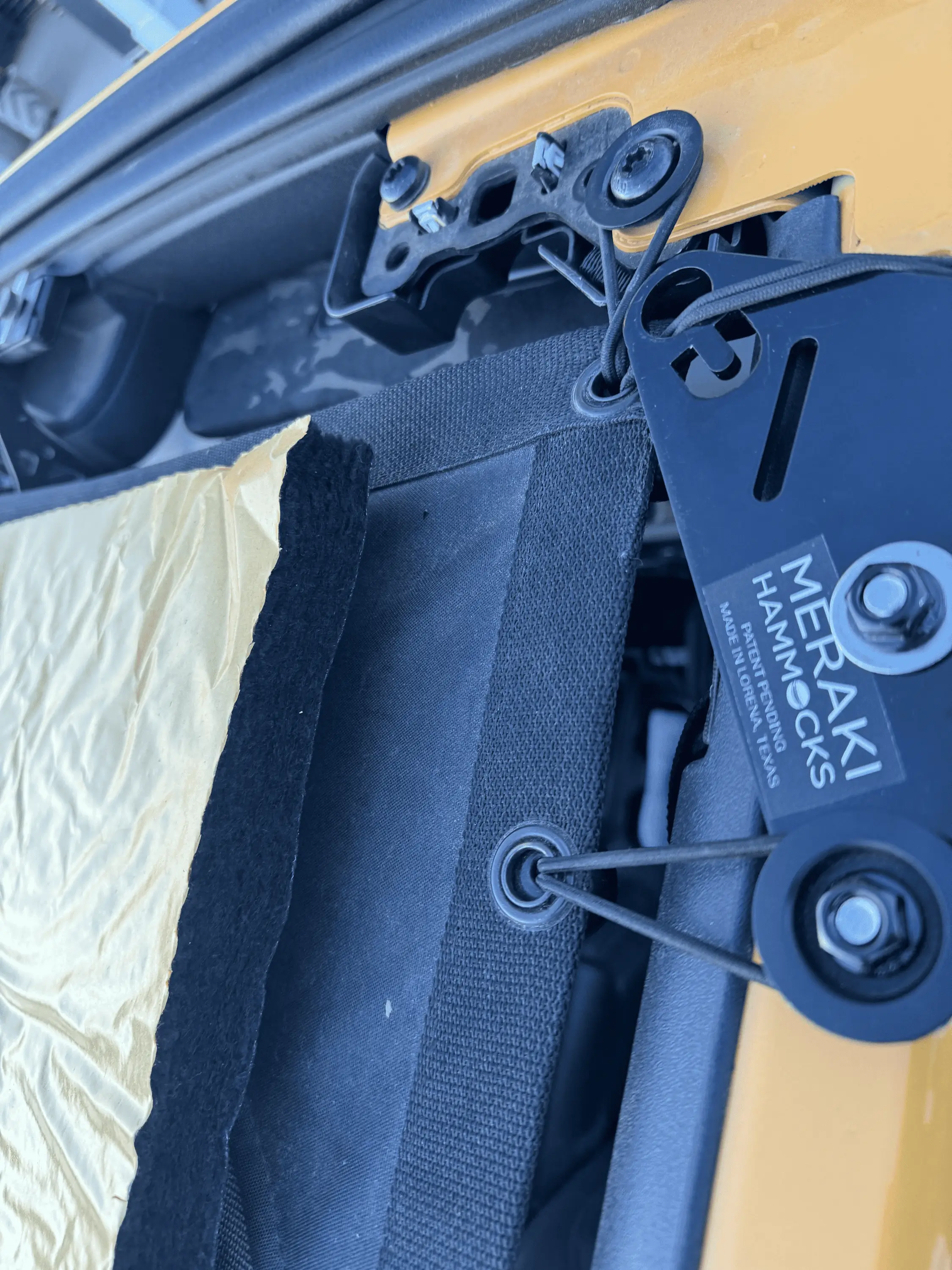

My original intent was to 100% do everything in the sound deadening thread - I really only did 2 things and it made massive improvements.
For the weatherstripping - I messed up and originally only bought 10 feet - which wasn't enough. Ended up buying another role of 20 feet - used about ~24-26 ft.
Kaixuan Automotive Universal D-Shape Door Seal 0.47" Height X 0.55" Width Weather Stripping EPDM Rubber Seal Strip Self Adhesive Car Truck Door Window Soundproof Noise Insulation Sealing
Only complaint is some of the adhesive on the ends was not holding, but as it is sandwiched in the door most of its life, the one time I noticed it not sticking, I put the end back in place and just shut the door. Haven't noticed it displace since.
I have a soft top, with a Gear shade, and living north of I80, the top is up all winter. Bought one of these and put it between the gearshade and the soft top - did not remove the adhesive - its just free floating on top of the gear shade --
Dynamat DynaCore Thermo-Acoustic Fiber Heat- and noise-absorbing liner — 32" x 54", 12 square feet (1" thick)
That sucks up a lot of the echo from the back, I can now listen to radio on volume 4-6 very comfortably at 55mph + on windy days.
Partially in this picture when I was installing my @Meraki Hammocks mounts:

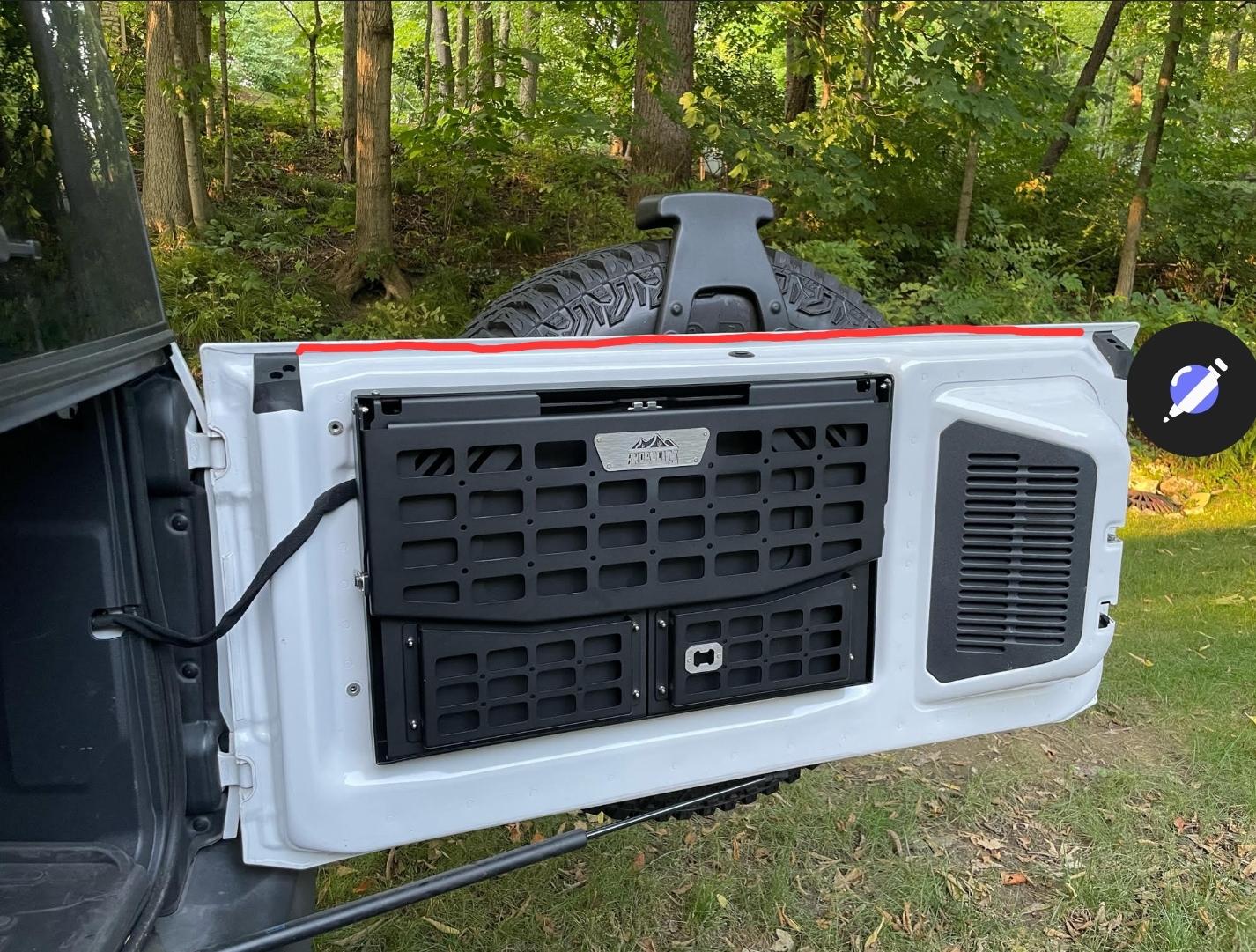

I ended up ordering and adding 93085K556 to the rest of the doors except the front passenger door, which I left as 93085K393. Main reason why I did that is because that door already takes more effort to close than the rest, so I didn't want to risk making it harder. Plus it looks pretty good already.
The seal of the doors that I added 93085K556 is better than it was before, and it doesn't seem to affect closing. You'll probably need more than 20ft for all 4 doors, though.
Also, since you probably have some leftover from the MIC wind noise guide, I also added a strip of 93085K525 to the top of my tailgate to help with the rubber creaking noises. All of the weatherstripping I added definitely makes everything sound more solid.

Sounds good, I ordered a lot of the 93085K556 so I should have more than enough.
I didn't think of adding anything to the tailgate though, that's a great idea! I'll make sure to try that out. Thanks!
Not my original pic but I put the weatherstripping here in between the two larger rubber pieces. I didn't want to go over those rubber pieces so it doesn't put too much pressure on the rear glass.
