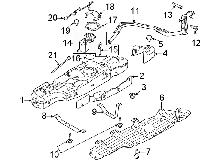

Very strange that the majority of trail failures have been at 3/4 full or more and going down hill. Looking at the diagram the pick up tube #21 points to the front of the vehicle which would still draw fuel when going downhill.
