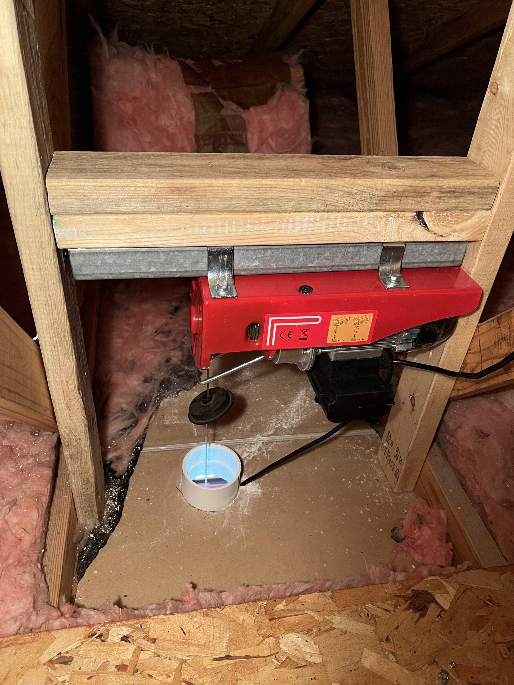

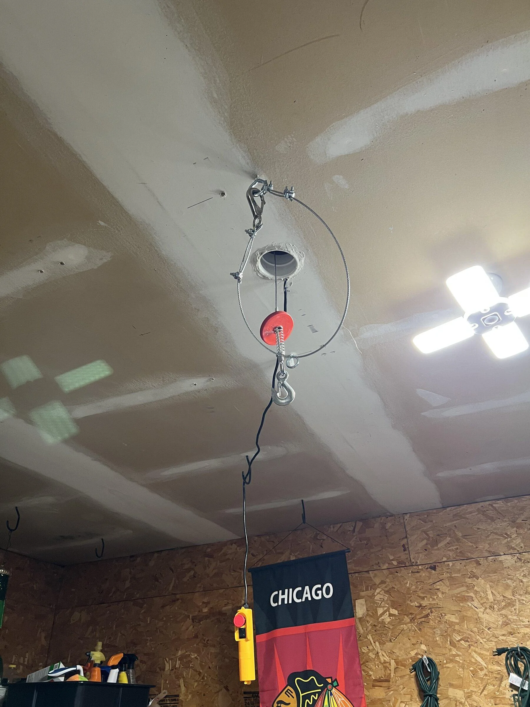

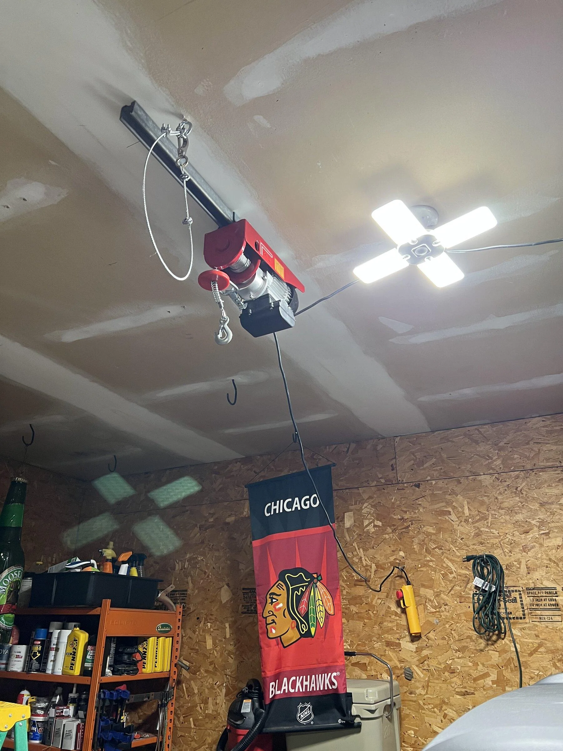

Just wanted to share my experience I had with installing my “homemade” hard top hoist. I ran into a few problems so I thought id make a short thread to help others who have the same agenda as me. A somewhat cheap lift that’s quick and easy.
i ordered an $80 electric Hoist on amazon and a couple 10’ Straps for $30. The rest of the stuff I used I had laying around my shop at work.
i originally mounted it on the ceiling of my garage. It would have worked fine but it was too low for my liking. I wanted my bronco to easily fit underneath with no worries about hitting The top when I backed in so I ended up mounting it in the attic. It gave me the height I needed and looked cleaner as well.

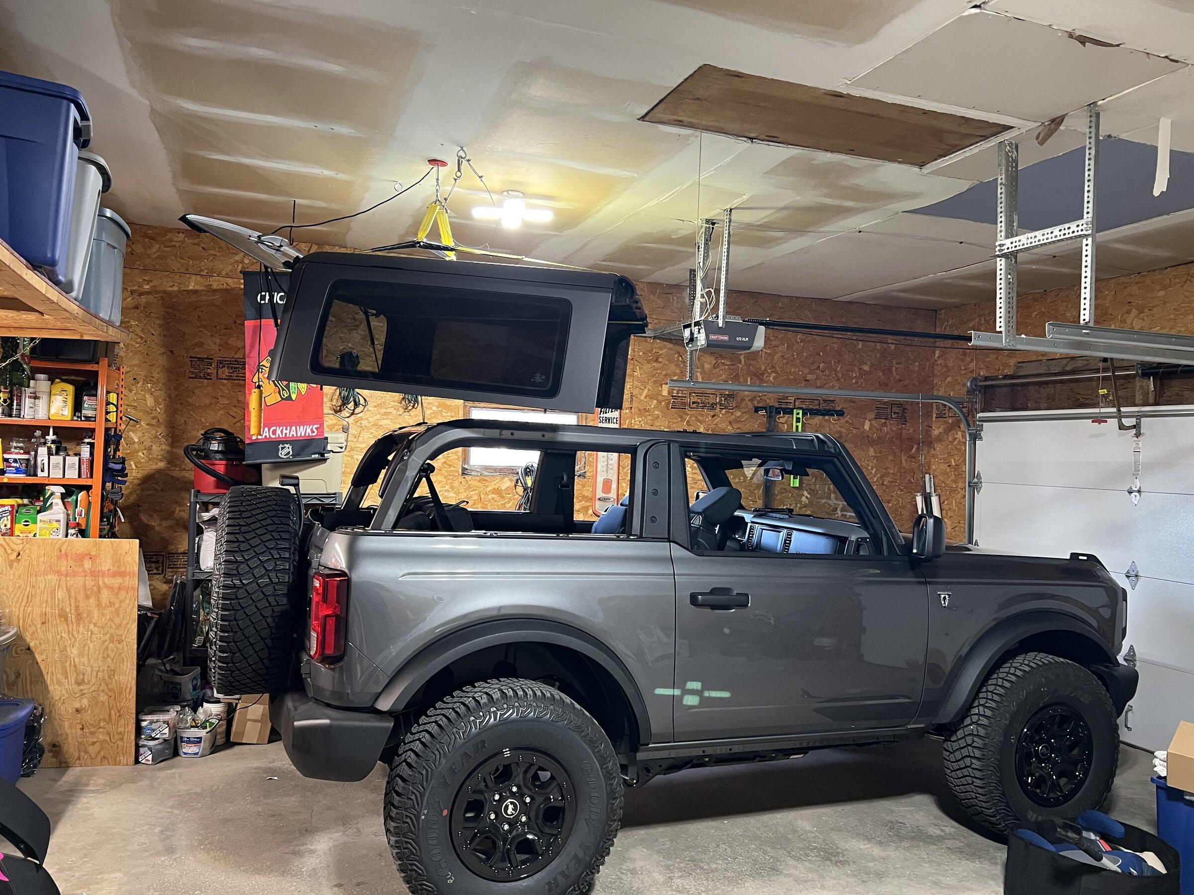

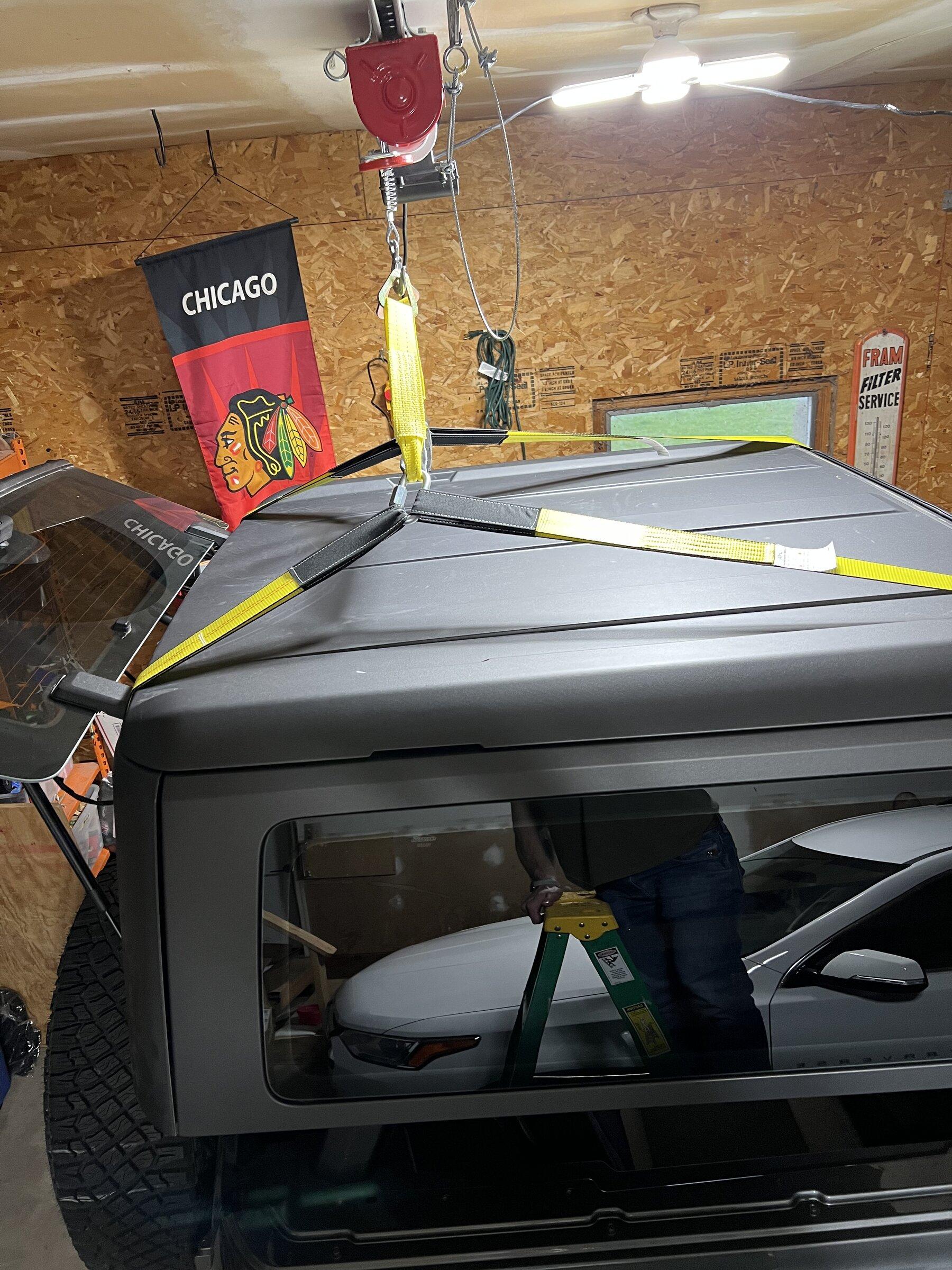

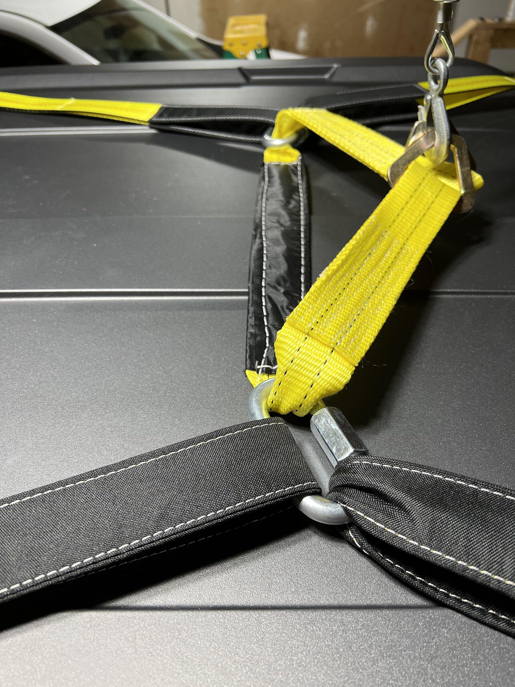

my main point of this thread is the lifting part. With a single point lift like this it’s critical that you find the balance point of the top. I found out the hard way the first time I lifted the top off lol. It was all over the place. I attached some pictures to show the balance point of the two door top. I’m sure the four door will be different.
in the end it all worked out great. I’ve practiced a couple times and It takes about 20 min are so to remove the top. Im sure I’ll cut that time down once get more accustomed to the system. Reinstalling is fairly simple as well. I don’t even have to really worry about getting the bronco perfectly centered as there’s plenty of swing with the lift set up the way it is. I just lower slowly and line the pins up and it falls right Into place.
anyway I hope this helps anyone hoping to have a nice lift and not spend $500-$600. It’s fairly simple but hey it works! And for about $100 you can’t beat it.

Are you able to move the hoist with the bar that’s attached to it?
There is a system with rollers and that channel you can use to move the hoist around if need be. Mine is fixed though.
