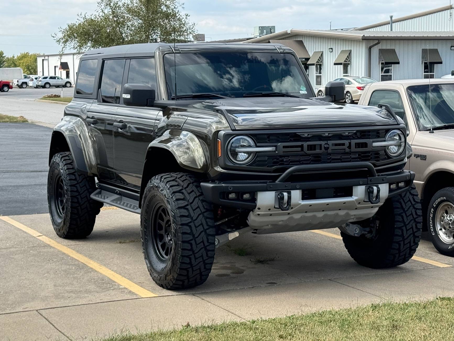

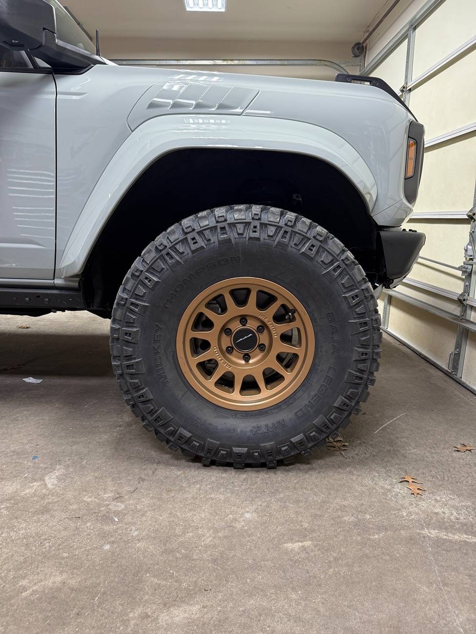

I am running MT 37x13.5 on 0 offset 8.5 wheels. I am super happy with the setup.

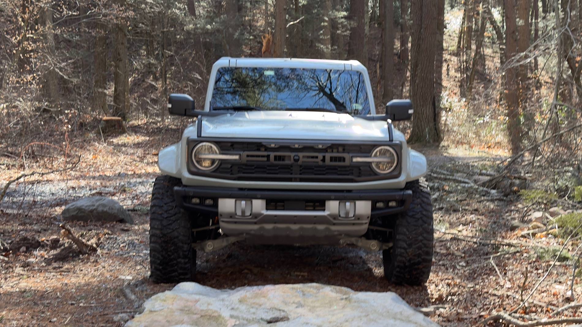

37 x13.5 Toyo on 0 offset 8.5” methods. Love it.
