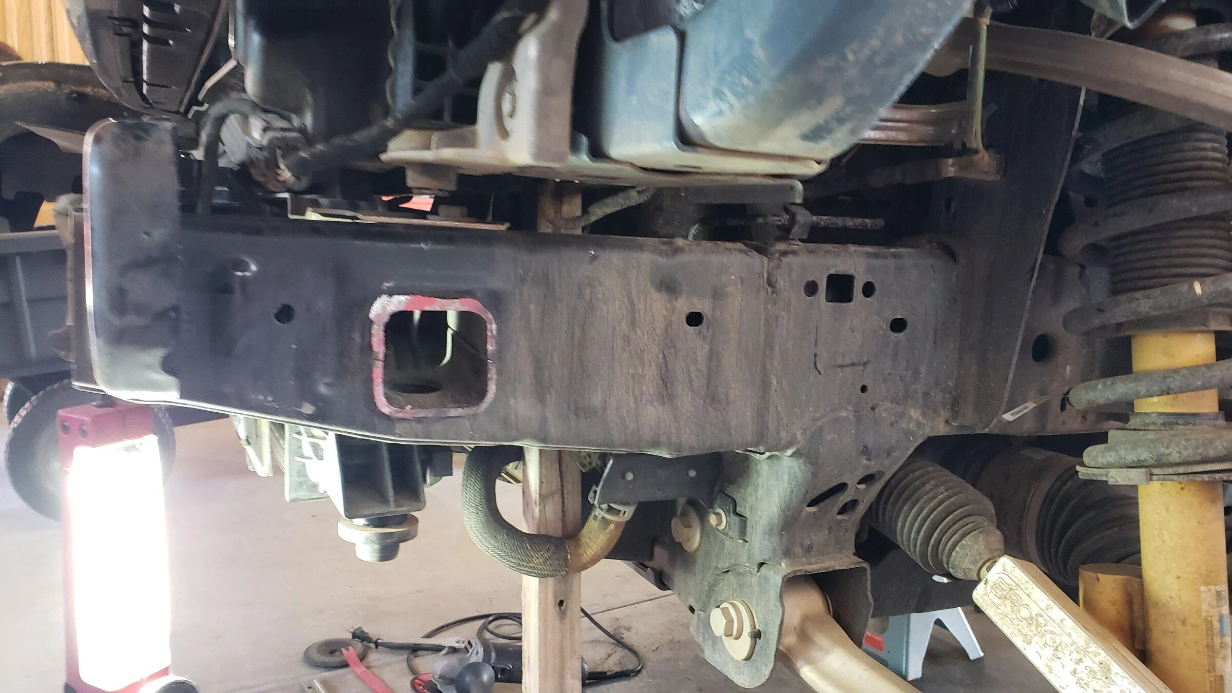

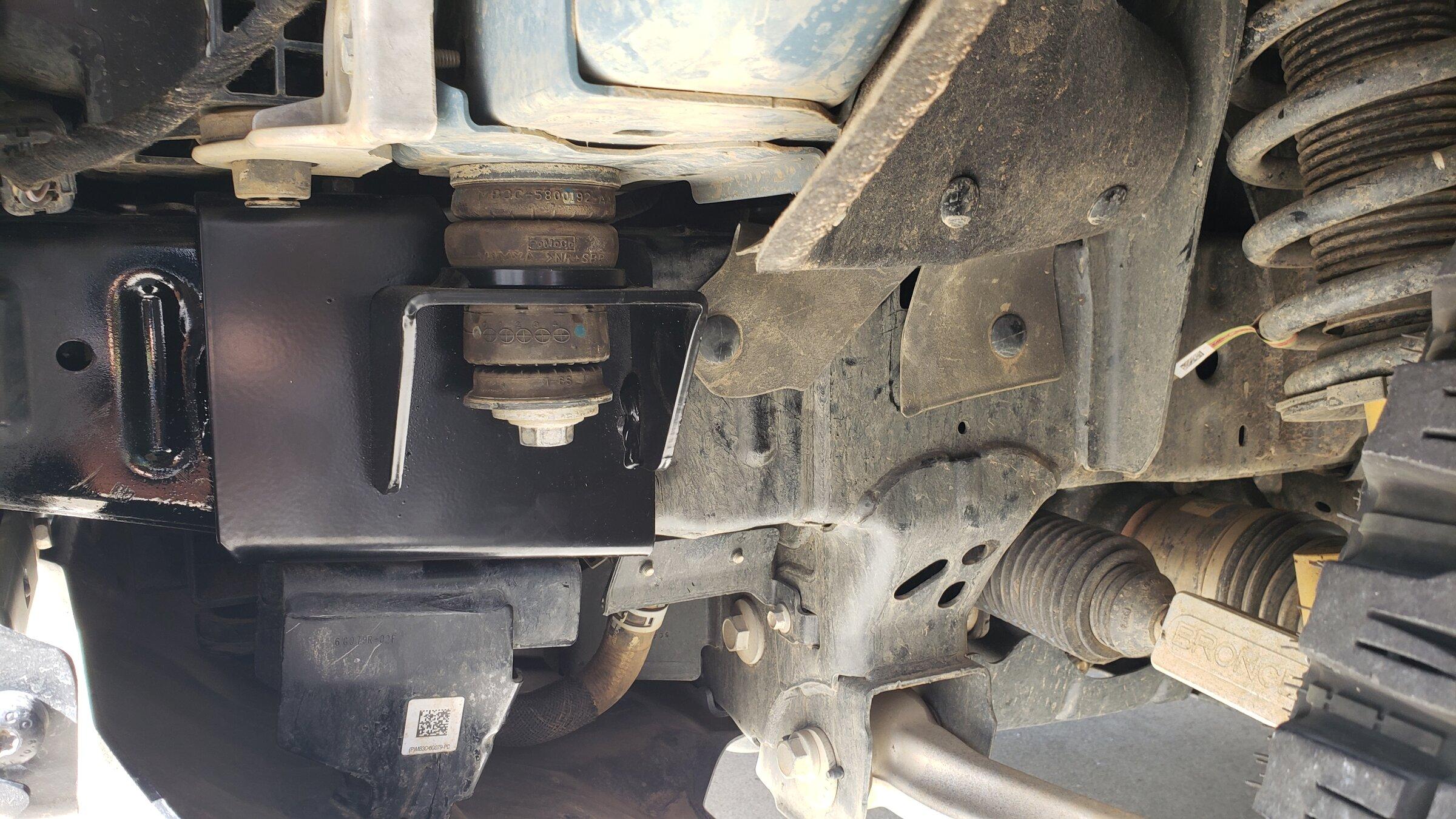

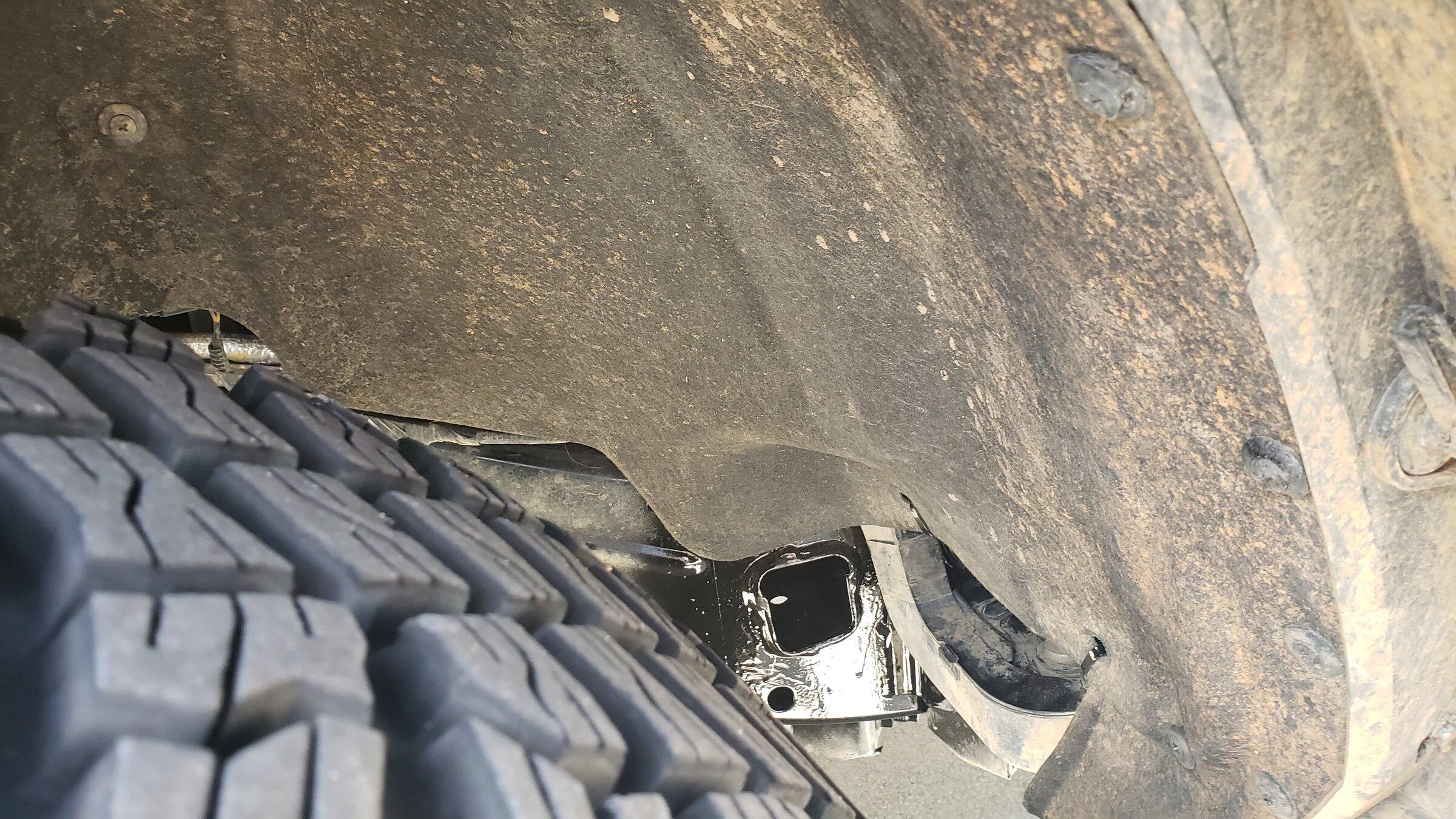

I don't have any great pictures that show it installed on mine. The manufacturer has a good video that shows it better than anything I can post. I do have a few pics though from mine, hopefully they help. The only thing they don't say is that the bottom rear push pins that secure the inner liner don't work after. There is just to much pull from the liner with the location of the new brackets. I used zip ties in these few locations and that worked perfectly to really pull the liner out of the way. Also, you'll need to punch a new hole in the liner for one location that doesn't have an existing hole. I'd still say it's 100% worth installing the kit. Lastly, they tell you to trim off a piece of rubber that has a Christmas tree clip that goes into the frame part you trim off. I found that instead of trimming, you can fold it and put it into another random hole in the frame. This makes it so you maintain a wheel well to engine seal in that spot. Good luck, it's a fun project. Give yourself time and have a buddy there to help with the bumper.

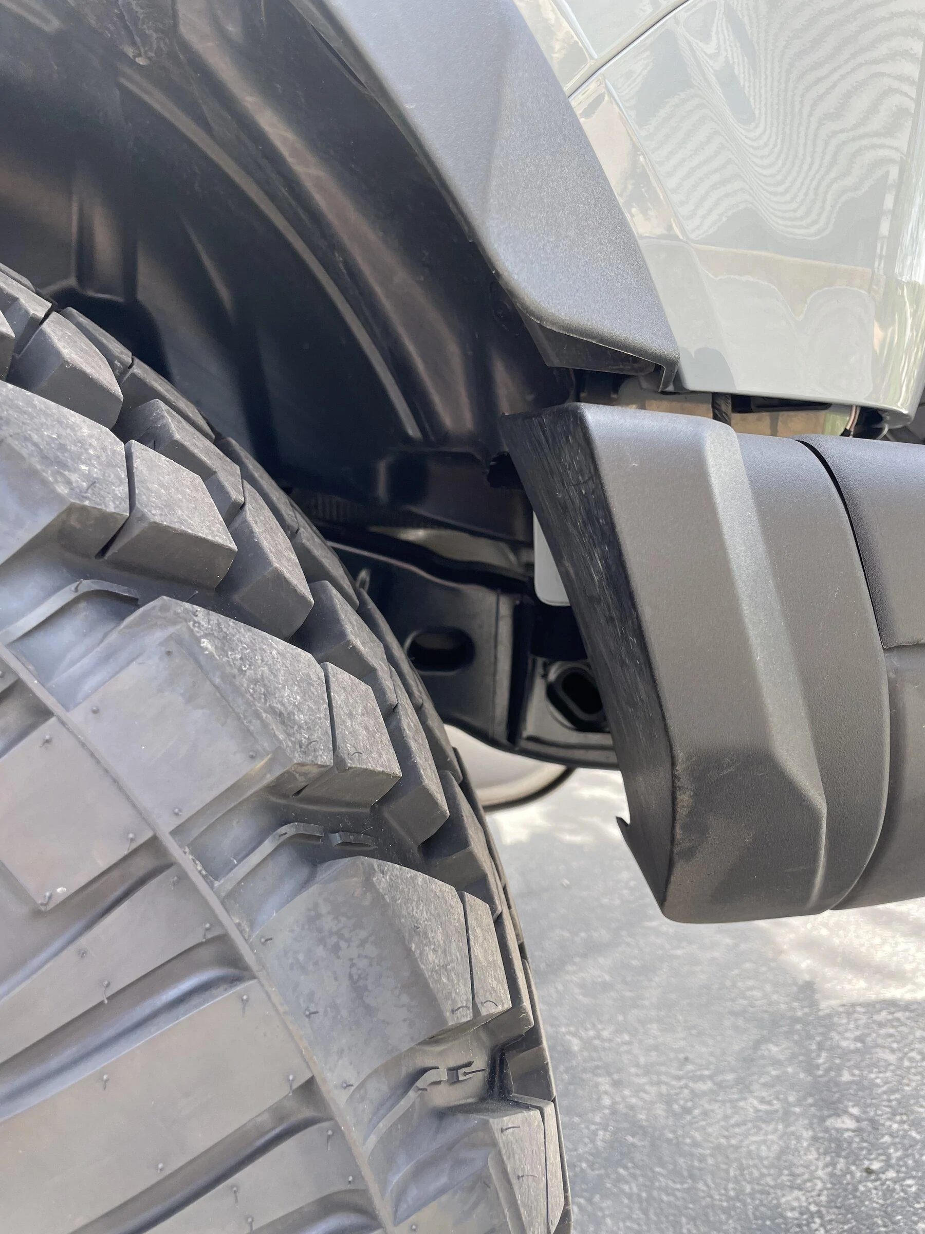

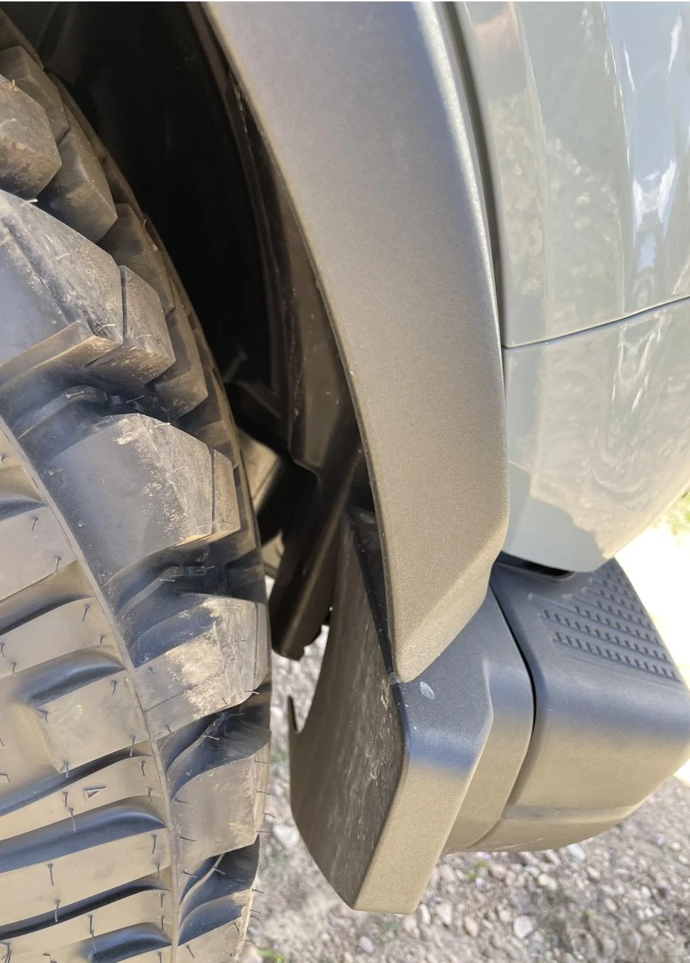

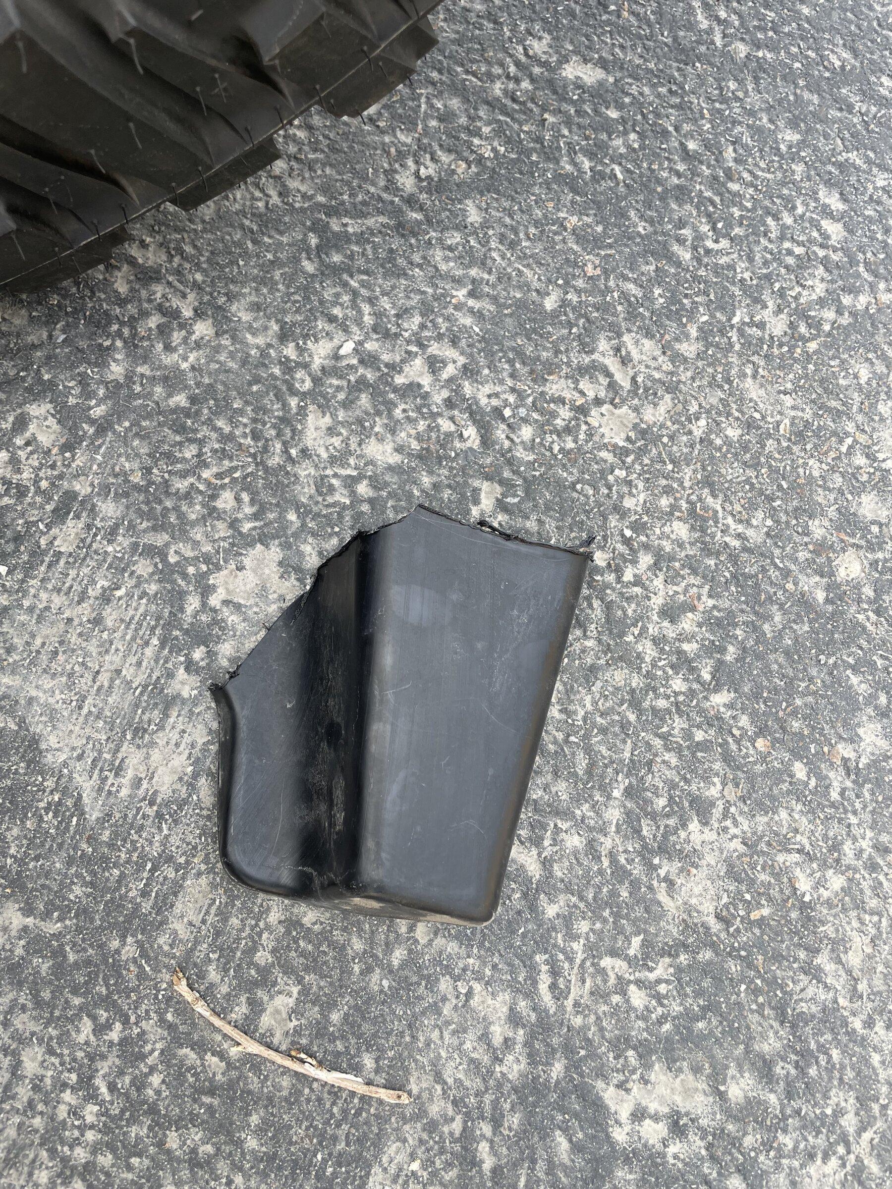

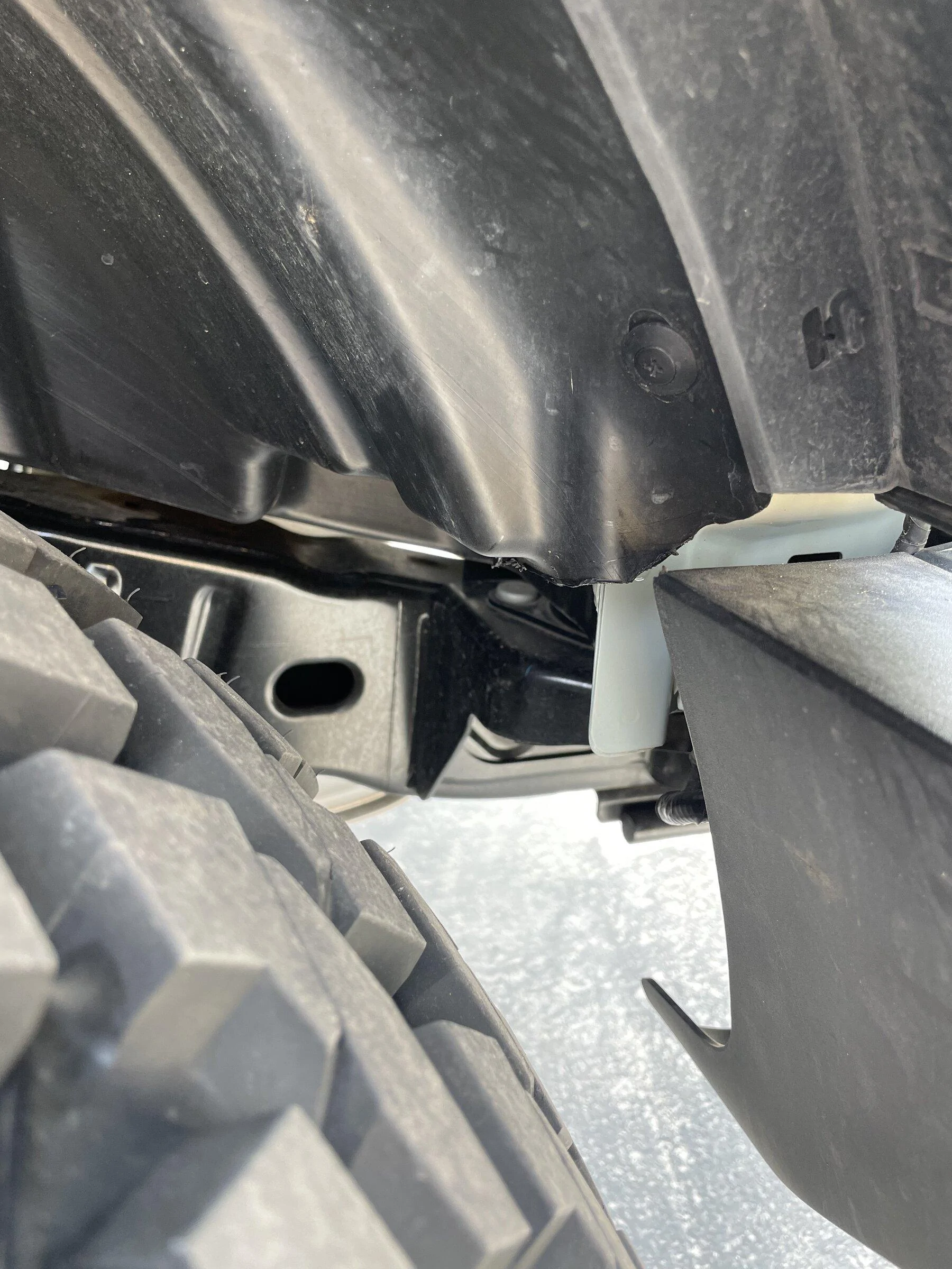

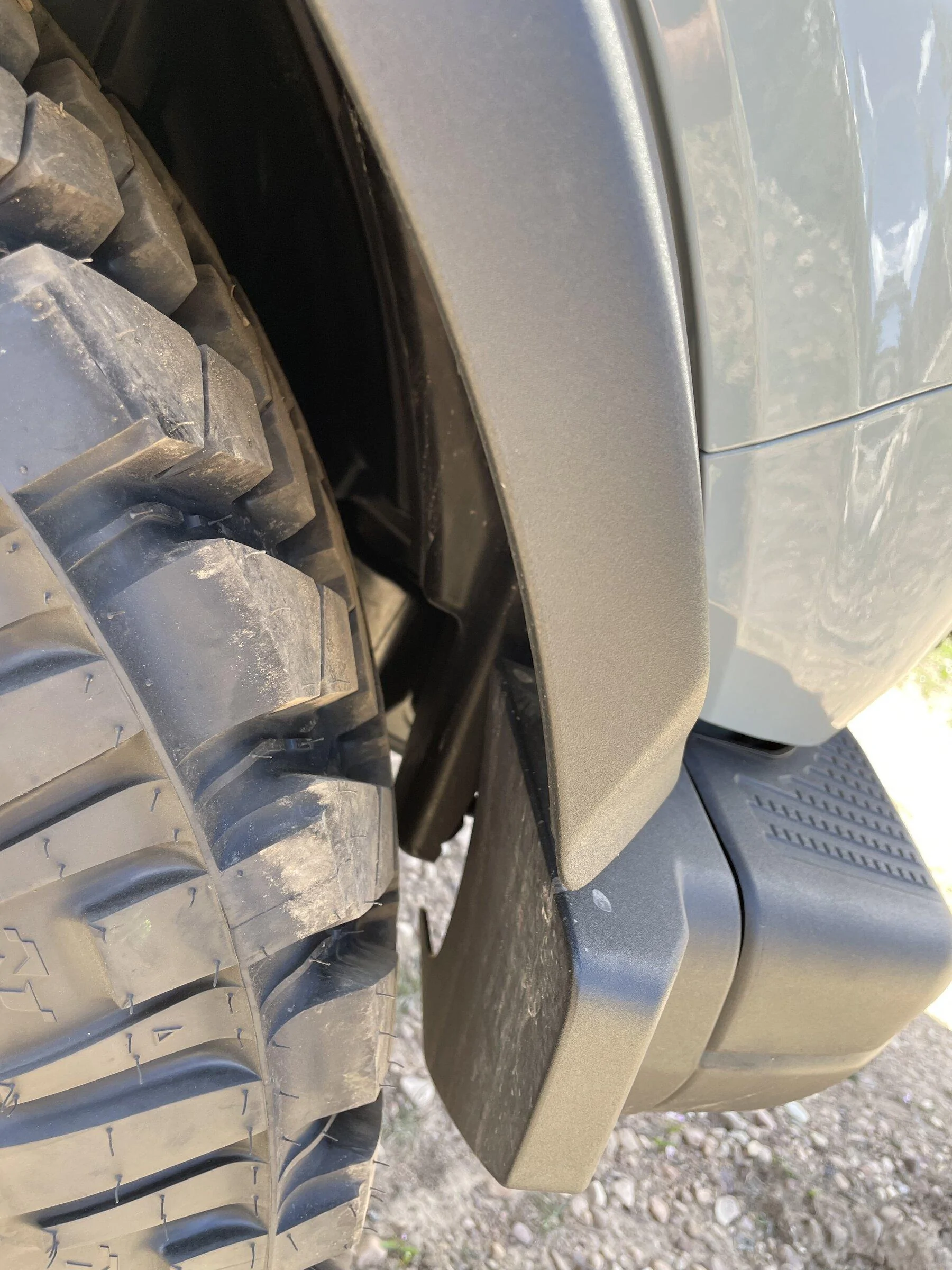

Trimmed the bottom of the rear wheel liner. That thing stuck out almost an inch beyond the metal it covers. I’ll trim that metal piece off tomorrow.

The only thing I don't like about this kit is having to cut the front piece off. I like the fact that allows a lot of clearance but worry about the strength of having the mount just bolted on to the side of the frame vs being a part of the frame. Probably worry too much but just something that worries me.

The body mount could easily be welded/plated to the frame if you wish.

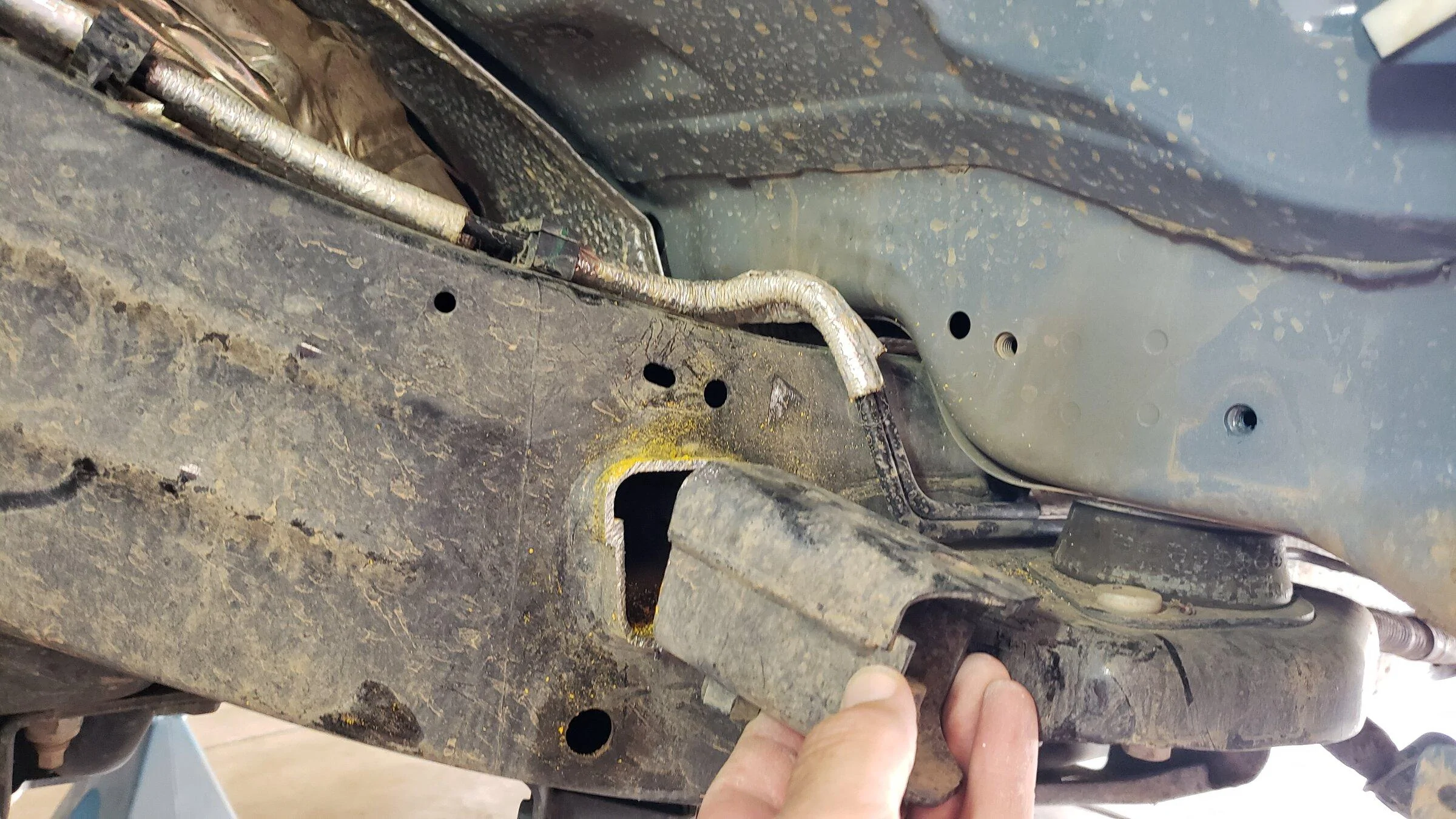

Funny that they don’t show what a pain in the ass it is having to cut off the trailing arm bolt on the passenger side lol.

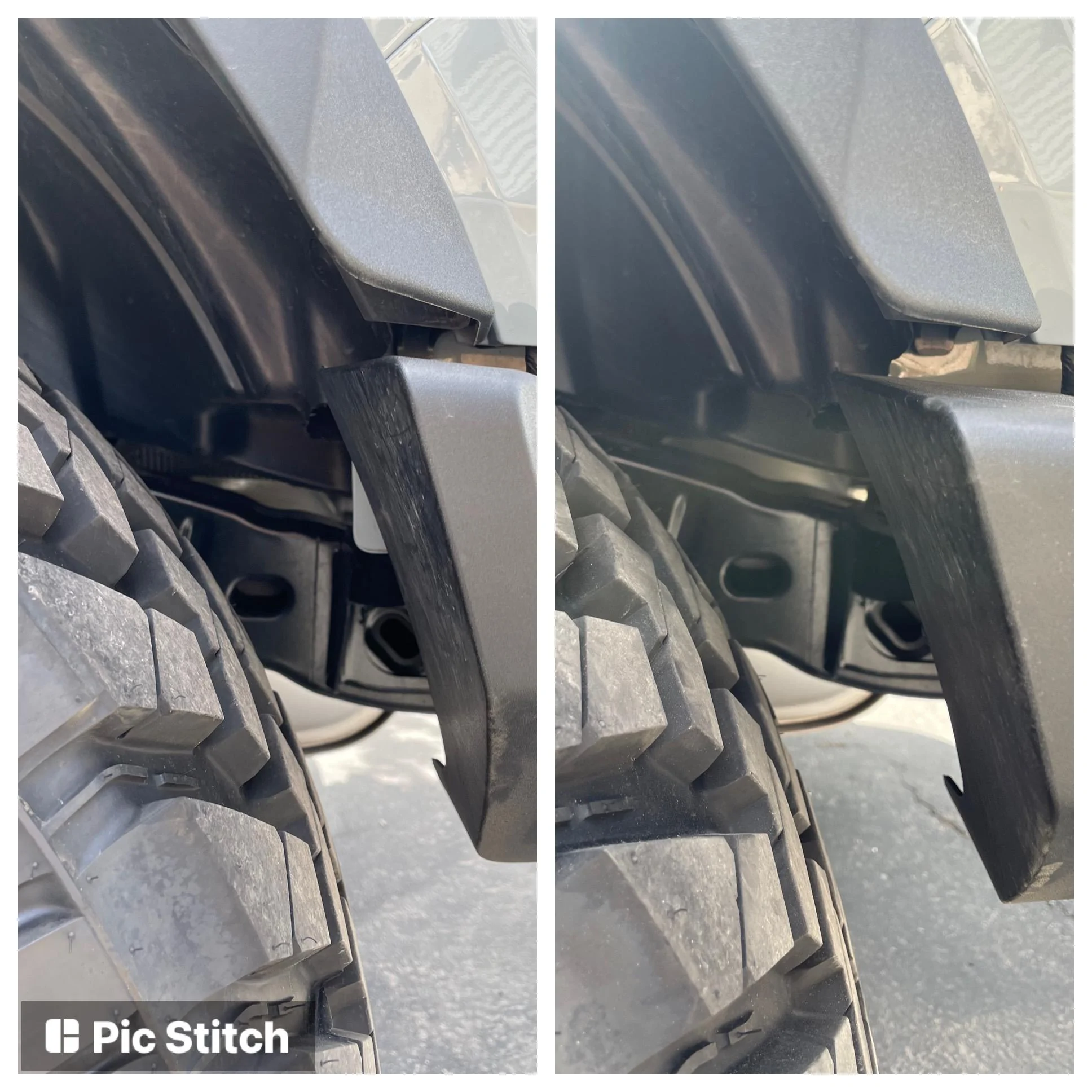

Cut out the metal piece that was behind the rear wheel fender liner. Problem solved with rubbing the liner.

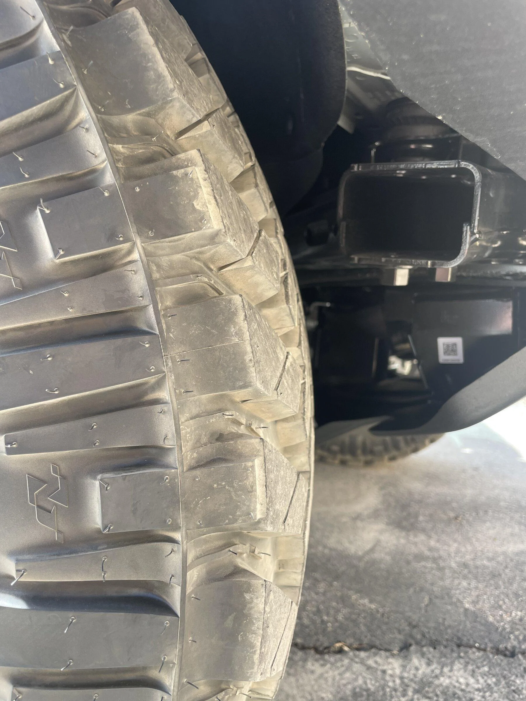

great thread. I have 37x12.5r17 Mickey Thompson Baja Boss MT's on stock Sasquatch wheels and suspension. The only thing I have done is the Big Tire Clearance kit. I also have AdV Fiberglass quarters all the way around. The only rubbing I have is at full stuff and full lock the sidebiters on the tires hit the frame. I also had to pull back the fender liners and zip tie them so that they wouldn't get rubbed.
