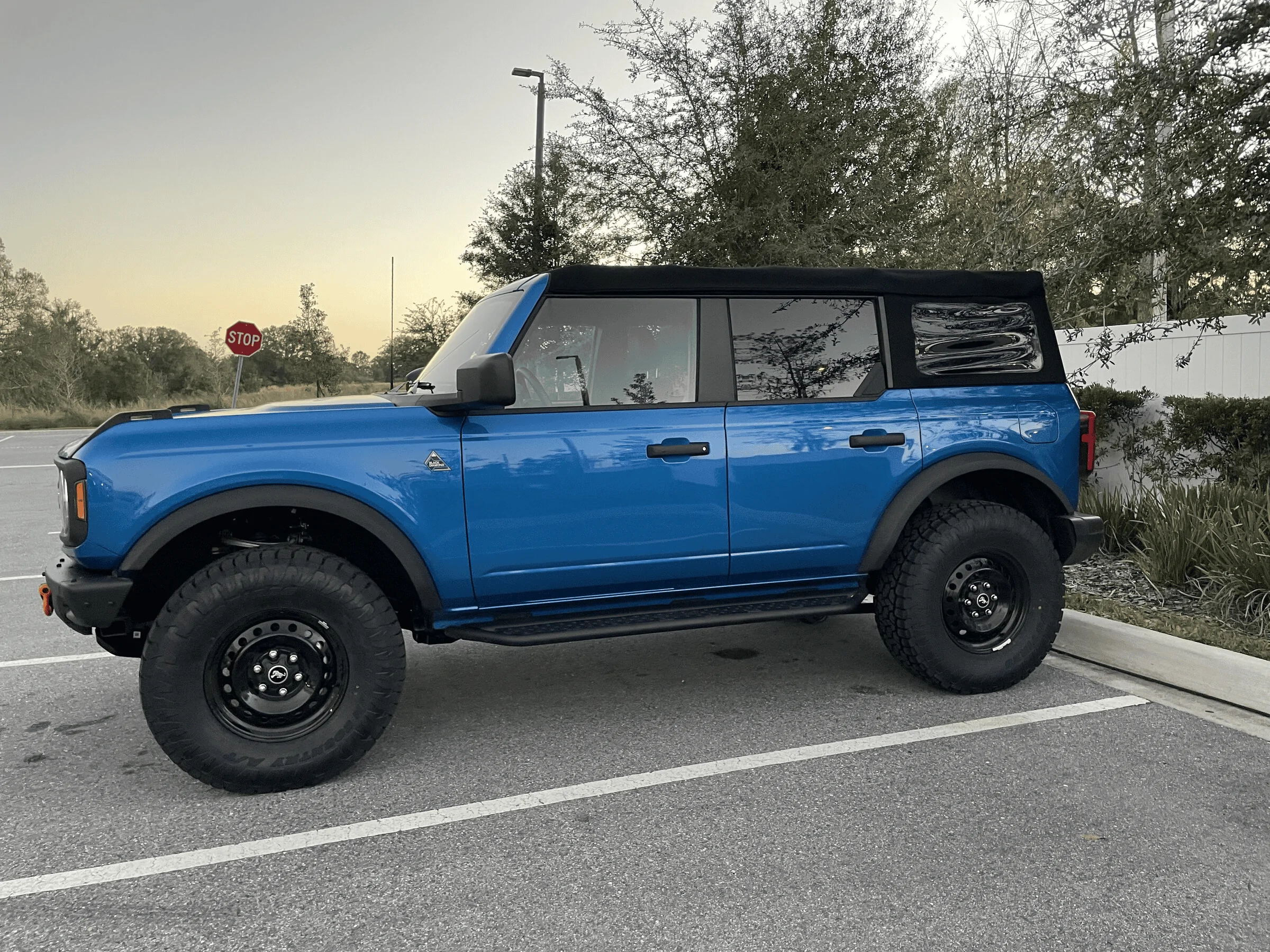

You would basically end up with the exact same stance as the standard Badlands. Here is mine on 33s with the optional wheels.
Ford Bronco 33s on Sasquatch, anyone? 80B80E90-85D8-4654-8AC8-549CD5F70A25
Ford Bronco 33s on Sasquatch, anyone? A5CABF16-9E93-498B-B3E5-4895CB2BEAC2

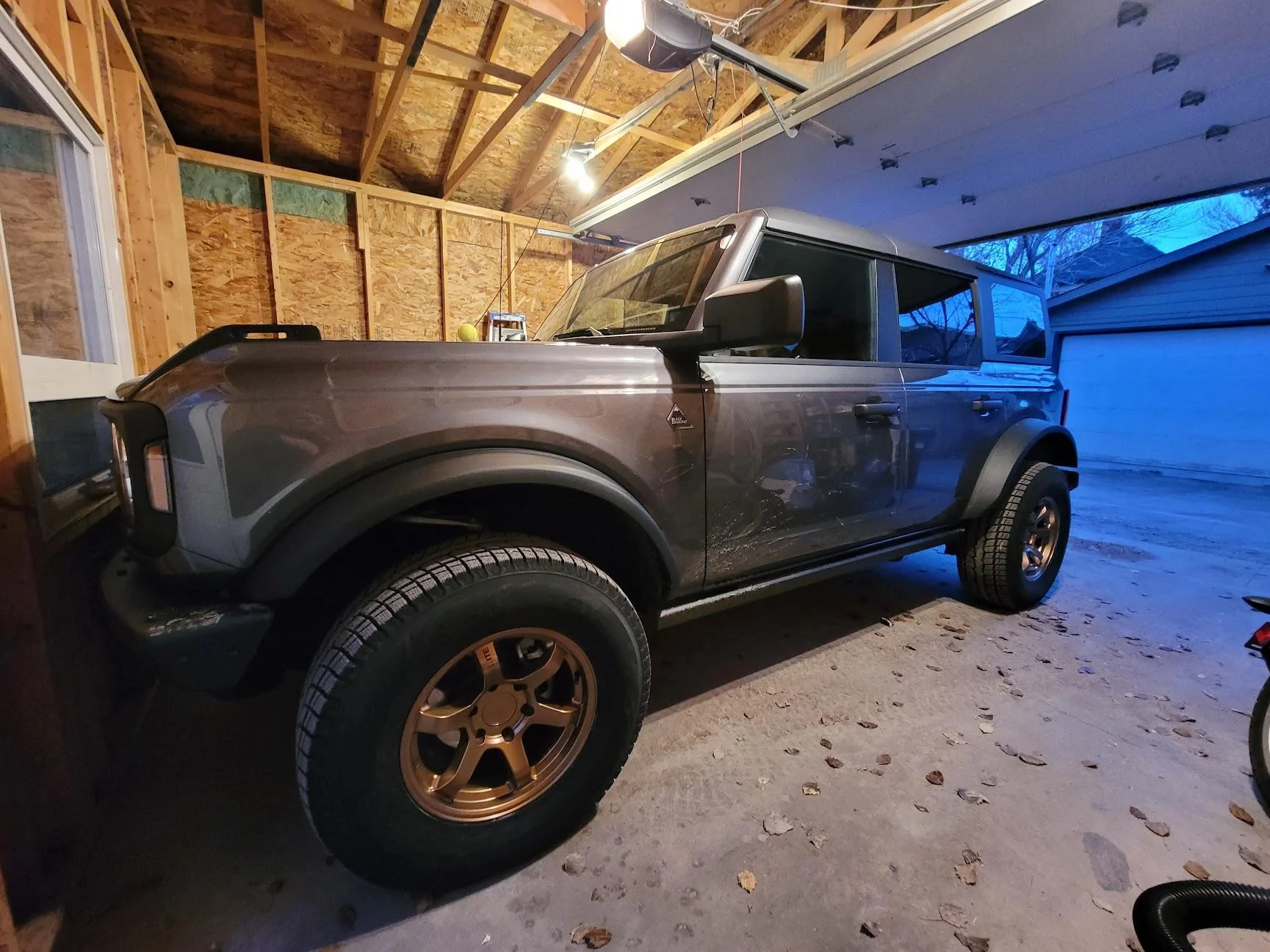

Definitely not right off the bat but I can imagine ordering up some smaller, narrower tires on different wheels to use as winter tires. Get some snow and Ice rated tires that I'd swap out in the Minnesota winter for driving around on the street.
