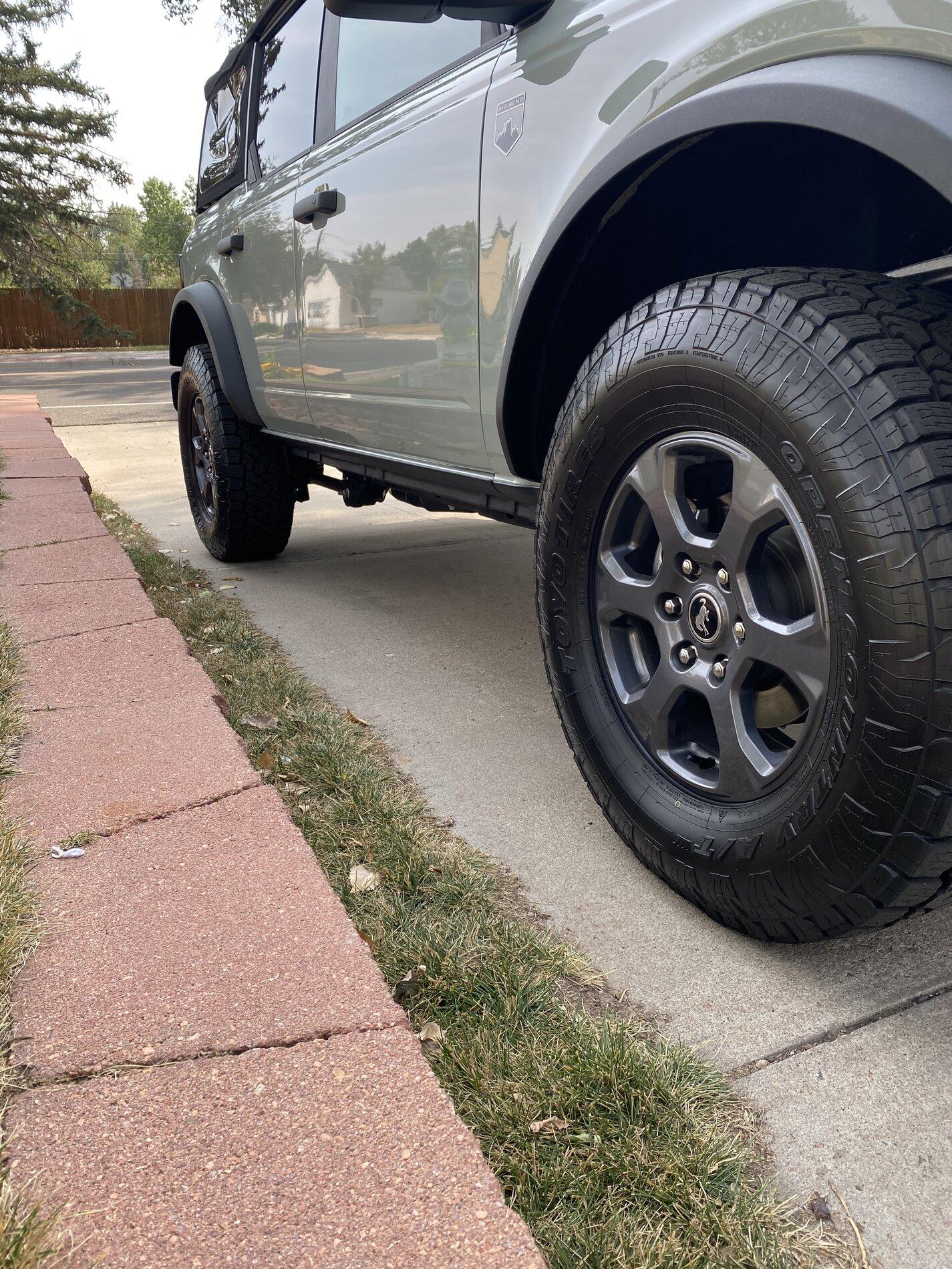

I put Toyo AT3 33’s (285/70/R17’s) on my 4dr 2.3L Auto BB after about 500 miles on the 32’s.. My combined mileage went from about 19.3 to 18.9, however the 500 miles on the 32’s was a very small sample size. I could detect no discernible difference in drive performance or road noise. I’ve put about 2,200 additional miles on the 33’s thus far.
