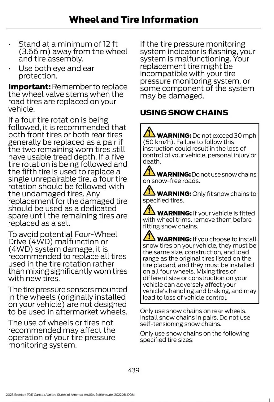

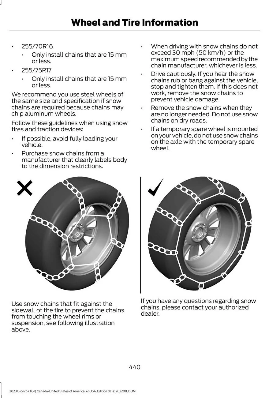

From the manual
Ford Bronco Anyone use chains on their 33s IMG_1177
Ford Bronco Anyone use chains on their 33s IMG_1178
