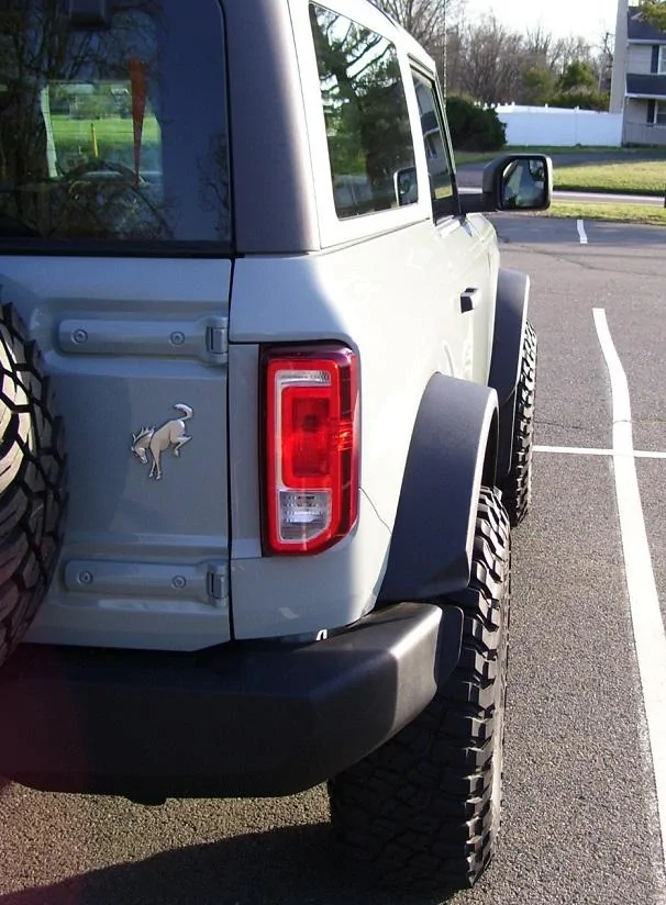

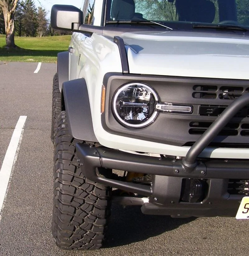

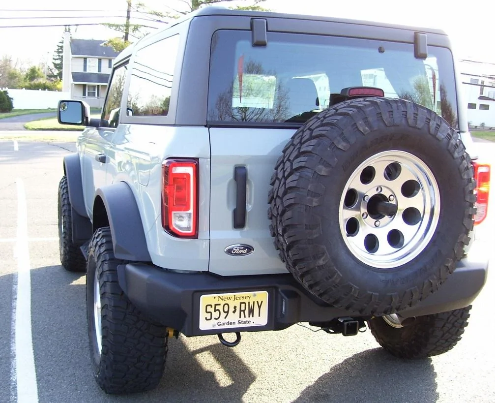

Looks good. What wheels are those?
They are the Pro Comp 1069's. They are similar to the old Mickey Thompsons.

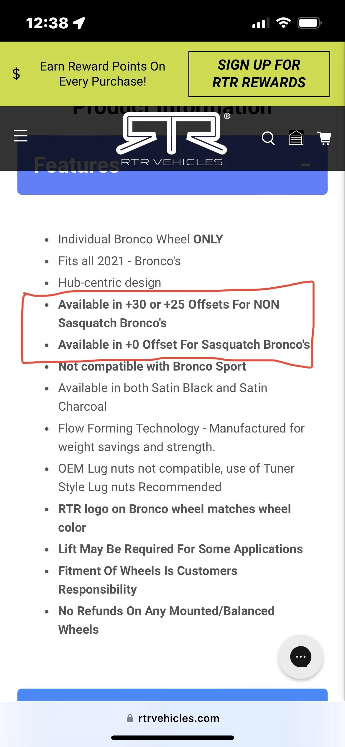

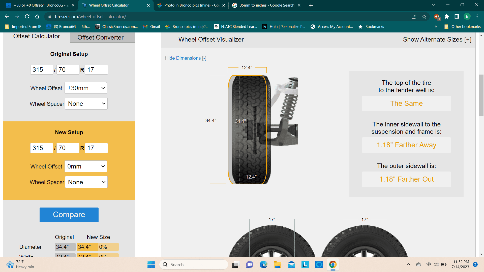

So can I run Method 8.5" +0 offset wheels on my 23 Badlands non-sasquatch and just add the fender flares? Anyone have a picture of how that will look. The tire calc says its going to poke out 2.5" more. Does that sound right?
