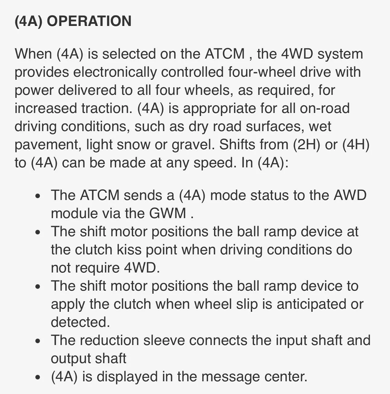

If you use 4A in dry conditions over a longer period you will toast your transmission, the clutch packs will overheat.
4A “acts” like AWD, but does not turn your Bronco into AWD, it's for slippery conditions only!
Using 4A has absolutely zero impact on the transmission whatsoever.
I’m not sure if you meant to say transfer case or if you just don’t understand how it works. But either way, 4A is perfectly fine for everyday driving whether it’s dry or wet out.
Knowledge is power. Thanks.

wow awesome information, when I was off roading and hit pavement then gravel I would switch modes, now i know i can leave it in that mode

Ahhh, thanks @Ducati1098 , I hadn't finished the thread. Got to dispel the misinformation!
