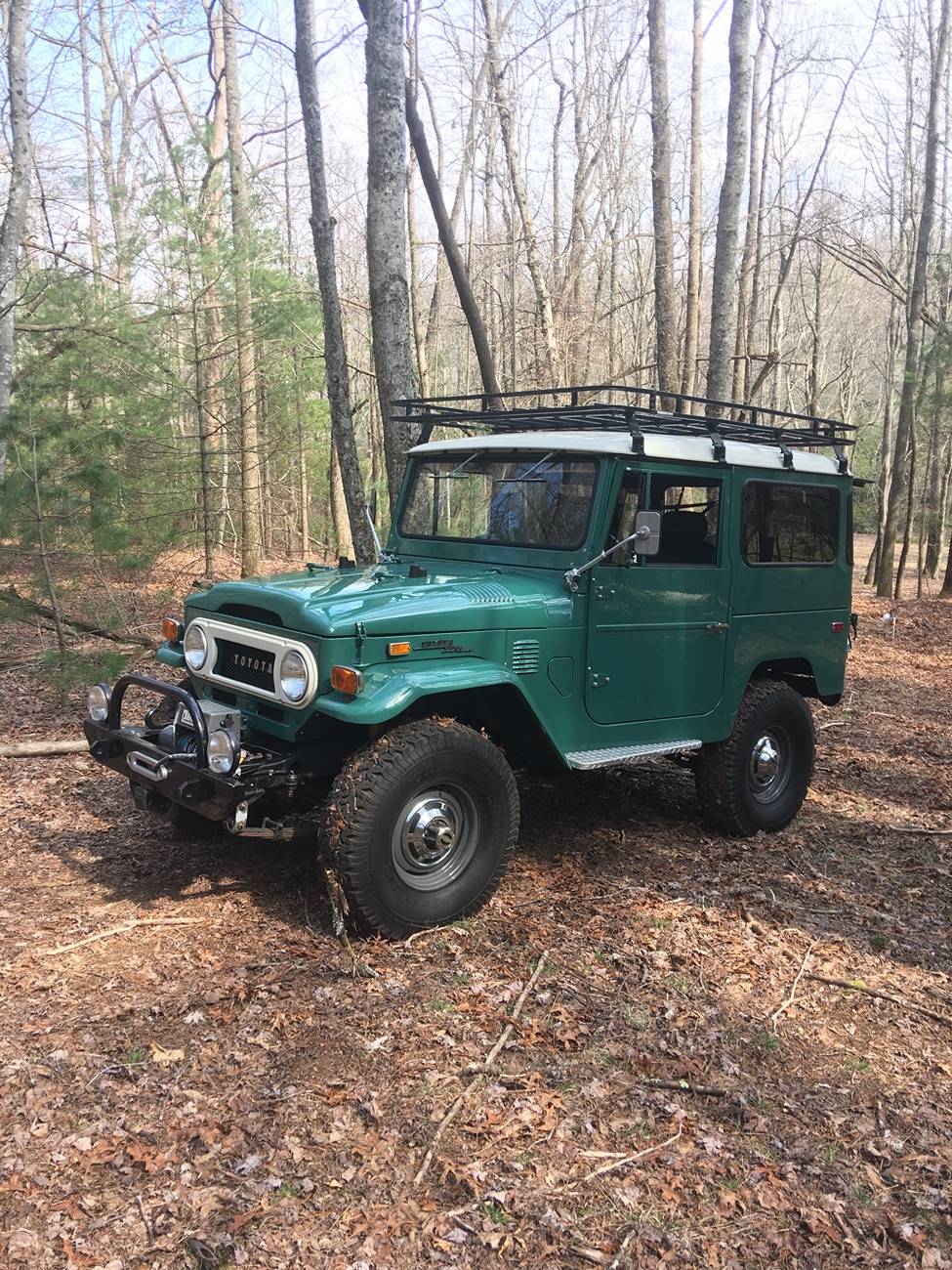

Chalk test on my 72 FJ40. 33 in tires on 15 in rims. Bowed out. Looked good though didn’t feel comfortable with so little tread on road.
