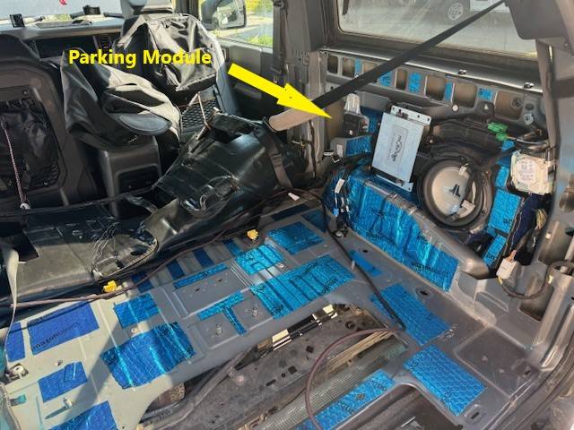

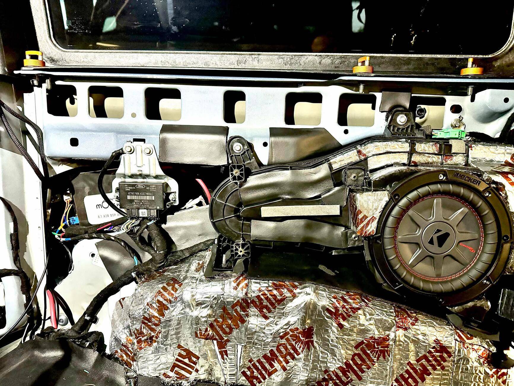

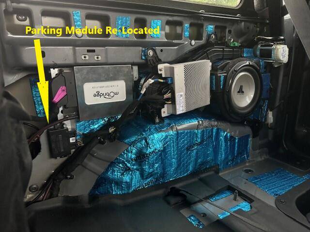

I was worried that I would have issues trying to find a solution as well, but my solution was pretty simple...I just moved the parking module down a bit lower and installed the amp in it's place.
If I was to do it over, I would use the parking module mounting plate to mount the amp! (I used (2) 1" tie straps from Home Depot to mount mine.
Step 1: Locate Parking Module
Ford Bronco 2dr mobridge gearshade subwoofer? Module
Step 2: Mount Amp and re-locate Parking Module
Ford Bronco 2dr mobridge gearshade subwoofer? Relocated
Step 3: Final position and plug the port on the sub enclosure and mount sub with a trim ring.
Ford Bronco 2dr mobridge gearshade subwoofer? tune 7

thanks. I tried this and it’s too floppy and the wiring runs against sharp edges.
modifying the parking module takes it further away, and mine doesn’t have much extra wiring to put it in the same spot you did.
I removed the cup holder and that’s not the issue. It’s the way the panel is molded.

Seriously, that's a lot of whine! lol
Yes, molded for the cup holder...you definitely don't want the enclosure any smaller just to fit the amp!
If you are not happy with how you mounted the amp, mount it better, mine is rock solid and all the leads are safe from any sharp edges...you may have to wrap the wires or provide protection to them, it's part of the installation process.
I also don't understand your "takes it further away" comment, further away from what, you are moving it about 6", what's the problem?
You are going to have to have a bit more of a flexible attitude if you want to do the install yourself, or just pay someone to do a half ass job at twice the price, luckily it's not rocket science, it plug 'n play!

I stuffed it farther to the left of the stock box.
Ford Bronco 2dr mobridge gearshade subwoofer? 1737043578424-b7

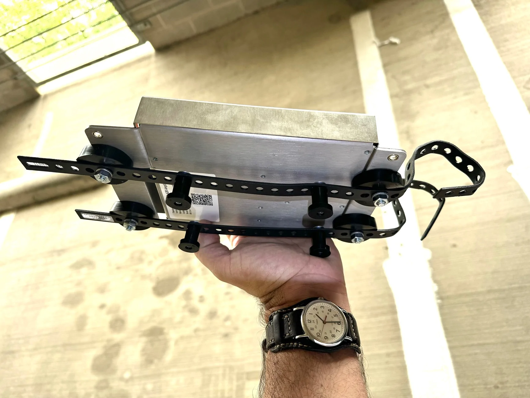

I made this weird little cage thing with rubber offsets and stuffed it back into the hole. The bent part acts as kind of a tension spring and holds everything in place surprisingly well.
It’s really solid.
Ford Bronco 2dr mobridge gearshade subwoofer? 1757857763085-jj
How did you mount the amp in that space?
