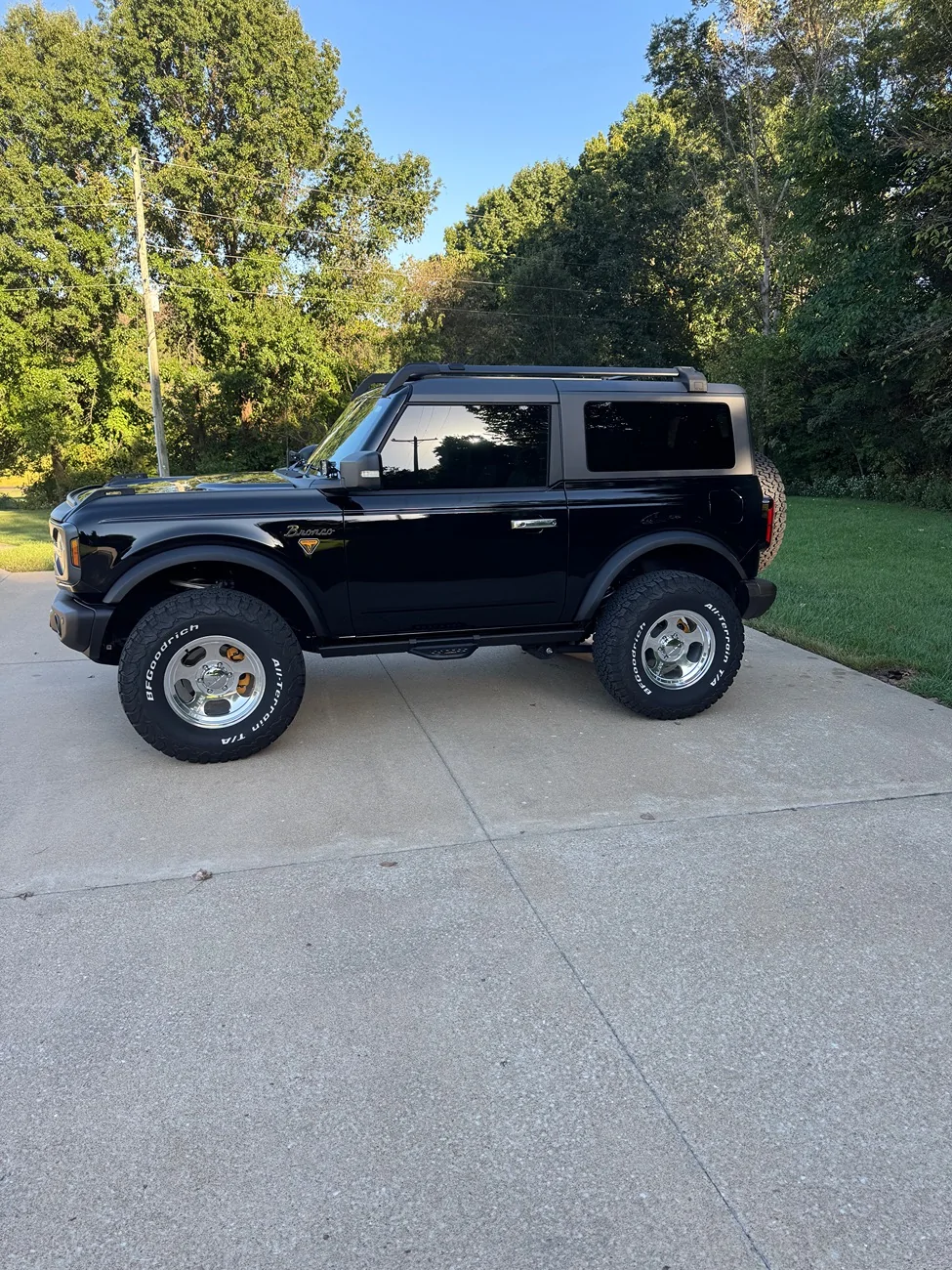

I bought those tires because I wanted the white letter tires or I would’ve never bought load range E’s but they ride better than the Goodyear Sasquatch tires anyway. I run them at 32 psi and I could probably run them at 10 and they wouldn’t squat on a small vehicle like this. I use the same tires on my heavy duty trucks and they’re fantastic. I get 75,000 miles out of them on my heavy duty vehicles and I’m expecting the same out of these.
Those are 285/75/17 ?? For some reason, they dont look like it - BUT, it looks awesome!!
What offset wheels??

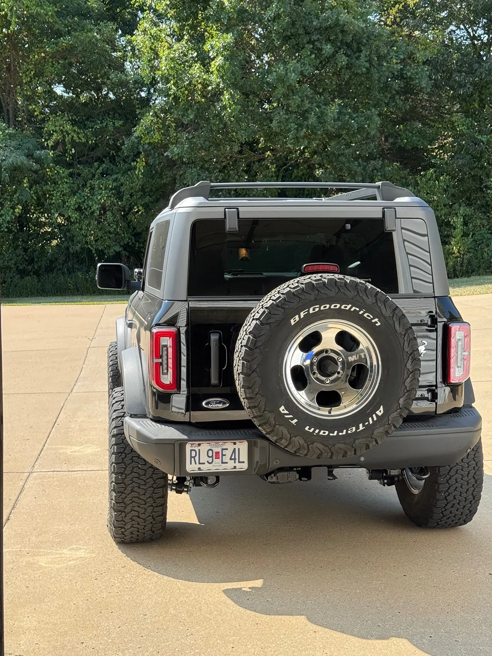

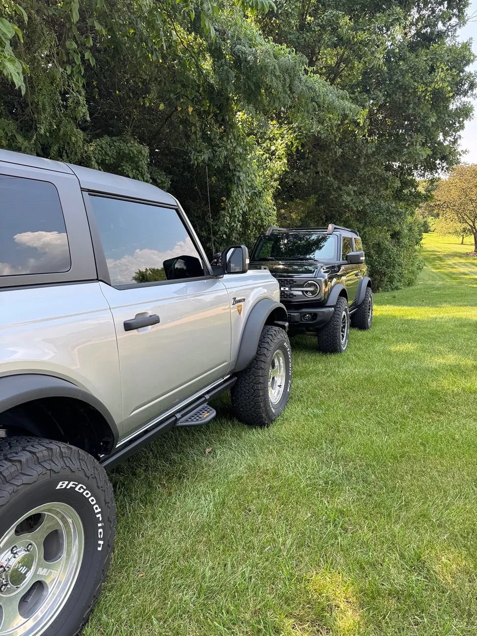

No, they’re 35 x 12.50 x 17s but the conversation is exactly the same for any size load range E tire on a light duty vehicle. They’re rated for 80 pounds on the side wall, but they’ll run just fine with almost no air in them at all. The wheels are 17x9 zero offset with non-Sasquatch fender flares so they stick out a bit. I also have the same tire wheel combination on my Sasquatch and the tread is basically covered by the Sasquatch flares, but the sidewall of the tires stick out past the flares. The silver one has the Sasquatch flares, and the black one is pictured with the old Sasquatch wheels before I got the zero offset wheels installed. The last picture is how the black one looks with zero offset wheels installed now.
