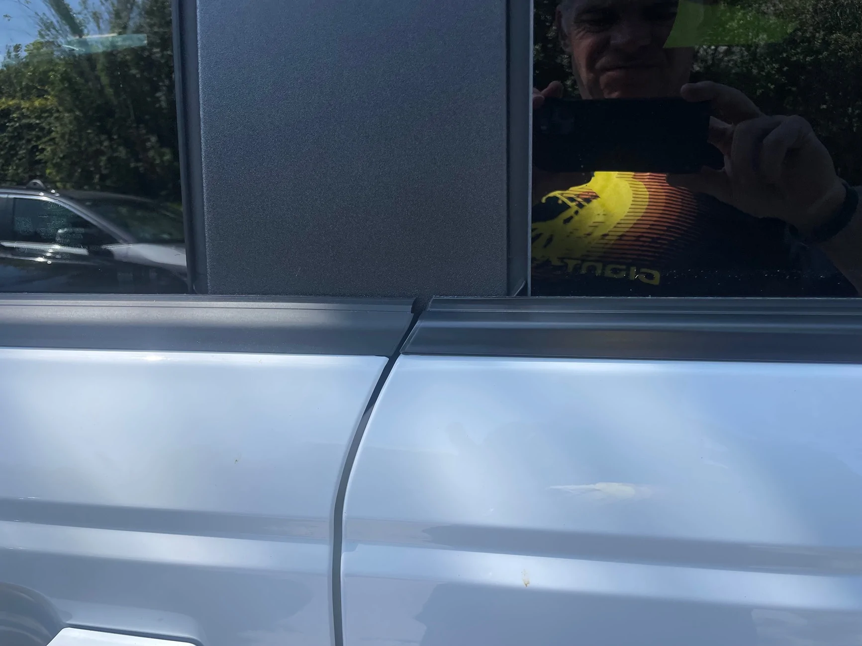

I had the same issue on my 24! Would rattle when opening and closing passenger door. Dealer fixed it with new interior molding and and window runners. So everyone knows when they replace the exterior window molding it will Not match your existing trim on back doors! Dealer said ford only changed the design on front window not back windows! So your trim will be semi gloss on the back doors and satin on front
Ford Bronco 2025 OBX window rattling IMG_4281
