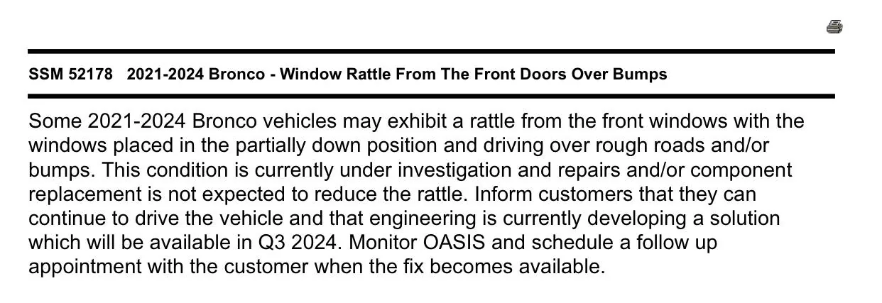

Hi FMC, Do you know if the fix that Engineering was working on has been worked out yet? Others mentioned it earlier in this thread, and my local service adivsor also said it was planned to come out in Q4 2023. (We're getting close to Q2 2024 as of this writing)
Latest information is Q3 of this year now.

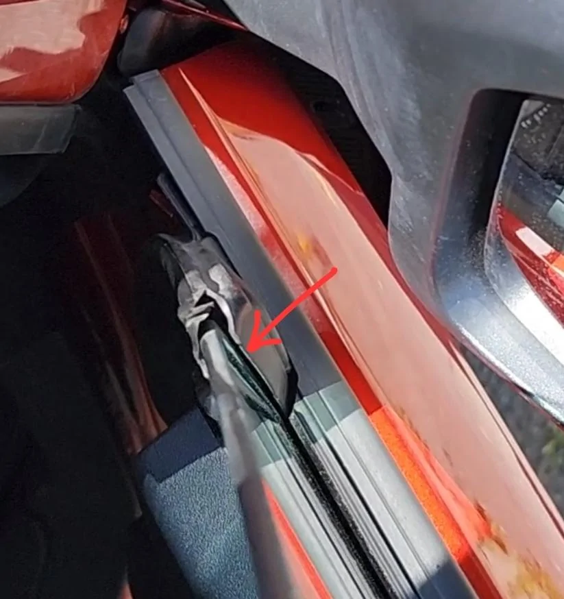

This is an old video, but it might help you out:
Yes, I've heard of this solution, but I would worry that the dealership will simply say "you've been messing with it, so we're not doing the service under warranty" (if the fix ever comes out).
