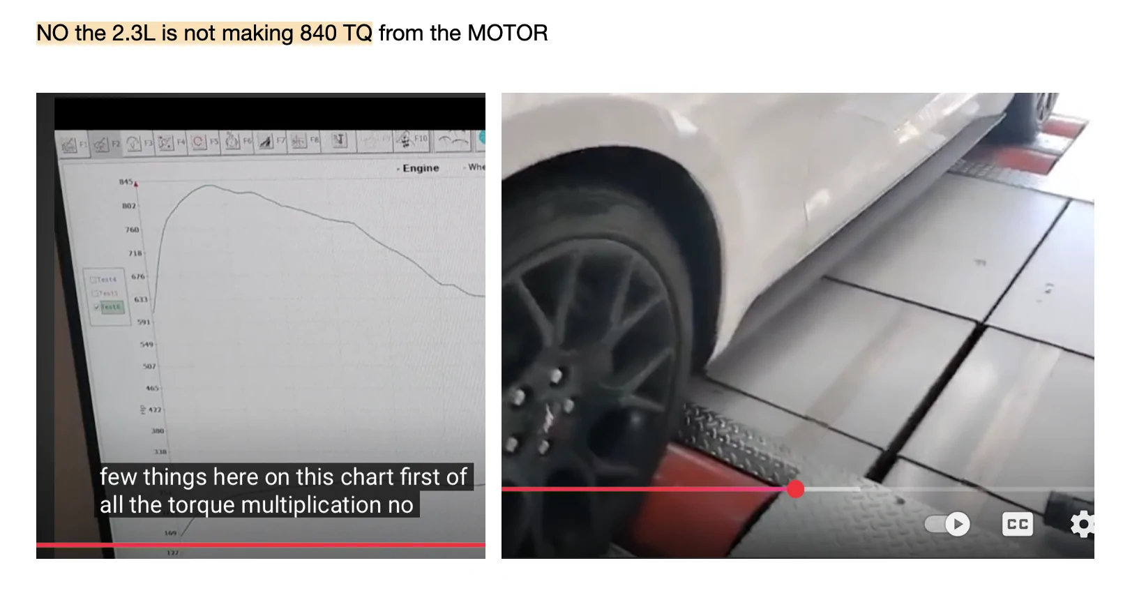

Real world, yes. A lower gear like 2nd will make more torque because of multiplication, but it won’t read like that on a chassis dyno though.
.... lol, if a DYNO only measures TORQUE, it doesn't know what the driveline gearing is...
Here maybe you'll get it this time.
Same testing on the same mustang, NOT in a 1:1 gear ratio… BUT in a different gear- TQ Multiplication… and NO the 2.3L ENGINE is not making 840 pounds of TQ
WHY dyno's run 1:1 to tuning the motor... other pulls at other gearing gathers different information...

Lmao, calm down chief.
Yes lower gears do multiply torque, which I already said, and is also why the Mustang graph you posted shows stupid high wheel torque numbers. Dynos can be easily manipulated for big flashy torque numbers by just running it in 1st gear and smashing the gas. We all know how gearing works, congratulations.
The actual point was about why peak horsepower numbers (and often torque too) read lower in low gears on a chassis dyno when you’re actually trying to get realistic numbers. The short pull wastes a ton of power on drivetrain inertia instead of the rollers.
Which is EXACTLY what you see going back to the original K&N Bronco graph in question here. Both HP and TQ are extremely low because they used 2nd gear instead of a typical 1:1 gear for accurate realistic numbers.
You took one screen grab from some random graph of a completely different vehicle showing torque multiplication being manipulated on one dyno run and acted like you just debunked anything I said lol
Maybe relax with the smug “here maybe you’ll get it this time” lectures. I’ve actually dynod multiple vehicles including a Bronco in multiple different gears, so I’m well aware of how they work and the results that you could get depending on what gear you’re in or how you accelerate on the dyno.

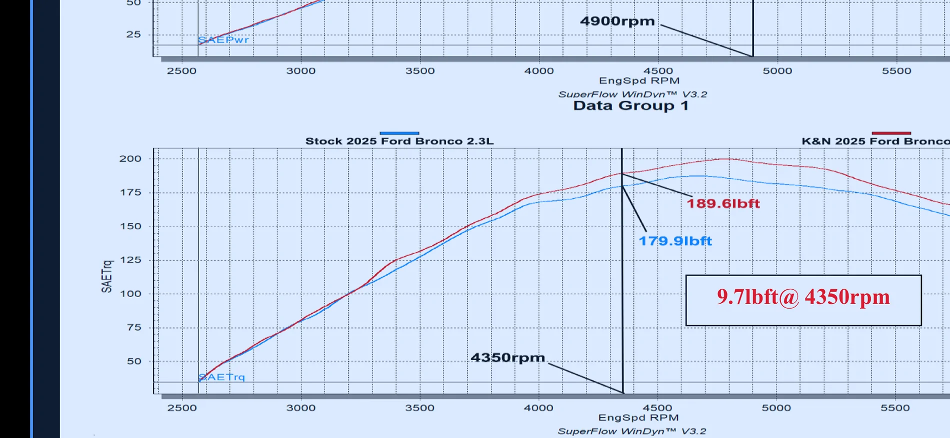

If run higher than a one-to-one gearing is a torque multiplier...
lower (over drive) would decrease torque
Ford Bronco 2025 2.3L Intake IMG_9072
As I inferred… 2 second gear (shifter) would /did improved the dyno numbers… Why they’re just marketing BS when not all is shared.
Keep your day job…
