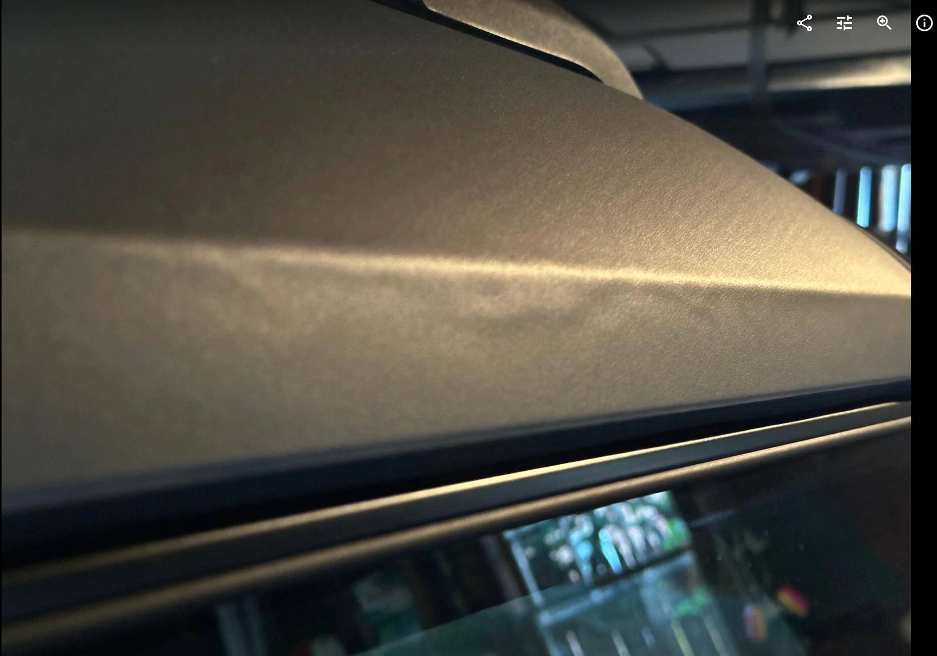

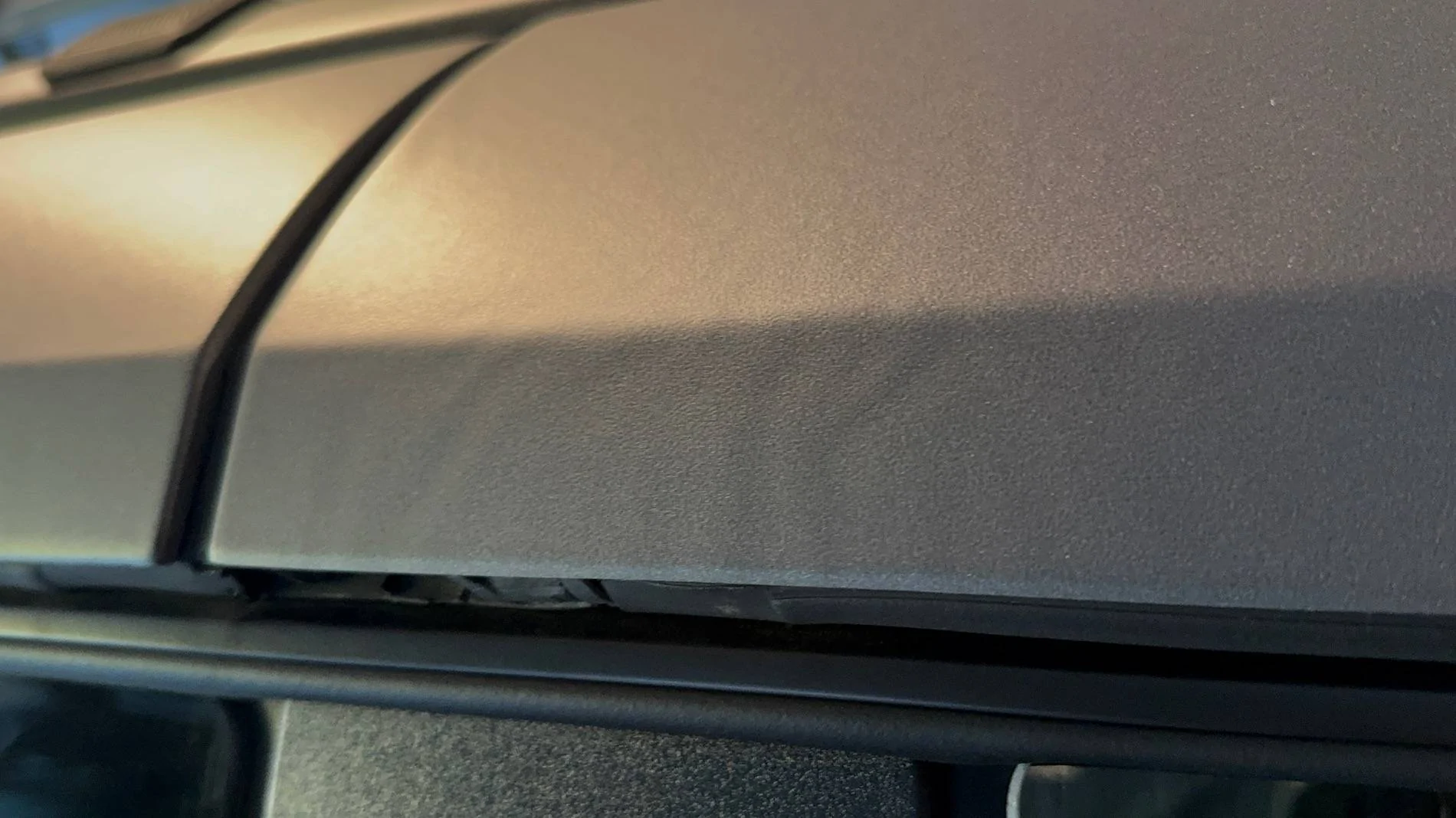

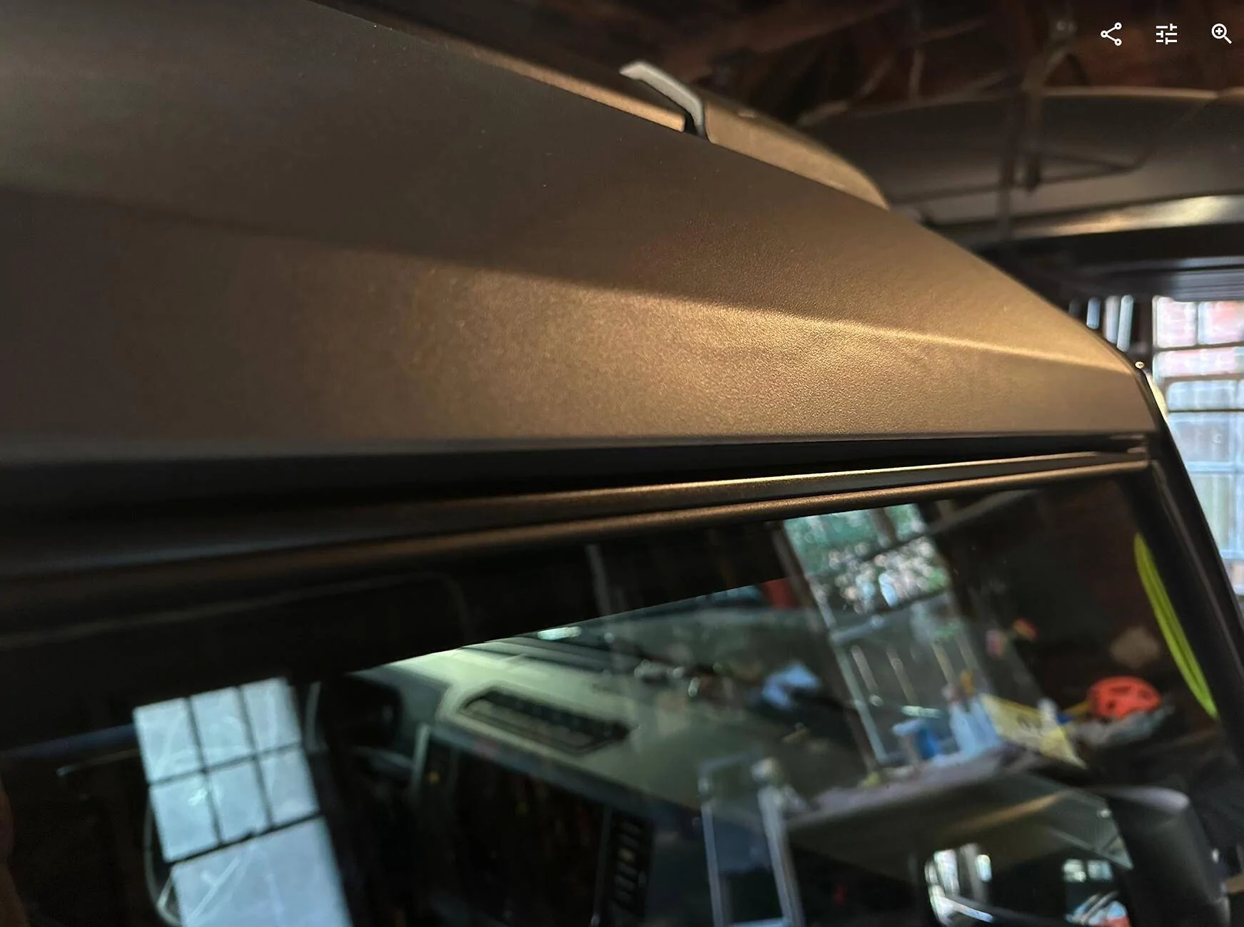

I'm curious as to whether others have this appearance on their hardtops. I ask because it does not "feel" like a de-lamination (i.e., not squishy or any movement). It certainly doesn't look correct and there are no other similar spots on the top. I should note this is a 2024, picked up in mid-October. Thank you!

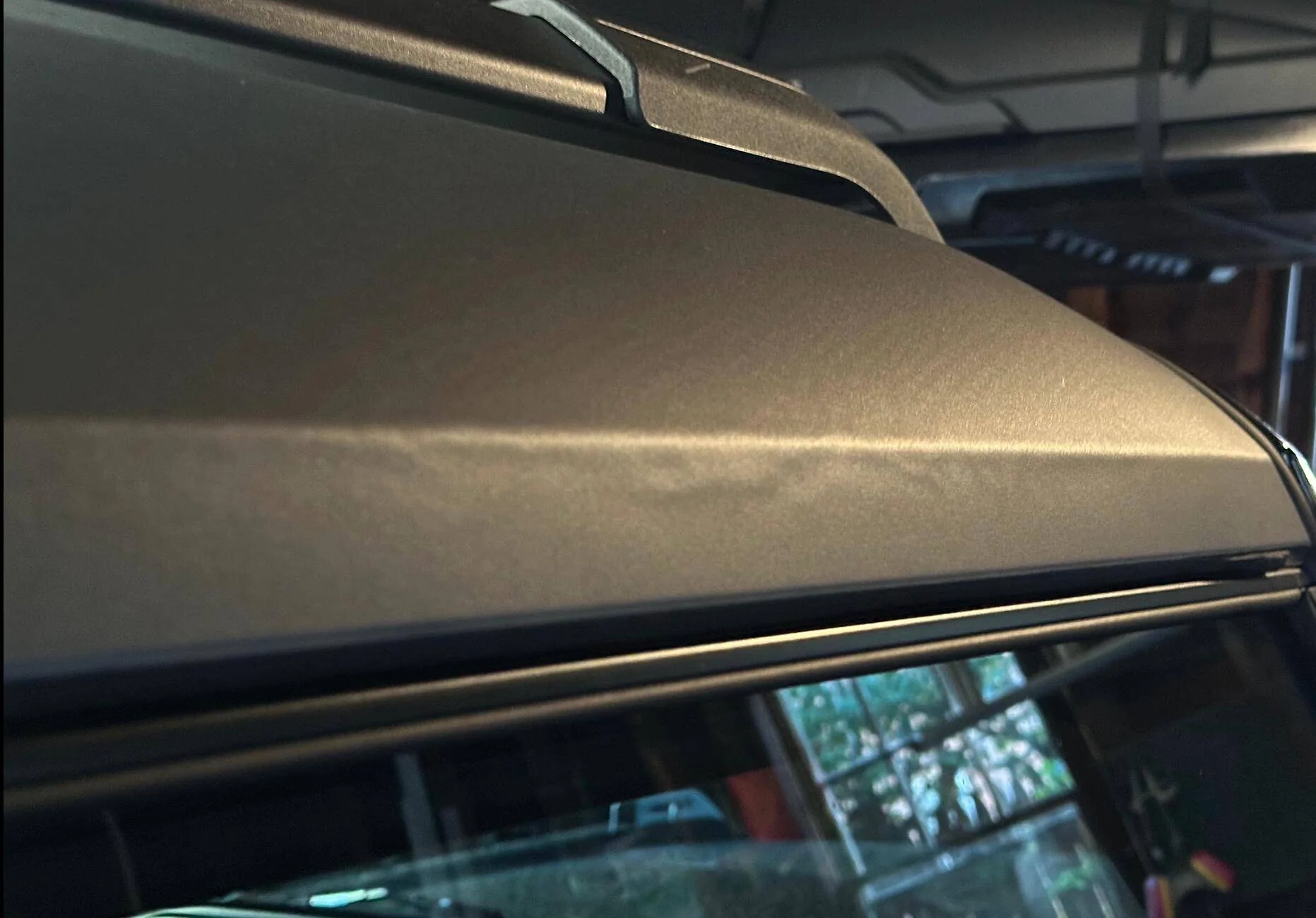

I have something similar and was told by a few others that it is normal for these. Might be different but I only see mine in certain light - usually in the garage - but looks fine the other 99% or the time. No issues with mine getting worse or anything.
Hard to compare by pics but hopefully it’s nothing!
Ford Bronco 2024 MIC top delamination or normal? IMG_2915

Just purchased a 2024 last week and noticed the same spots on mine. :sadface:

Just to provide an update. The dealer is working to correct it. However, on my way out I stopped at the sales department. Every Bronco on the lot, regardless of trim, had the exact same pattern. Only on the passenger side-- same as mine. Very strange. I guess, it could be normal or maybe an entire run with wonky(ish) tops?

May I ask how they're going to correct it?
rduke1022
Nov 4, 2024
Massachusetts
The service manager took photographs and submitted them to Ford for warranty work. I suppose Ford may say its normal. I will certainly update this thread with the outcome.

I have that weirdness with my replacement top. The waviness on the side of the mid panel and I believe on the side of a front panel or two.
These tops are shit, shit, shit.
It took 2-1/2 months for the dealership to replace one shit top with another shit top. They also did a shit job of installing the headliner.

Seeing that every bronco on the lot (about 9) had the same pattern, my hunch is there are issues with the tops' molds. I have some experience with repairing honeycomb-core materials. I'm a rower and our boats (shells) are usually a Nomex honeycomb core with carbon fiber/kevlar skin. The patterns I see on the top very much remind me of what happens when something is incorrect with a boat's mold.

Same here with my 24 Badlands. Drivers side top and bottom, 1k miles. Passenger side as well. Had the same problem with the 22 Outer Banks. Going to wait for a while before I purchase another and see if they can make one that wont crack with just driving.
