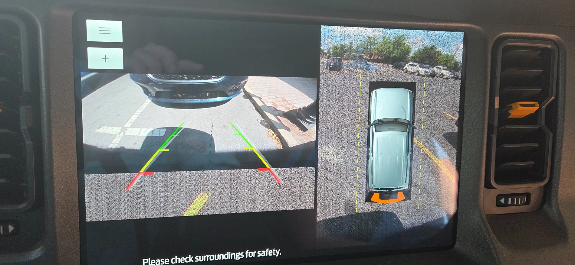

The update was to fix the black reverse screen. Working wonderfully as you can see.
Ford: the above is sarcasm.
So now I can hardly connect my phone, the reverse camera, which never ONCE had a problem before, does goofy stuff every other time its turned on, my wife can't connect her phone... can we undo this fix?
This is what happens when you mass push a software update that fixes a problem that not everyone has.
