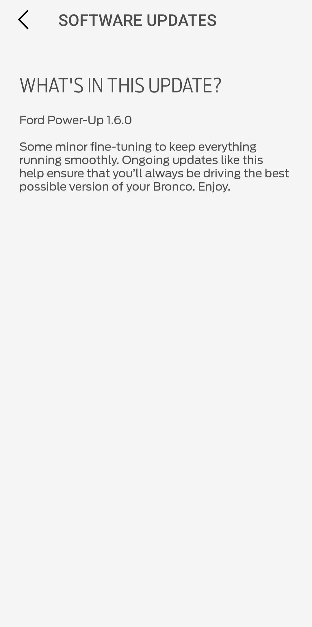

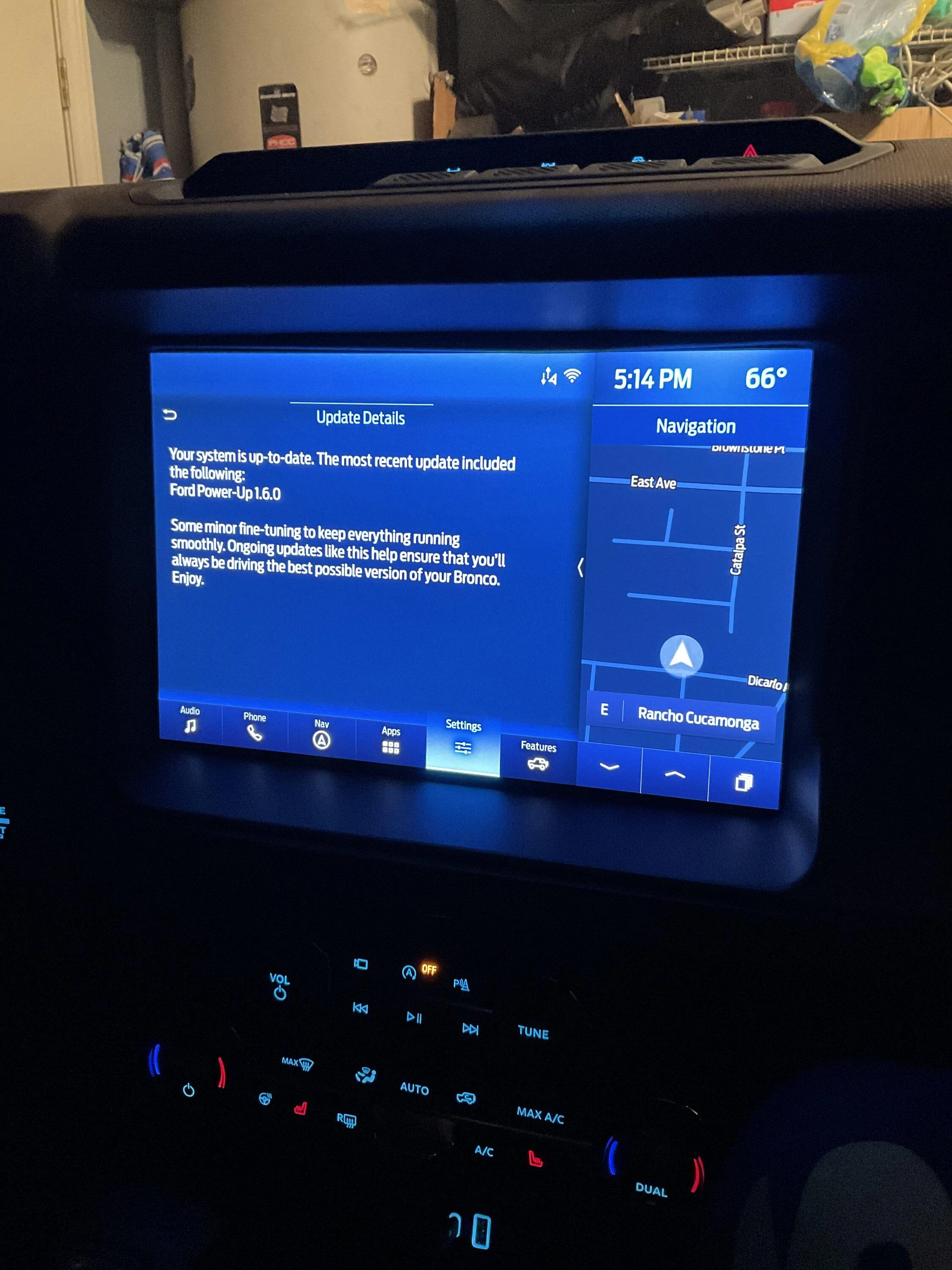

I am going through this forum and can see that people are on versions higher than 2.0. I checked my 2021 outer banks bronco with the 12 inch display and it says I am at 1.6.0 and that it is up to date.
How come people are able to update theirs but mine is still on an older version and says that it’s the most up to date version? I am connected to the wifi and have set a recurring schedule for the update.

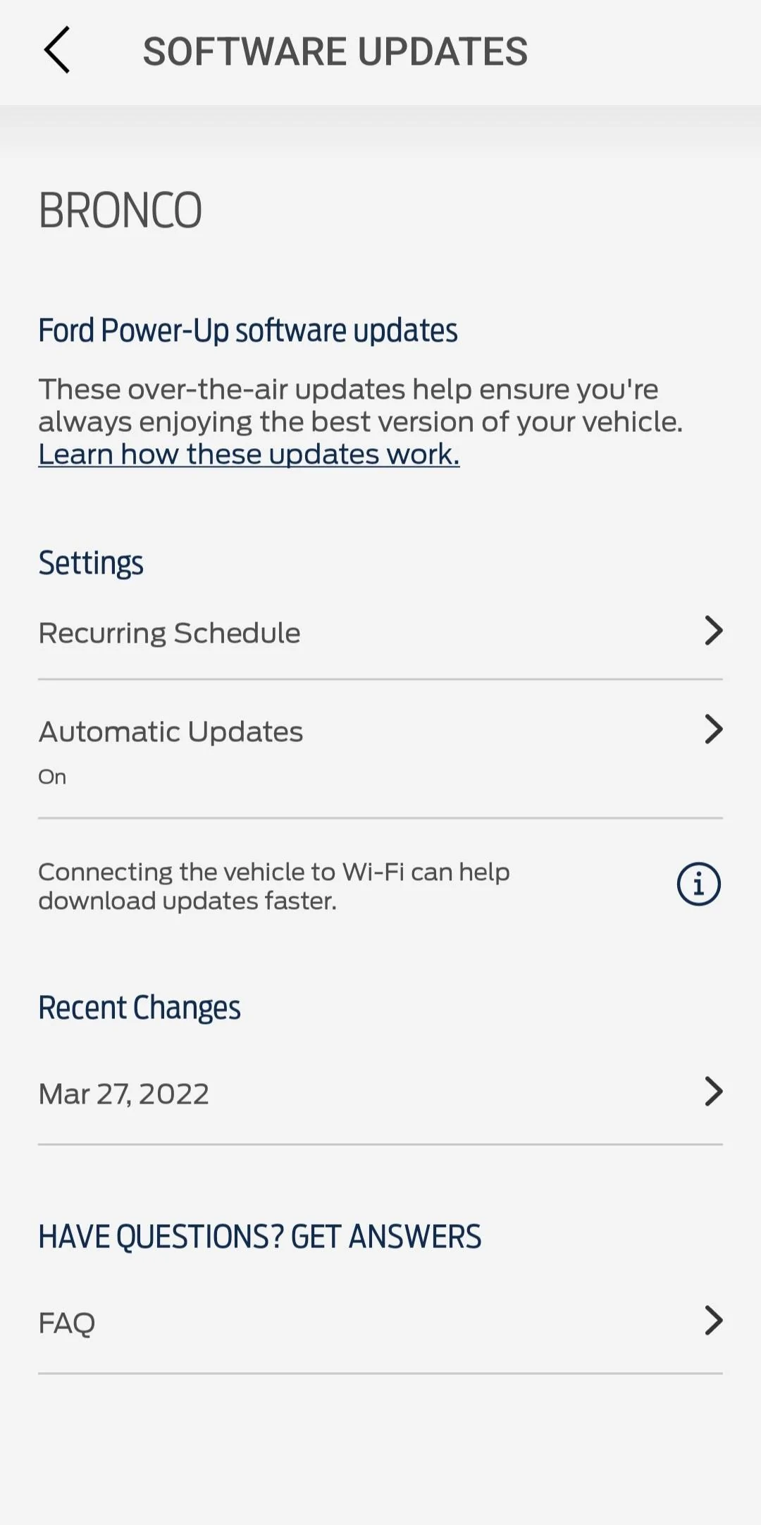

I haven’t been updated since this:
I have auto updates on and everything looks right. I wish there was a way to know what version you SHOULD be on. I haven’t been updated since February.

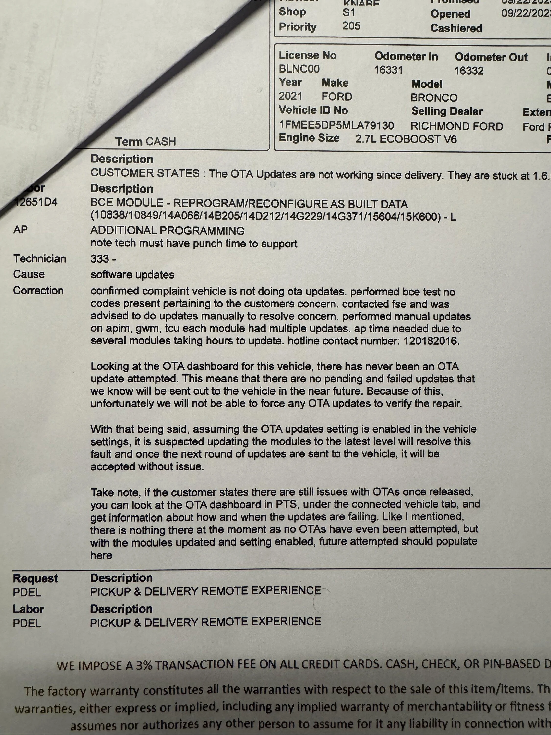

Sharing my service doc in case this helps someone in the future, same issue but finally fixed
Thanks so much for this. Maybe I can finally convince someone there's an issue.

Took me 2 dealers and 3 trips
