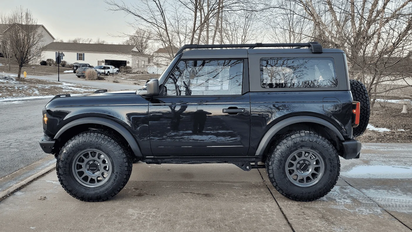

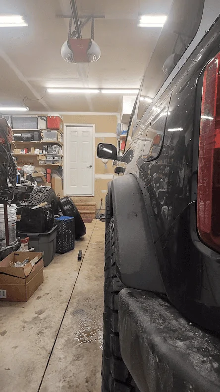

Here's my stance and poke :
Method 703's, 17 x 8.5 +35mm
35 x 11.5 - 17 Toyo (34.6")
no lift, no rub on the street ... no crash bars.
